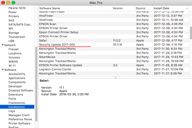

2018-002 definitely breaks your El Cap Install. Also app store no longer offers the working 2017-001/005 security updates after fresh 10.11.6 install, You need to download packages from apple website.

You can get the 2017-005 Security Update from the support downloads section. Remember the method before the App Store ;)!
https://support.apple.com/en_GB/downloads/Security
