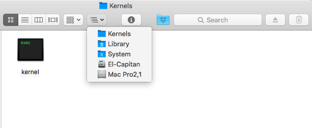

Any instruction on how to find the kernel? (it seems hidden in my system). Thanks Aaron
The kernel is found in your System/Library/Kernels Folder....
On my system it is the only file located there.

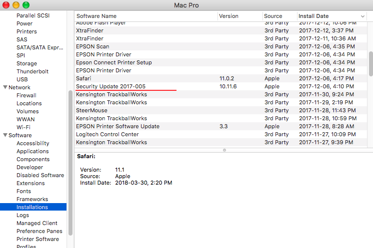

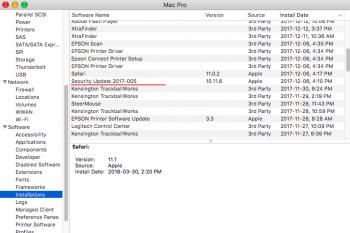

About This Mac->Installations can tell you what kernel you have installed.
