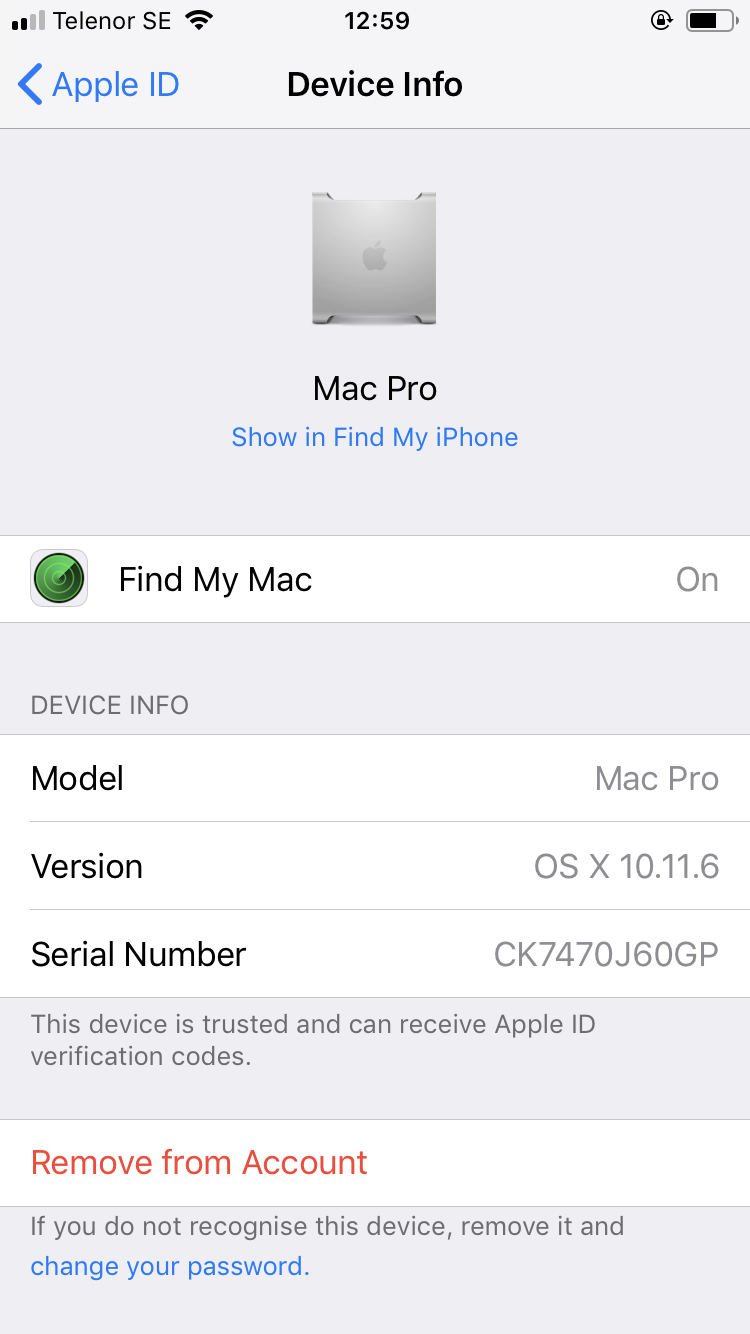

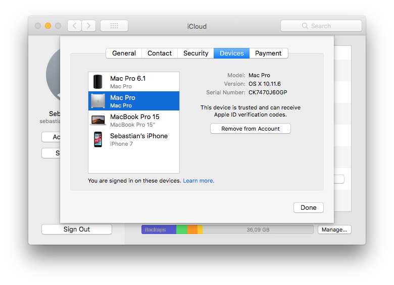

I didn't see any mentions of devices being trusted or not, it simply listed which devices I have.
It says so under the Serial Number if you go to the ICloud pane (Account Details, Devices) within System Preferences.

Just wanted to add, two factor authentication is working on the Mac Pro, I tested it when I logged into iCloud.com
Okay, that‘s good. In the iCloud pane when you click options behind the iCloud Drive, what did you check? I left everything empty now just for testing and it works. Stuff like shared desktop is not supported in 10.11. I think that started with Sierra or High Sierra.
