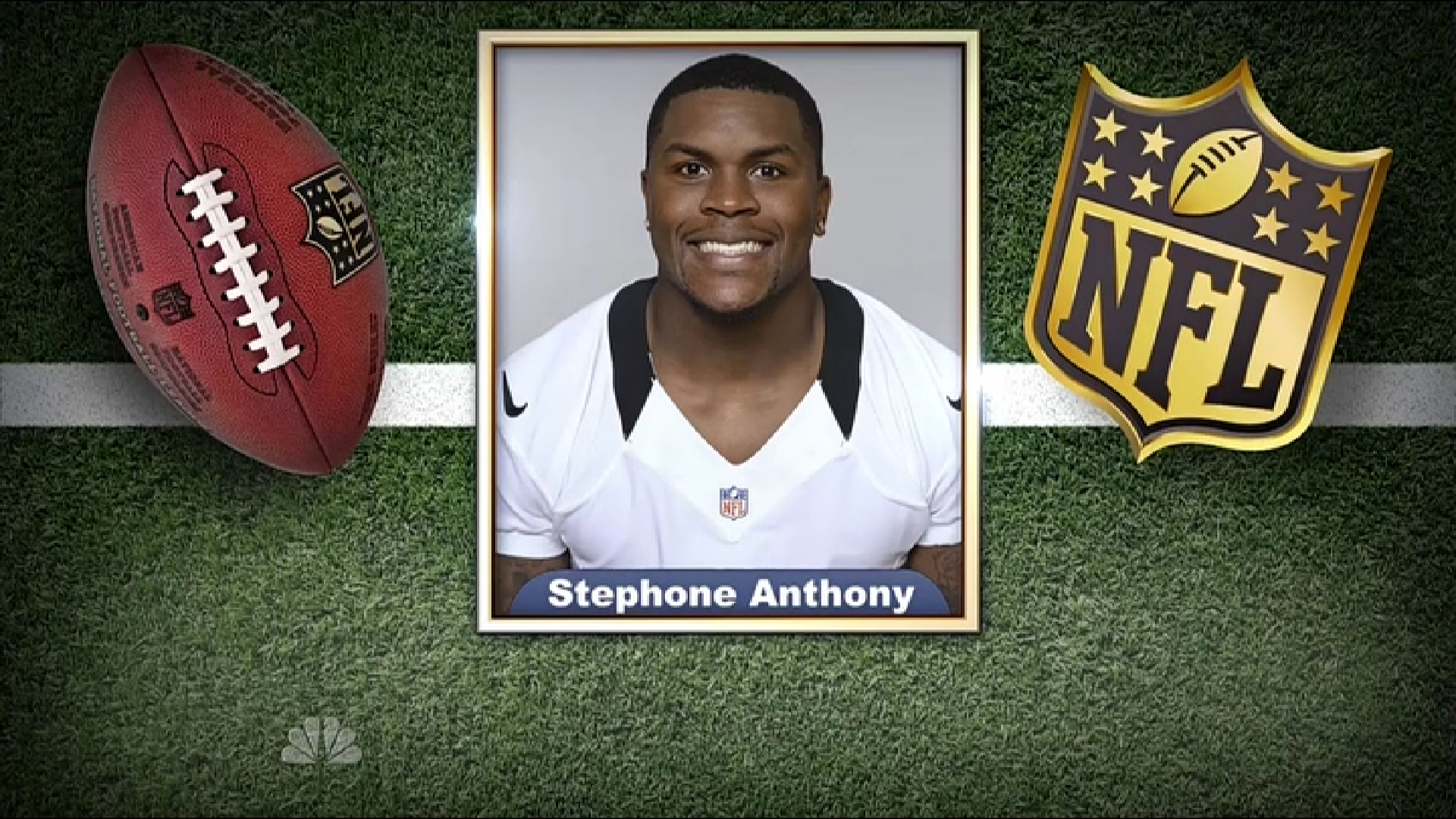

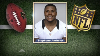

Hi! Thank you for your post.
One thing I have noticed: Video quality when playing an MP4 with my Radeon 5770 is now slightly worse than before. I wanted to buy a used 7970 anyway, so I guess I'll do that now.
Also thank you for the Recovery Partition advice. May I ask what "Mac Pro section" you are referring to? I have read literally hundreds of posts the last 48 hrs, so I can't quite remember where I read what. Kindly point me to it.
Thanks again!
What do you mean? worse how?
I'm watching a 720p mp4 file right now and the edges of faces or clothes are now slightly fringed. It wasn't like that in Yosemite. I'm pretty sure, because I noticed it right away.
EDIT: I just found that it's a video player issue. MplayerX now fringes edges, VLC does not. That was definitely not the case with Yosemite. Might have to look for a new vid player, always used mplayerX, never liked VLC.
You can see it quite clearly when you look at the collar and the NFL Logo.
