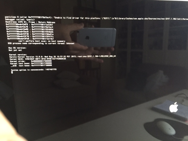

jt_69.V
macrumors newbie
Oct 11, 2015
26
7
France
I did a clean install and now have a different type of KP (see image).
Note that this KP does not happen everytime. After one or two reboots, or sometimes on the first try El Capitan starts and seems to run smoothly.
Any idea ?
Thanks
Any idea ?
Thanks
I think it's a USB device. Try to boot 3-4 times with nothing else plugged on USB except Mouse/Keyboard. I had this kind ok KP when I forgot plugged the monitor's USB upstream cable connected with the old NEC based PCIe USB 3.0 card. I bought an Inateck KT4004 and since then, no KP with the plug connected.
I hope this helps.
Thanks, but the KP happens even with nothing connected to USB ports.

I found the culprit: an ORICO PFU3-2P USB 3.0 PCI-e card. After removing it, KP disappeared and (icing on the cake) it also solved my problems with a Logitech Anywhere MX mouse that was completely unusable after El Capitan upgrade (no scroll and jerky movements). I just hope ORICO will be able to fix the problem, as I was quite happy with the USB 3 ports of this card.
