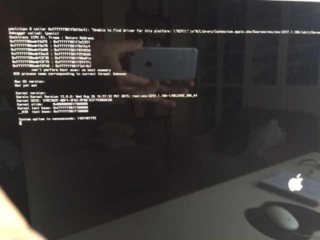

I follow the instructions on post ·585, on an external HD.
El Capitan boots fine and all seems to work. Then I make a carbon copy clone on the Macintosh HD (I have Yosemite on other partition) but when boots occurs that:
Any help ? I tried boot.efi attached on post @585 and from http://piker-alpha.github.io/macosxbootloader/
I have a MacPro 1,1 with ATI Radeon HD 5770 1024 MB
Thanks in advance
(Sorry about my english)
I get exactly the same KP on my machine (same setup as above). Tried all the boot.efi versions available, can anyone explain what the problem is?
It can't find the prelinkedkernel, and the version that you are using does not have the kernel patching routine that I have written to overcome this issue. New update will soon be made available.
Here's a verbose/debug version to try: boot 0e193cd3c15a599cfab687bbdab4bdded2e2fad4.zip
Nobody else should use this version!
