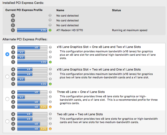

For those of you who miss the quietness of you MP before running more powerful GPU's I recommend checking out the Arctic Accelero S3. Its a passive cooler that works with a lot of cards.
I have used it with my ATI 5770 for about a year with 0 issues. I bumped the I/O fan up to 750rpm and the heatsink is never more than lukewarm. The temp of the HD directly above the GPU increased from 80F to 90F which is perfectly acceptable.
Only caveat is you will have to move your GPU to slot #2 which has a slower speed, but based on data i've seen the performance drop is around 1%
