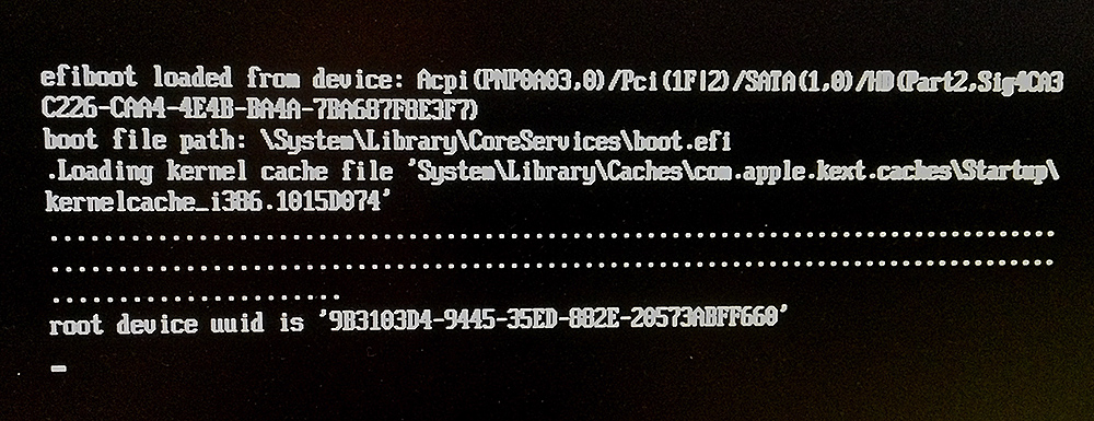

When I try it in verbose mode I get a few lines suggesting the efi has booted but nothing more (see attached).

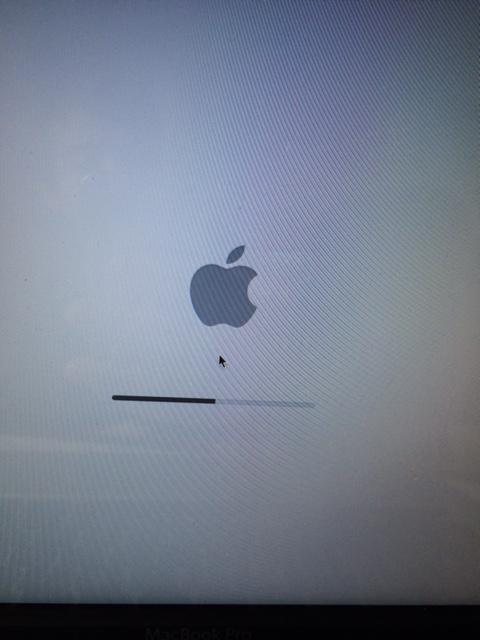

That progress bar is supposed to be there; replaces the spinning wheel from previous versions of OS X. It is part of Yosemite.

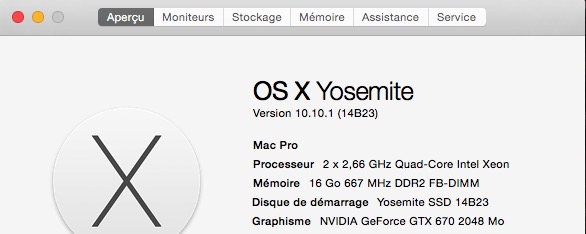

Installed 10.10.1 14B23 update.
