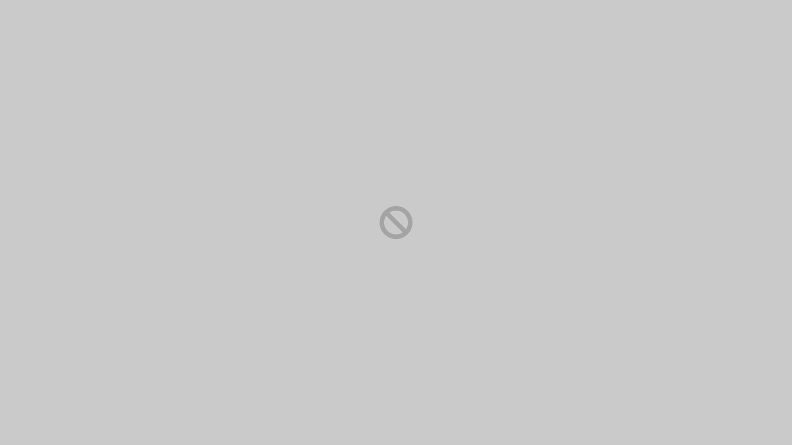

I did all that. This what is happening sorry for the orientation uploaded from my iPhone.
Hey Checkmate2006. I'm struggling with the exact same problem as you had with reaching about 15min remaining, and then this same error message. How did you end up getting past this?
Ive tried redownloading the Installer, recreating the Installer multiple times, following every step meticulously, tried multiple USB keys, nada. Same thing. And I get stuck using that downloaded pre-cooked image because the download site errors-out or gives me an invalid zip file on the rare occasion when it does work. Lastly, I tried using SFOTT on the Installer and it stops once the display comes up and says it cant install because Yosemite is already on the box. Then I tried manually apply the board-ID in the steps in the guide on that SFOTT key, and it actually runs alittle bit further, but gets stuck at an Unspecified Error: 0 on the Installer.
So now, I'm hoping someone can upload a pre-cooked installer image to another site other than copy.com like mega.co.nz and then maybe that might work. But other than that, I think I've exhausted everything that I can. I cant get this thing to install without erroring out as it is. Any help from anyone would be great! Thanks
2006/2007 Mac Pro (1,1/2,1) and OS X Yosemite

Success using external HD install method!
Hi all,
I'm happy to report that I successfully installed and am running Yosemite on my MacPro1,1 with an unflashed HD5770! Booyaka!
You might have read above but I had absolutely no success with either the guide, with downloading the pre-cooked image, or trying to apply SFOTT on the installer. Only the last option worked. What I ended up doing was pulling my drive out into a USB external drive sled and did the install using a Yosemite capable MBA.
After trying ALL of the methods, I have to say that this is by far the easiest and cleanest. In case this is helpful for others, here's the steps I took to get it working:
  1. Pull the target drive out of your Mac Pro and insert into a USB external drive caddy and follow this guide to both format and install Yosemite onto the target drive using a Yosemite capable Mac
  2. Once the install is complete, the system will reboot and boot up from the target drive. Select your language and keyboard and connect to WIFI and your Apple ID and finish the setup wizard until you get to Yosemite Desktop
  3. Once booted up on the Yosemite Desktop on the Press CMD-Space to pull up the spotlight search and type "terminal" and ENTER
  4. type "sudo bash" ENTER
    and enter your admin password
  5. cd /System/Library/CoreServices
  6. chflags nouchg boot.efi
  7. cp "/Volumes/original disk/Users/username/Desktop/boot.efi" .
  8. chflags uchg boot.efi
  9. cd /usr/standalone/i386
  10. chflags nouchg boot.efi
  11. cp "/Volumes/original disk/Users/username/Desktop/boot.efi" .
  12. chflags nouchg boot.efi
  13. exit
  14. Shutdown the mac, remove drive and insert back into your Mac Pro and powerup and wait for Yosemite to boot up. And bam!
I stored the modded 32bit boot.efi on the desktop of the yosemite capable MBA which I ran the installer from. If you are doing the same, replace the BOLDED original disk and username in the commands above with the name of the Volume and Username of yours.
Also, after rebooting the Yosemite capable system, the installer will launch again. If you don't want to put Yosemite on the system, just go to the Menu Bar and select the Installer dropdown and Quit Yosemite Installer. Then select Startup Disk. And reselect the original disk and restart. Then you will boot up like normal.
I wanna give a huge heartfelt thanks to Hennesie2000 for trying to help me through this process. It is interesting that I was able to install this way using the same Installer image that I got from the AppStore that I was using to try to build the keys. The guide might need revisions because something might have changed? Anyway, thanks to everyone for all their work in keeping our MacPros a little less obsolete. Hopefully, I can get another 3-4 years of life out of this baby. Vielen herzlichen dank!

Nothing has changed where the guide needs to be modified. I promise you this. The fact that you were able to boot and begin the install process shows the guide works. If the guide didn't work you wouldn't be able to boot or even begin installing. More than likely the problem lies with your usb stick. Also the method you ended up doing has been posted many times in this thread as an option.
It could very well be a hardware issue with my usbkeys (plural). But, I'm happy that this method works. In the least, this method was not documented previously so I hope that helps. It might be an alternative for people that don't have available usbkeys or perhaps just bad ones like me? In the end, it was a very easy install. Thanks again Hennesie2000 for helping me through this. You were always responsive and helpful, and I really appreciate that! Best.
