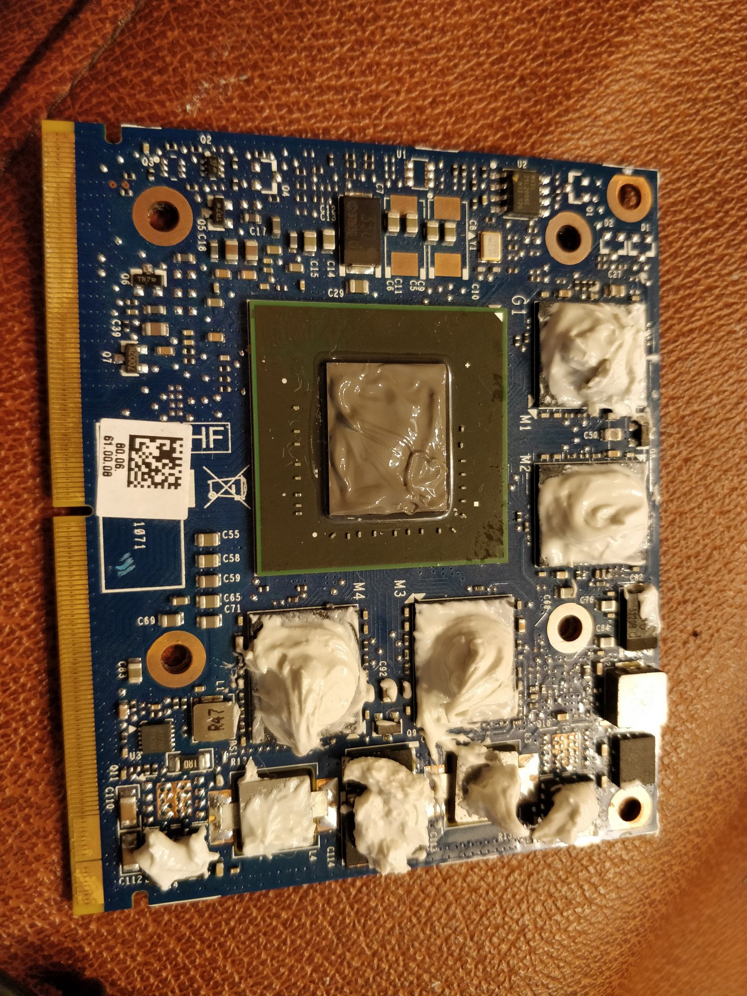

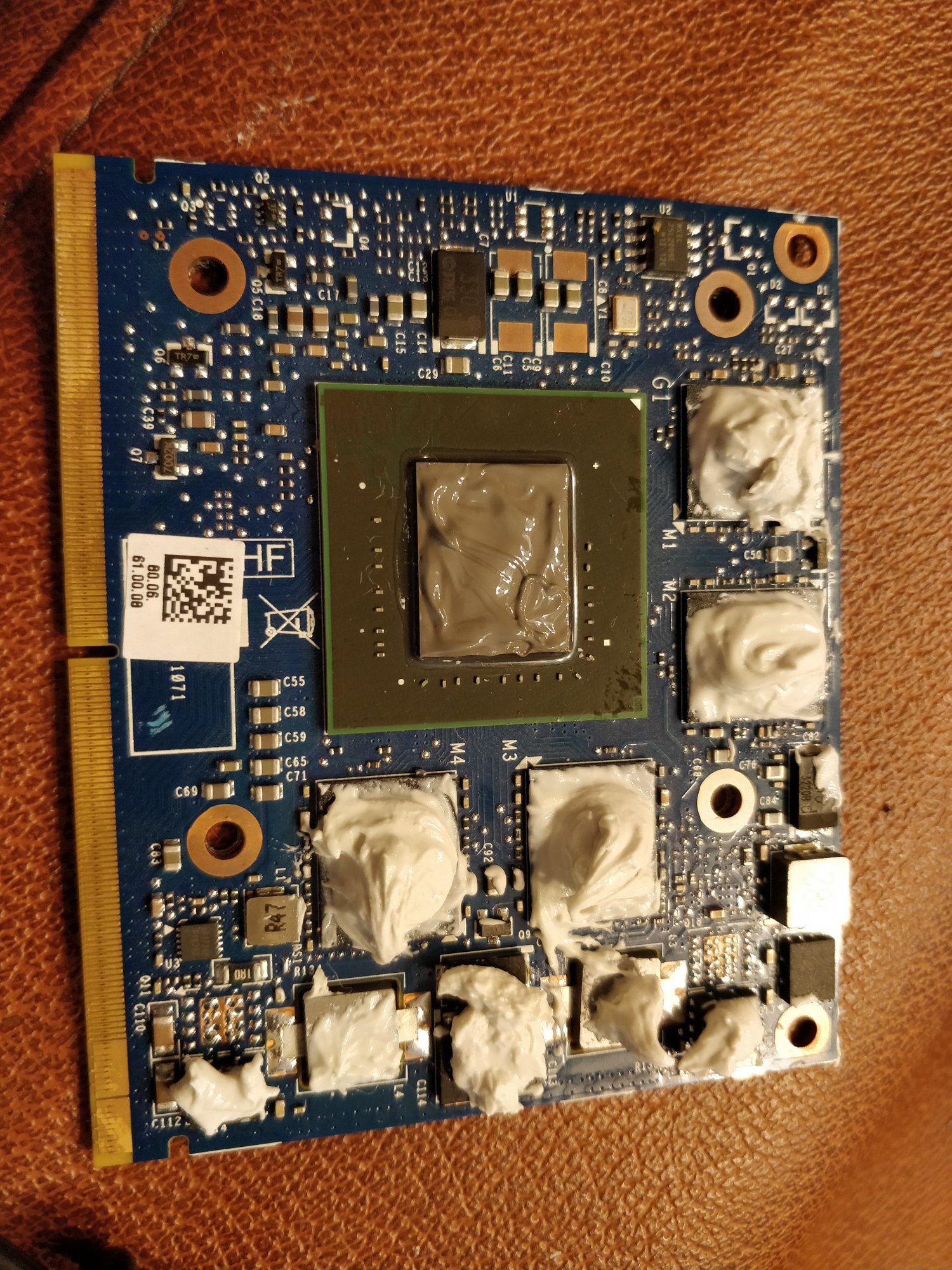

May I ask how your K2100m is nearly dead? I have 3 of them now and I find them excellent for a 6770m/6750m replacement. If you think you are only finding expensive results here is the listing I have bought mine from K2100m eBay
Oh, I see now, artifacting and screen blanking out, here is how I do up my k2100m with k5 pro, hope is just a fluke.
I did mine with exactly the same Paste. Im sticking with the k2000m i think. I dont want to Order another Card.

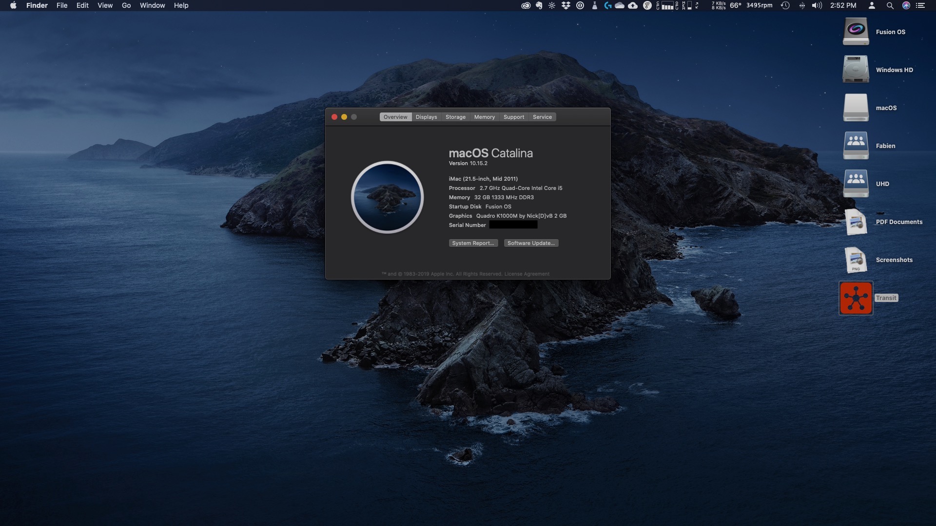

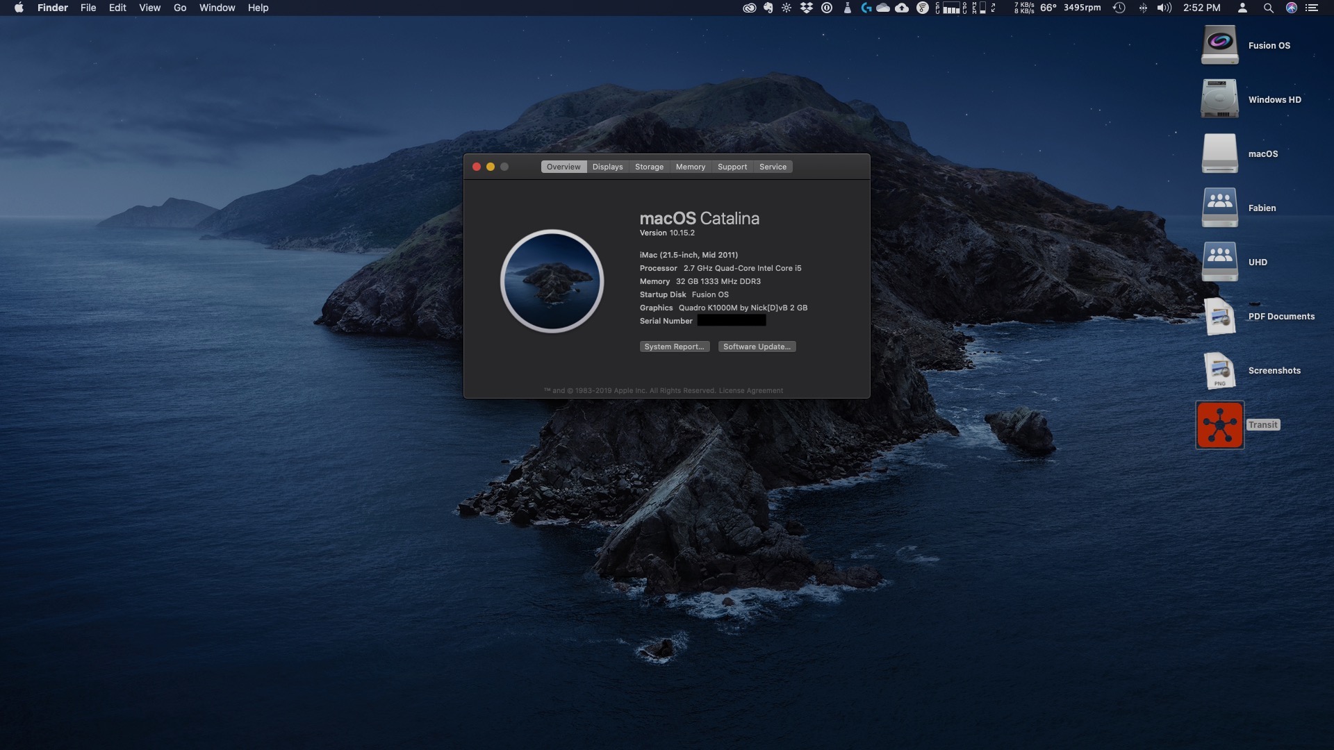

Hello Everyone,
Thank you for sharing your experiences.

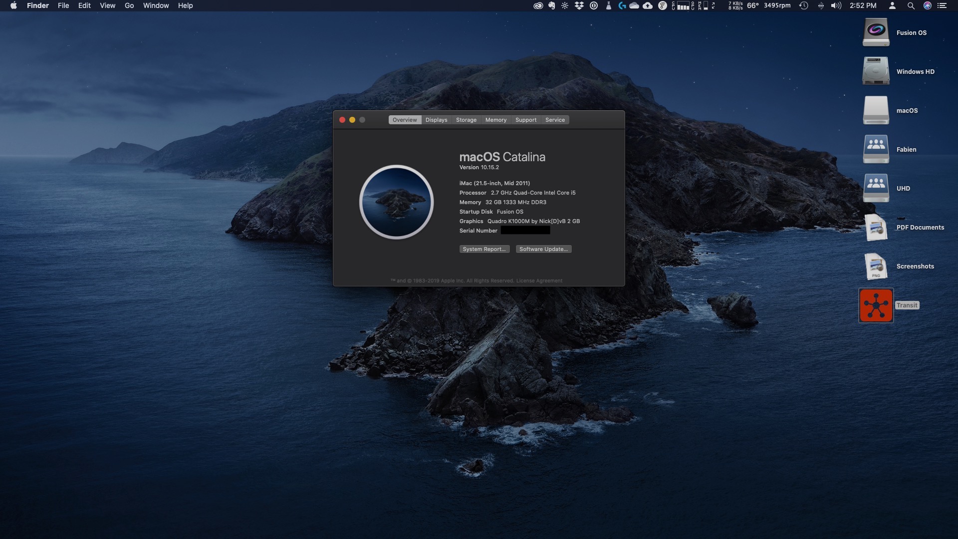

I managed to upgrade my iMac 21.5" Mid-2011 from the AMD 6770 to a Quadro K1000M I had the chance to salvage from a busted DELL Precision 4700 workstation laptop.
Replacement process
The replacement was pretty smooth. I removed the old AMD and swap it with the Quadro.
The DELL Quadro had the X-clamp glued on the PCB so I heated it up and pried it out.
Used the original stock X-clamp from the AMD's iMac and it worked just fine.
After re-assembly, I landed on the macOS login screen.
I used my Windows 10 BOOTCAMP partition to flash Nick's beta 3 VBIOS via NVFlash and that went well. I got the boot screen back.
Then went into recovery to disable SIP and upgraded to Catalina 10.15.2 using the Dosdude upgrader.
  • I checked and system information shows my GPU as metal supported.
  • Another big deal for me is smoother HEVC decoding which the old GPU wasn't supporting. This is great.
  • I can also use newer versions of Pages and Keynotes as the latest version on High Sierra can't keep up with the latest one on Catalina I am running on my laptop.
  • I used the app from the AppStore to get some brightness control.

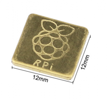

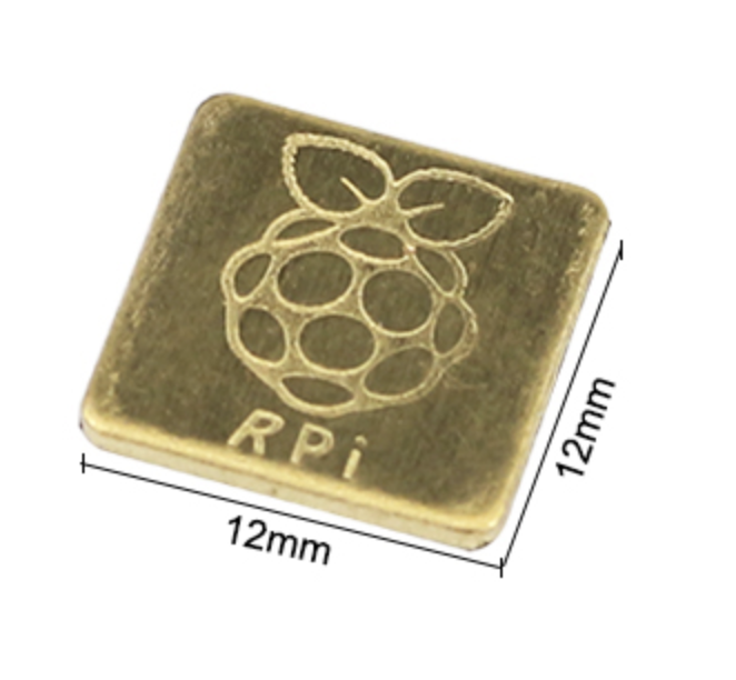

Did anyone figured, on the 21.5" how to keep the VRAM at the back of the GPU board cooled?
I saw some people installing a custom air duck from the HDD Fan but that won't work with the 21.5".
I am thinking of putting small flat heatsink, similar to these Raspberry Pi Ram coolers.
Any experiences around?
