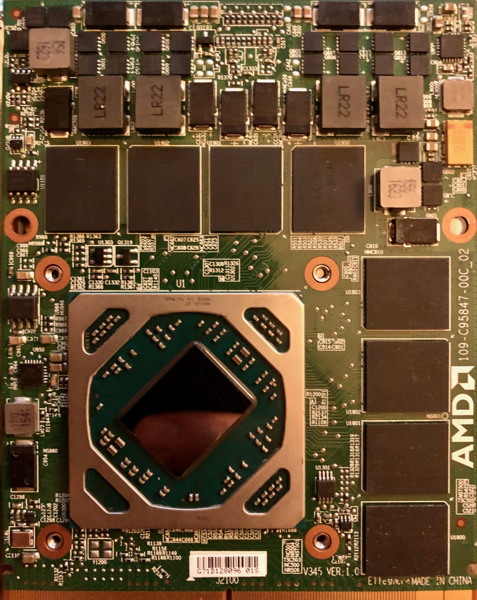

What seems to be a clue for a card to be a Radeon pro WX7100 is the presence of some yellow chips and sometime "ellesmere" written on the PCB.

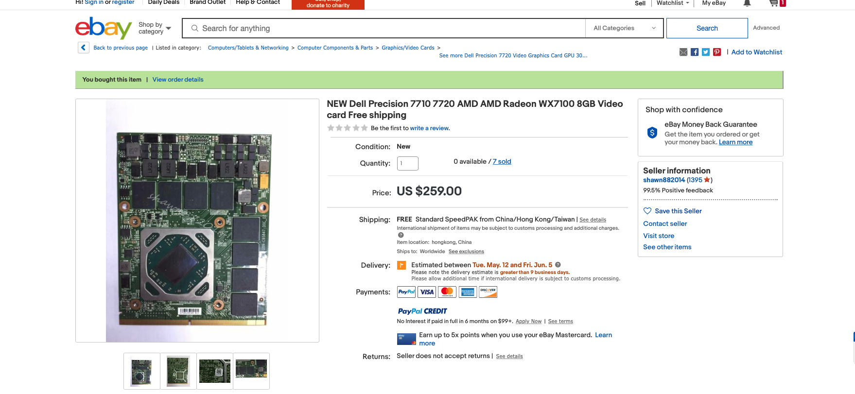

Well I am still waiting on my card to arrive, should be here the April 30th or by may 1st.
the picture I have from Ebay shows the number o be a 109-C95847-00C-02
I am hoping that I didn't get the wrong one and switched from the picture either, and my purchase was for a New WX7100 as well from a different seller than listed from the users who was the wrong one.
I will let you know what happens when I get it and will see if I need more help or will be sending it back.

This is the card I purchased and what I am expecting to get, I took the picture to see the number in the top corner hopefully that will help and let me know if im getting the wrong one??
It should be a WX7100 for Dell Laptop.
"MPN: 308VY"
"For Dell Precision 7710 7720"
I know, you linked to that before. Thanks
But that is showing a 00B card. Not saying that this seller is sending you probably a C card instead.
With Ellesmere
Like DES Global.
They show a 00C card.
But I got a private message that they sell the 00D card. With pictures
It's all so confusing with alie sellers
"MPN: 308VY"
Thats perfect, that is the exact brand I picked up from the guy on eBay, and he confirmed with me that the the card is 109-C95847-00C-02 that is for the dell precision 7710 & 7720 they will be shipping it to me in 8-12 days, so I await patiently and will prepare my iMac now to have bootcamp windows 7 installed and will put in all the leg work needed before card gets here so I can make the install boot in and flash in windows then restart and hopefully have a fully working Catalina with the WX7100 card.
Did he confirmed too that a WX7100 (Ellesmere, Polaris)?
