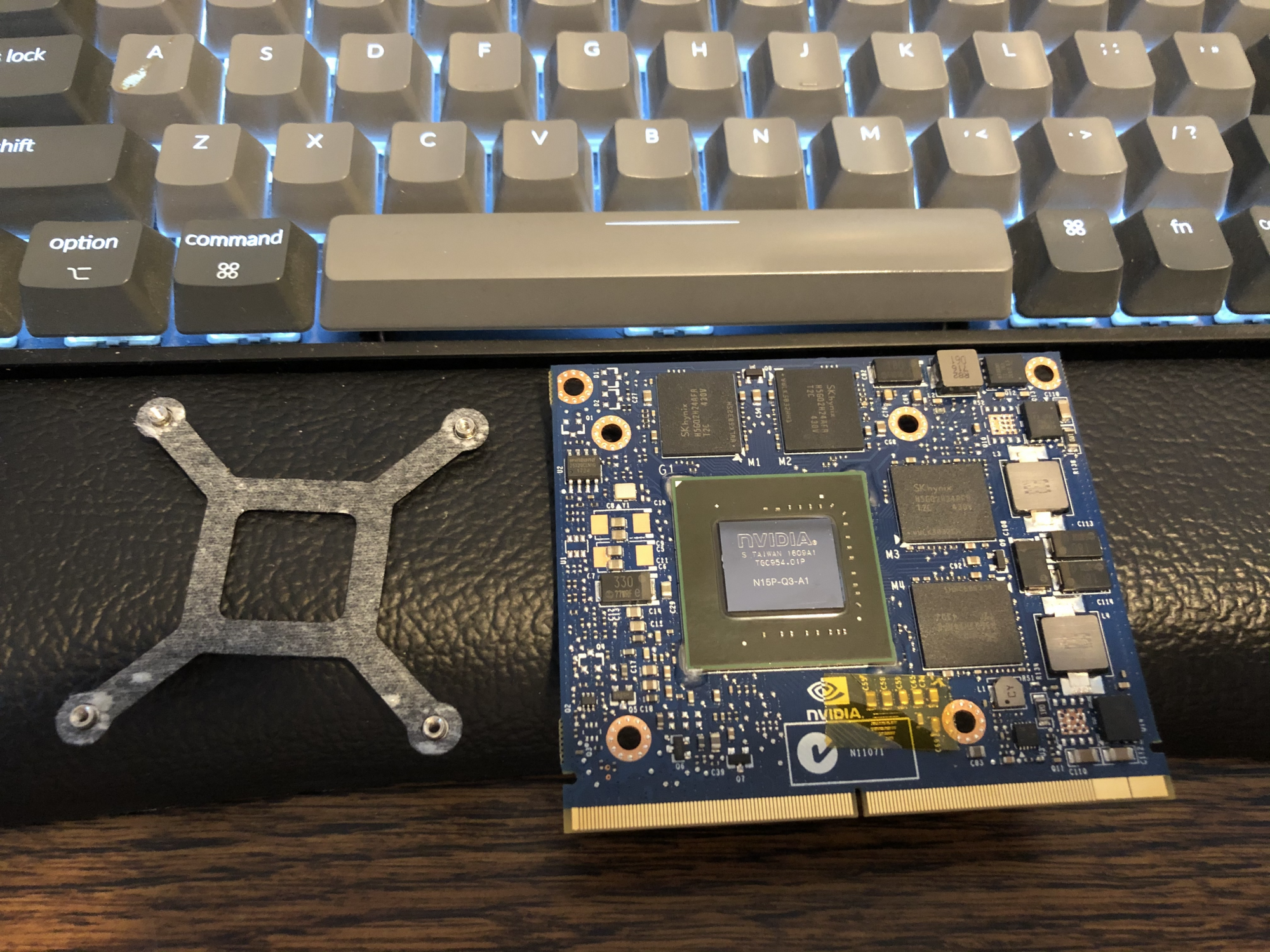

Did you try flashing the VBIOS with this method?
I have not, i thought flashing the EEPROM directly would be sufficient. Looking at the hex of the rom file it doesn't look like there is any headers or anything that would be processed by a flashing utility. Looks like 256k binary meant for a 256k eeprom.
Happy to give it a try of course.

Just got my Nvidia Quadro K2100M delivered. Can't wait for the weekend to arrive... IMG_1917.png
X-Clamp was way easier to remove than I first thought. Hope the same experience awaits me when I try to remove the x-Clamp from the stock card...

Just got my Nvidia Quadro K2100M delivered. Can't wait for the weekend to arrive...View attachment 967493
It took me a while to realise I had to remove the X-Clamp from mine... But the clamp in the stock card is not glued, only screwed to the heatsink, so you shouldn't have problems there!
