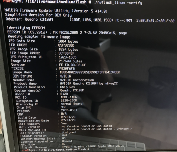

iMac 2011 latest 87.0.0.0.0 with K3100M flashed with linux to Nickys bios. that worked, but now I get a black screen and 3-4 chimes that are partially cut off. all 4 LEDs are green and on with LCD installed.
any ideas? pram reset isn't doing the trick.
fixed it: always check if your X-Clamp is not touching anything! I used the AMD clamp on 770, 2000, 2100, 4100, etc without any problems at all! but there is no guaranty that it will work forever. So K3100M is not liking the AMD Clamp, it wants its own Nvidia Clamp.
but still next problem: no load to the macOS installer. white screen freeze (?). I see the boot loader, I see cmd+v terminal during load, I tried high Sierra and Catalina but still, both are stuck after initial load and I can't enter macOS installation.
another test: inserted a clean ssd with 10.13.6 and it see the loading, but as soon as its done > internal white screen and external screen is also not getting any signal.
whatever I try right now: as soon as the driver are loaded the screen goes white. dead card?
rebooting to linux usb drive, I get the following informations: any ideas? bios bugged or card dead? my iMac is standing aside and its awaiting your insights and instructions 😉

Had two cards (broken) acting exactly like this. To cross check it the BIOS may cause the issue use the DELL BIOS I linked here somewhere in the past.
If you get the same behavior with another BIOS while booting into a MacOS version I would agree on the fact that your card is dead.

card is alive and rockin 😀 y? because @nikey22 is a damn wizard. that's y. restoring Time Machine on a fresh Catalina dosdude installation.
@xanderon👍
The GDDR5 ram and generation die ("B") of your Hynix memory for that Clevo/Dell card is different than what the original Dell rom was built upon in my machine. Mine was older "A", yours is "B" based on the pictures you sent me.
I will be updating my K3100M post soon with the new information for everyone else. There seems to be 2 different memory types for these cards. Your problem was a great discovery!

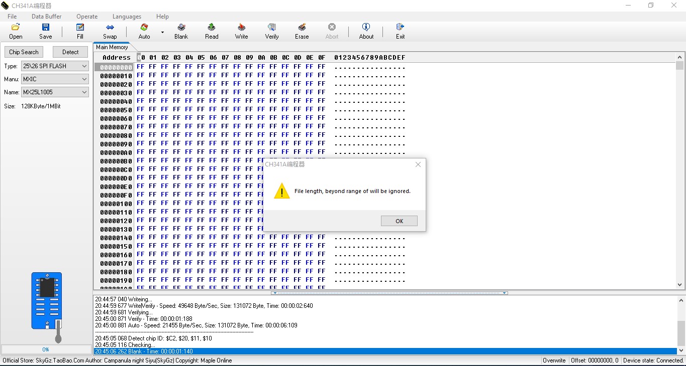

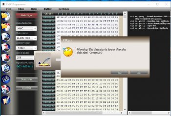

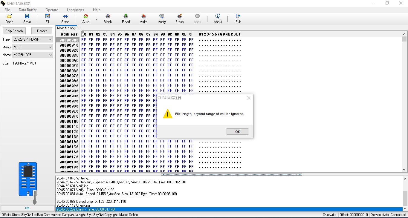

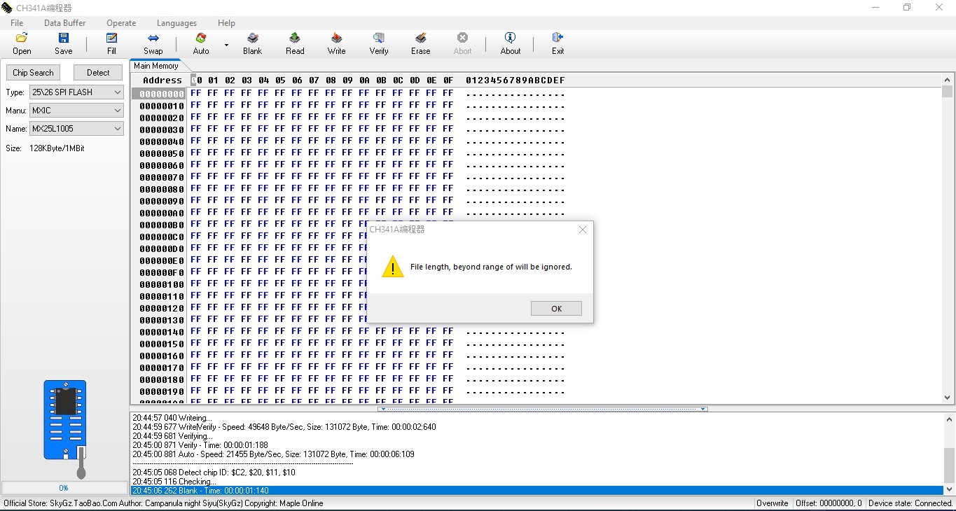

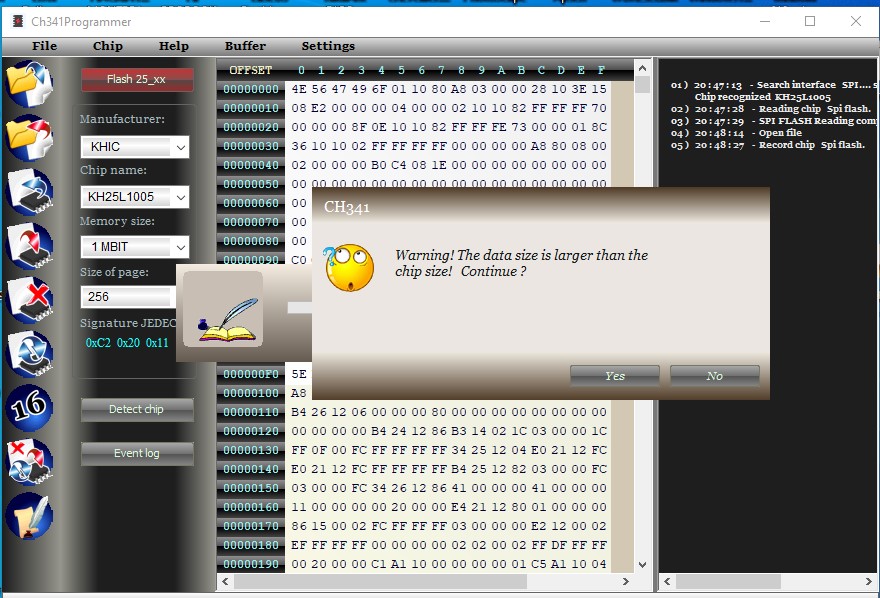

Ch431 Flashing Error on K2000M Graphics card ,used different version of Program same error, Erase completely, Auto Program option screen shot of error was attached.

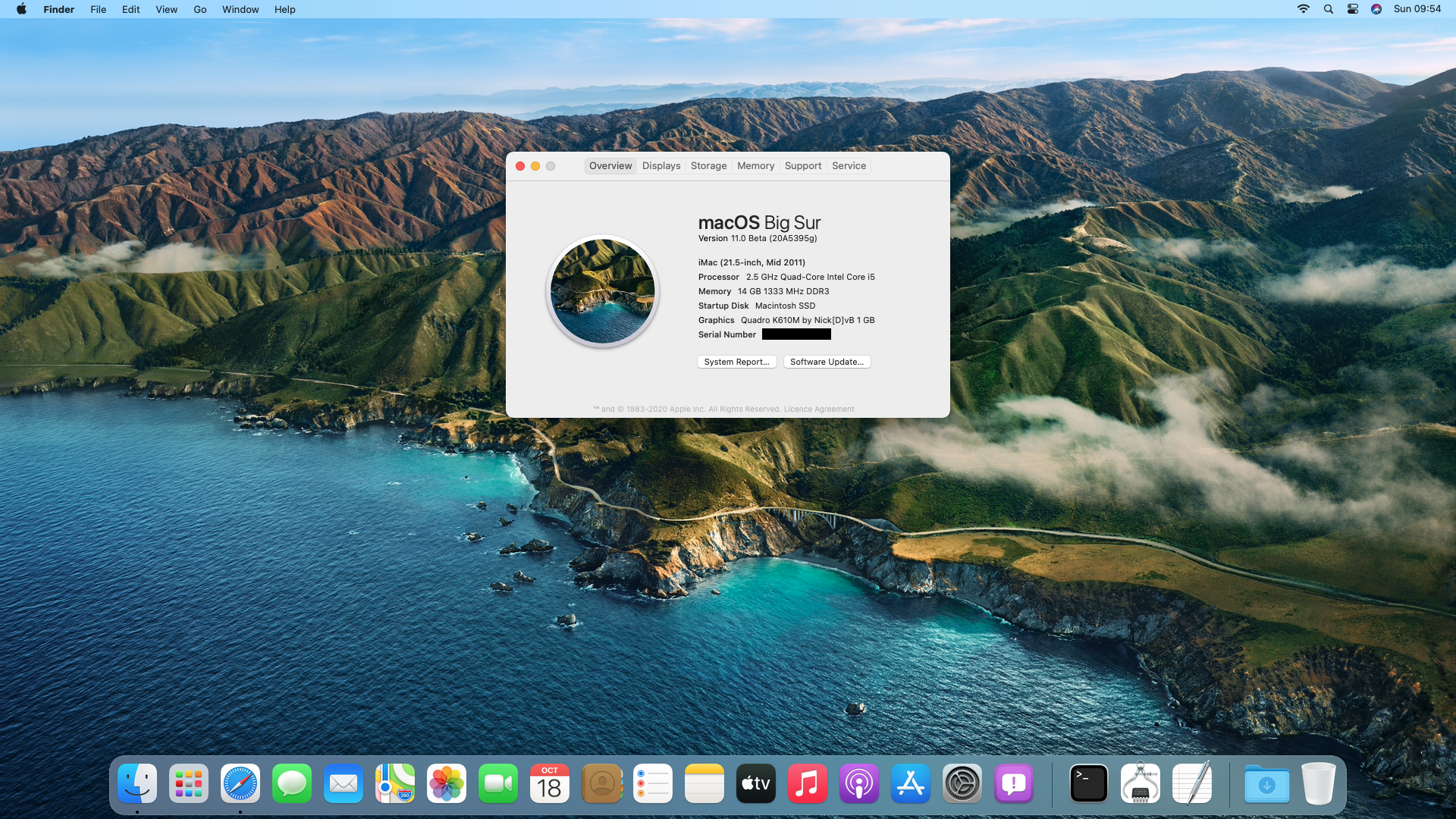

Hello just wanted to post my success, took me about a month of stress and hair pulling figuring out to get everything working, my setup is Mid 2011 21.5 iMac, 3.4GHz Intel Core i7 2600, 32GB RAM, dual SSD with dual boot OpenCore Windows 10 and Catalina, Video Card AMD Radeon Pro WX4150 detected as a 4GB Radeon RX 460 on both systems, brightness control working on both systems too, I couldn't be happier to take my old mac that I found on the trash to the highest level, thank you all for the help, time and money spent on this amazing matter, here are my pictures
Can you give some instructions about getting Catalina to detect WX4150 correctly?
Did you just make a clean install using USB installer created by dosdude1's patch, or did you have to manual patch any kext?
