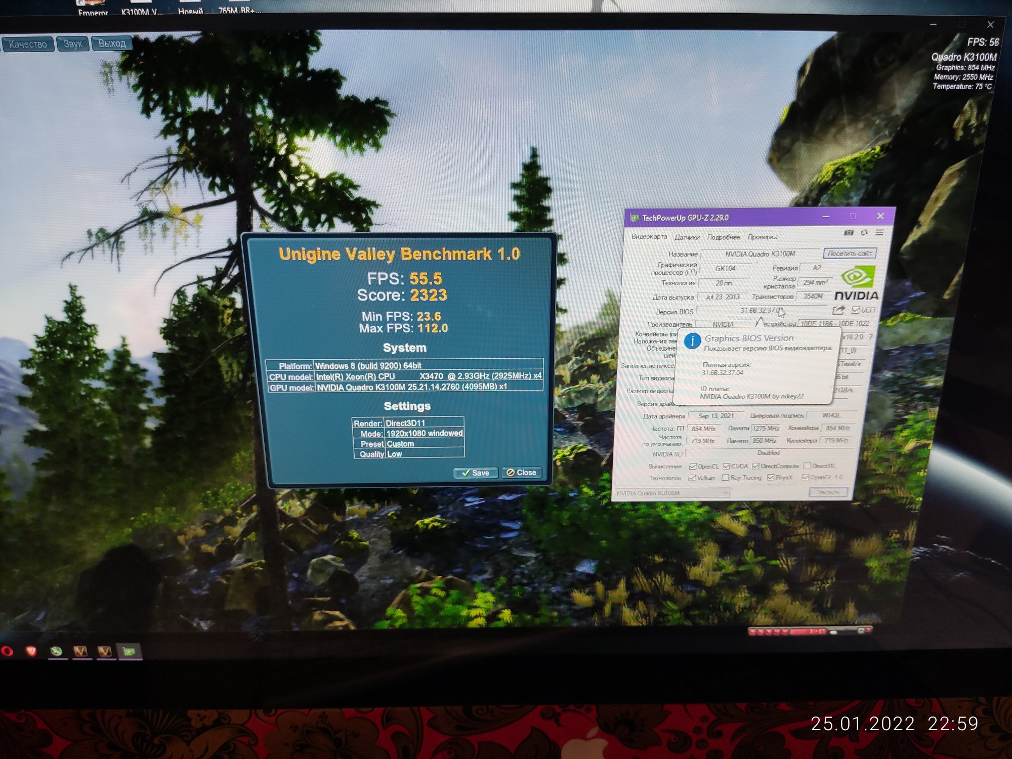

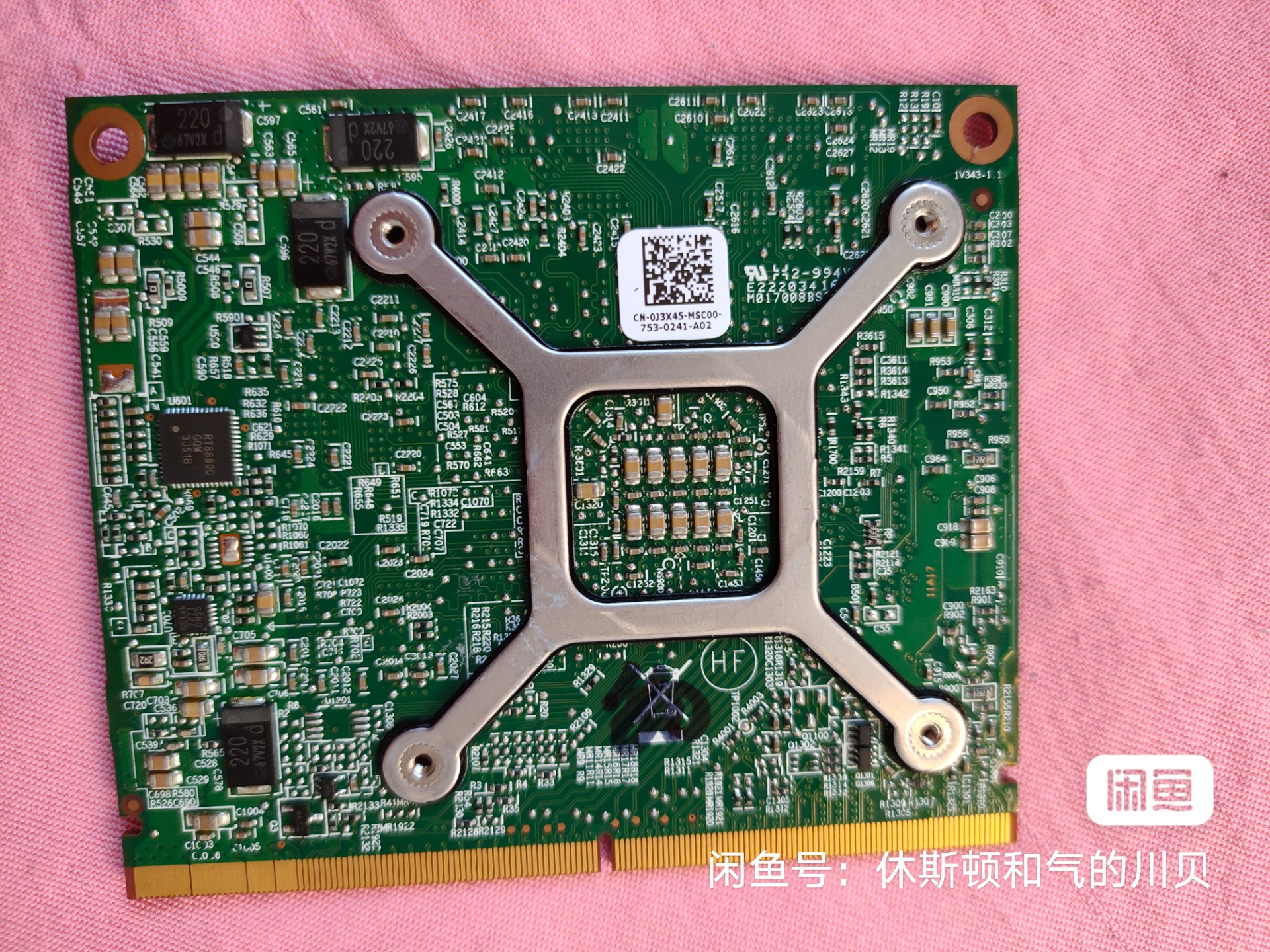

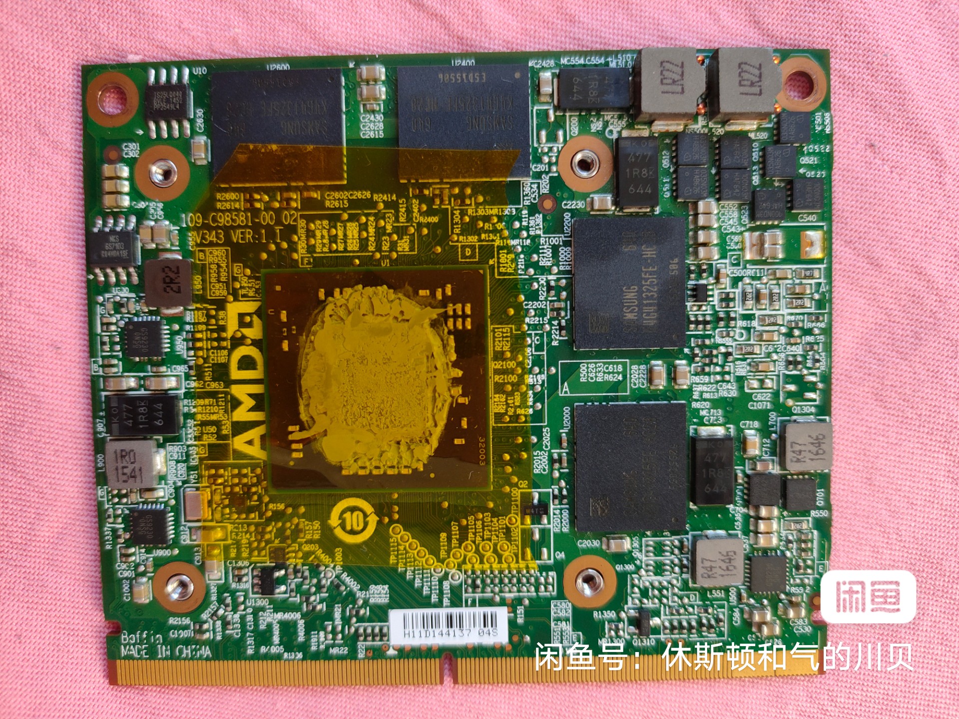

Hi all. Amd Radeon Pro WX 4130/50 will work with iMac 2011 12.2 27inch?
is it right?
