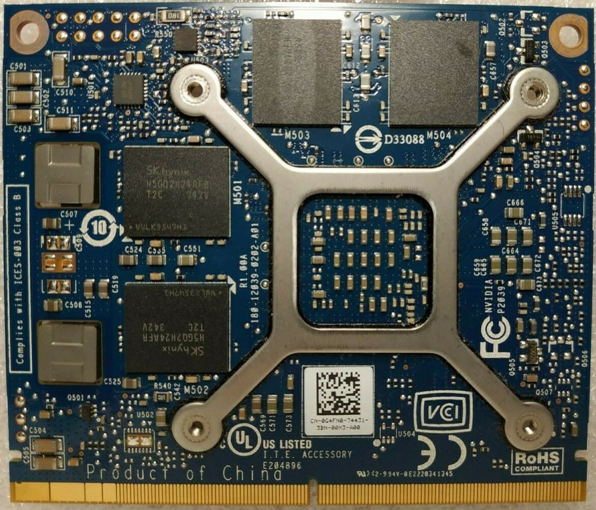

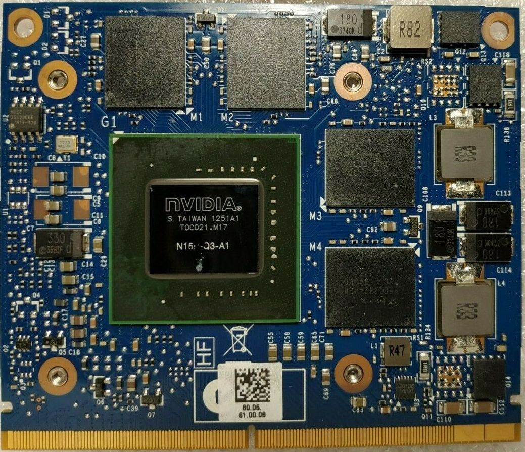

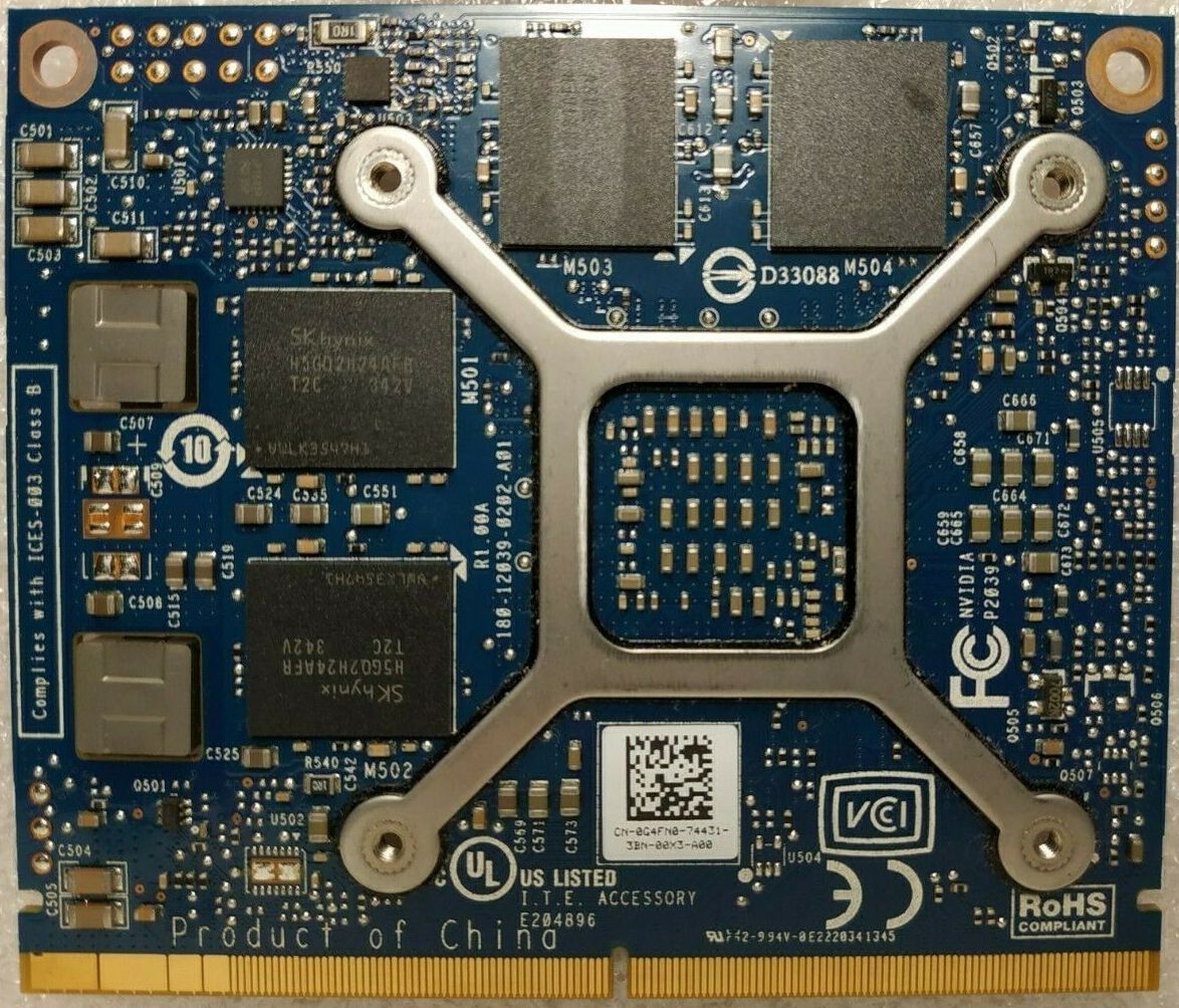

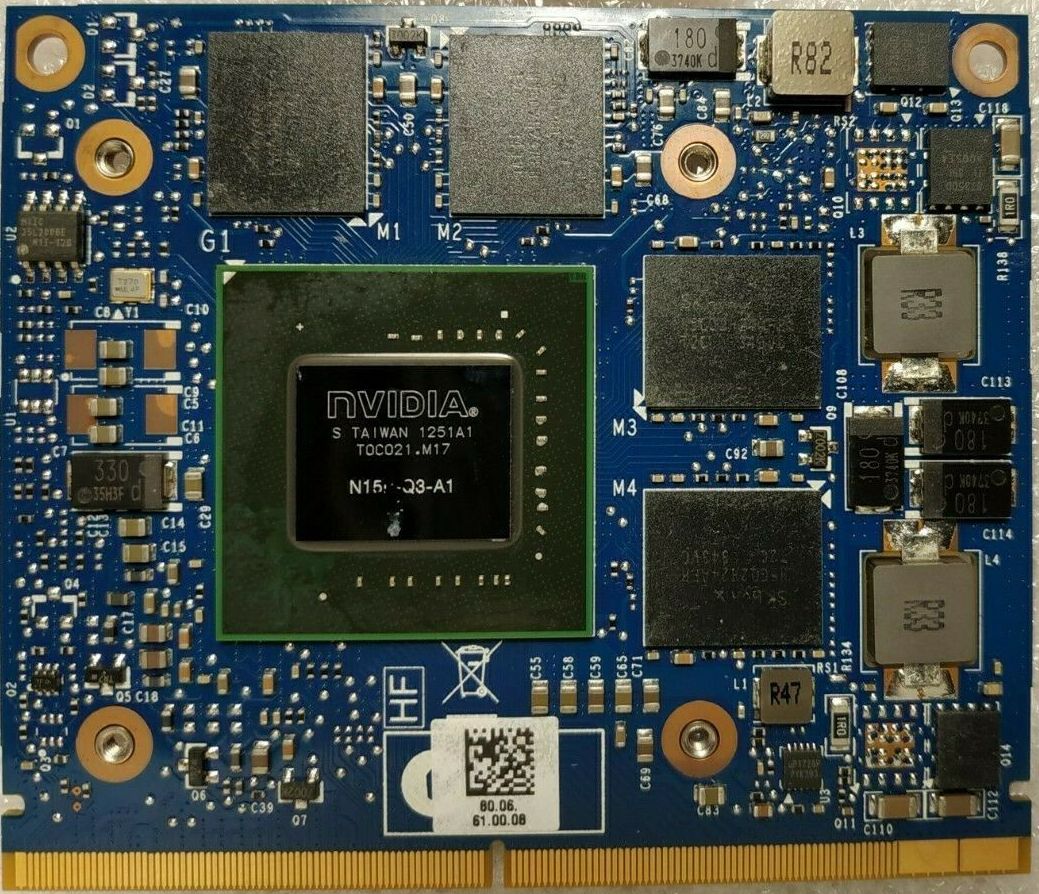

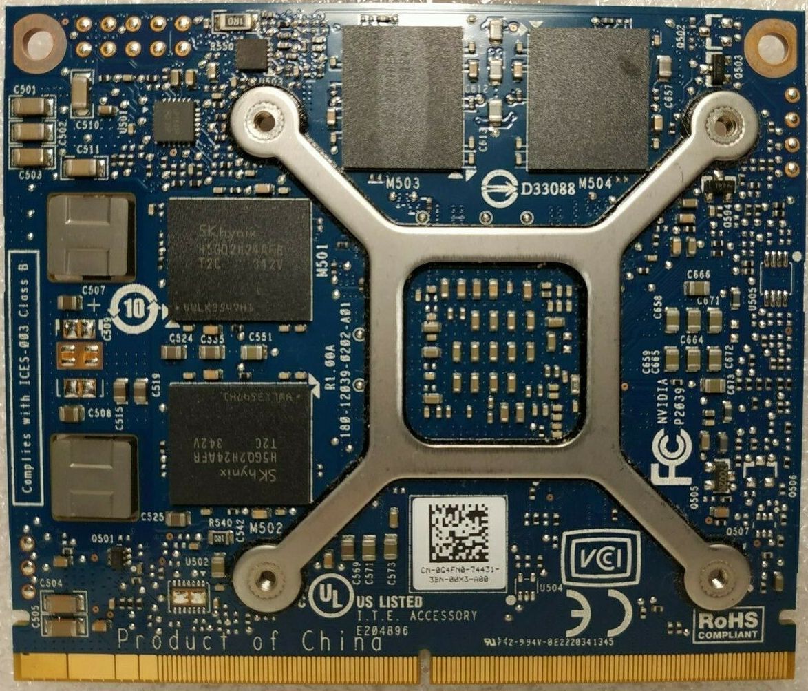

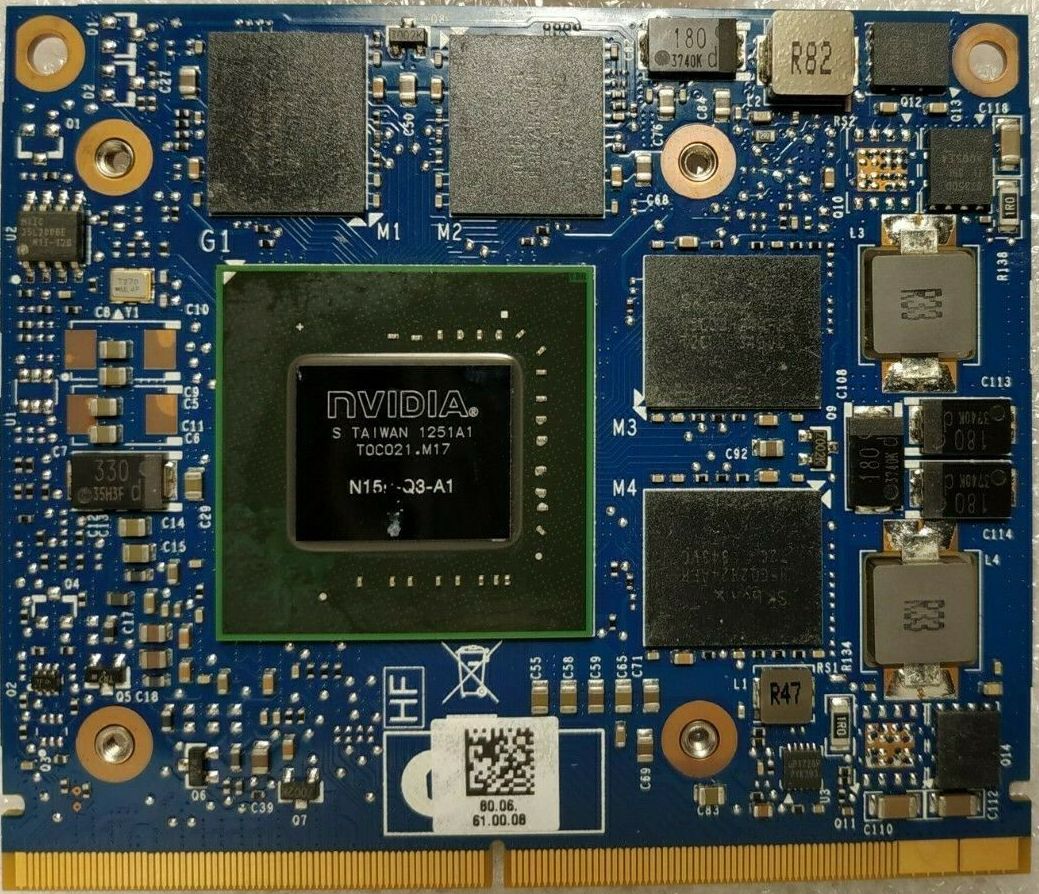

So, I ended up ordering the following card for my 2011 imac 21,5":
DELL M4700 M4800 M6700 NVIDIA QUADRO K2100M VIDEO CARD 2GB CN-0G4FN0 GENUINE
It should be ok, correct? Please see also the attached pics. It is from a Dell, it is an MXM-A type (so no heatsink mods) and it has metal support. The specs are: https://www.techpowerup.com/vgabios/163744/163744
The plan is to use it and update to Big Sur (since it still supports the Kepler drivers out of the box).
So, in what order should I go forward? The iMac now runs High Sierra. Should I:
1. Replace the card.
2. Flash the modded bios using xanderon's usb pen drive method (or dual boot windows method).
3. Install OCLP
4. Update to Big Sur.
Or should I update to Big Sur first using OCLP and then replace the GPU and flash the modded bios ?
Many thanks for your kind suggestions.
