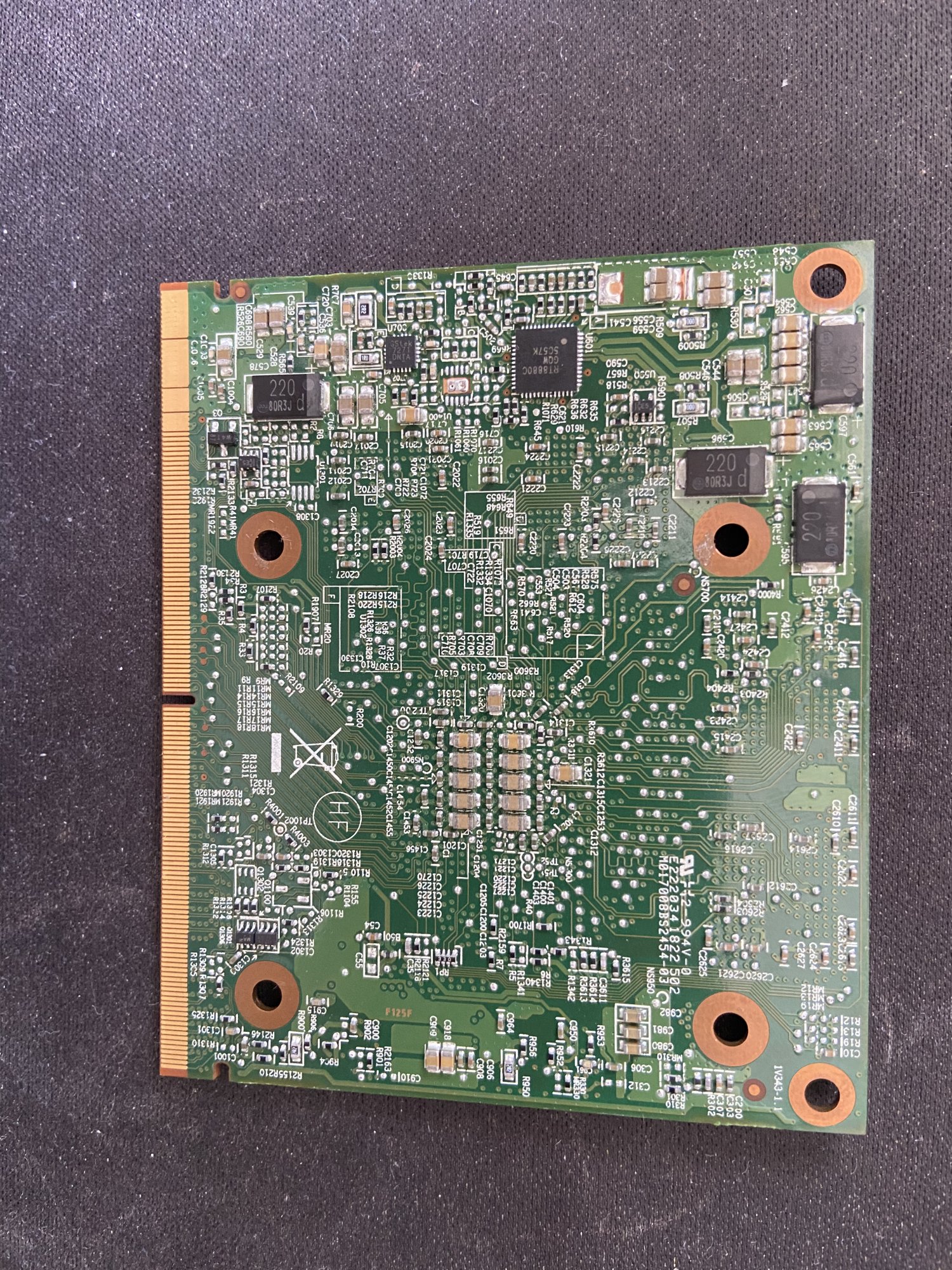

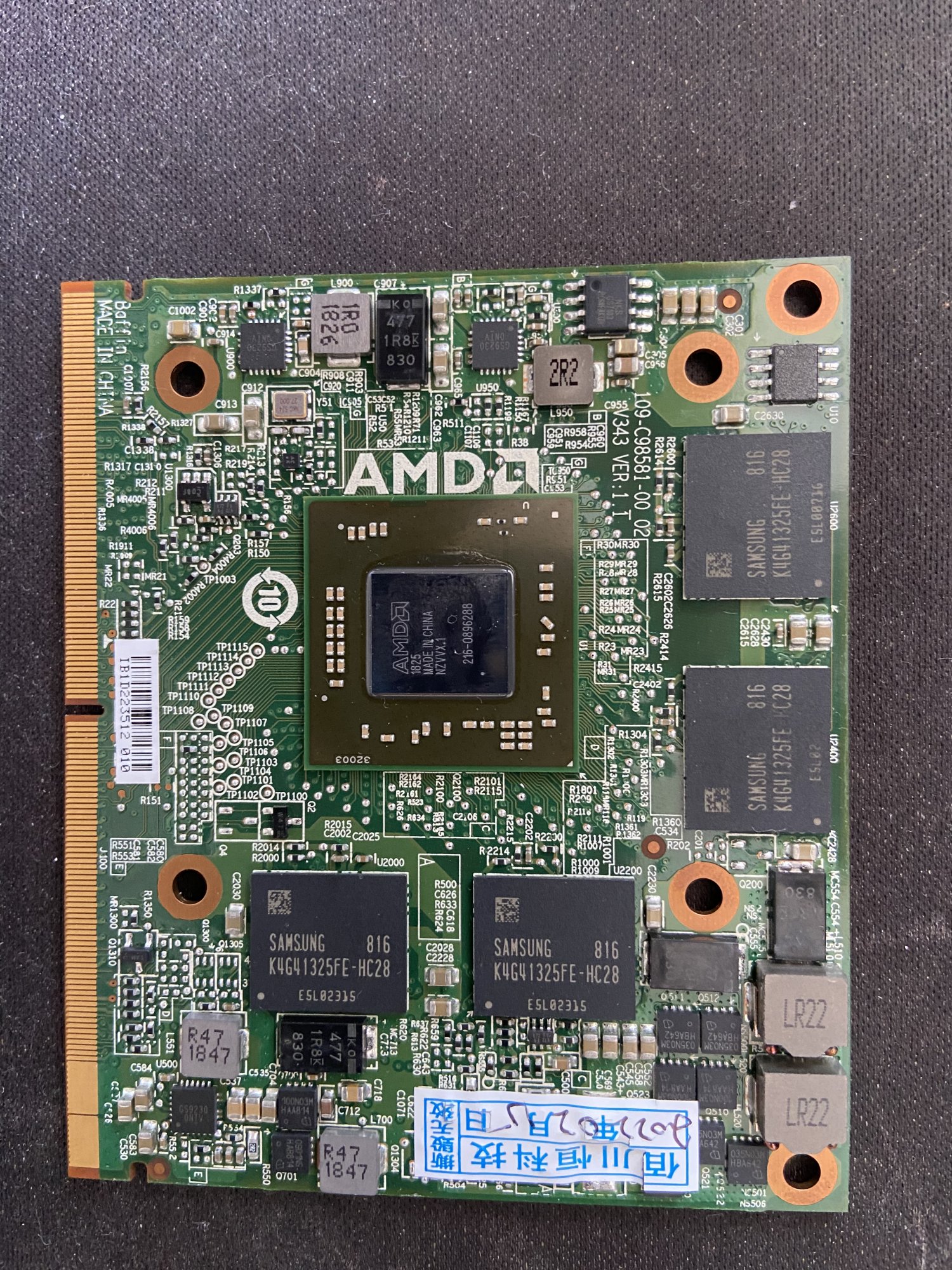

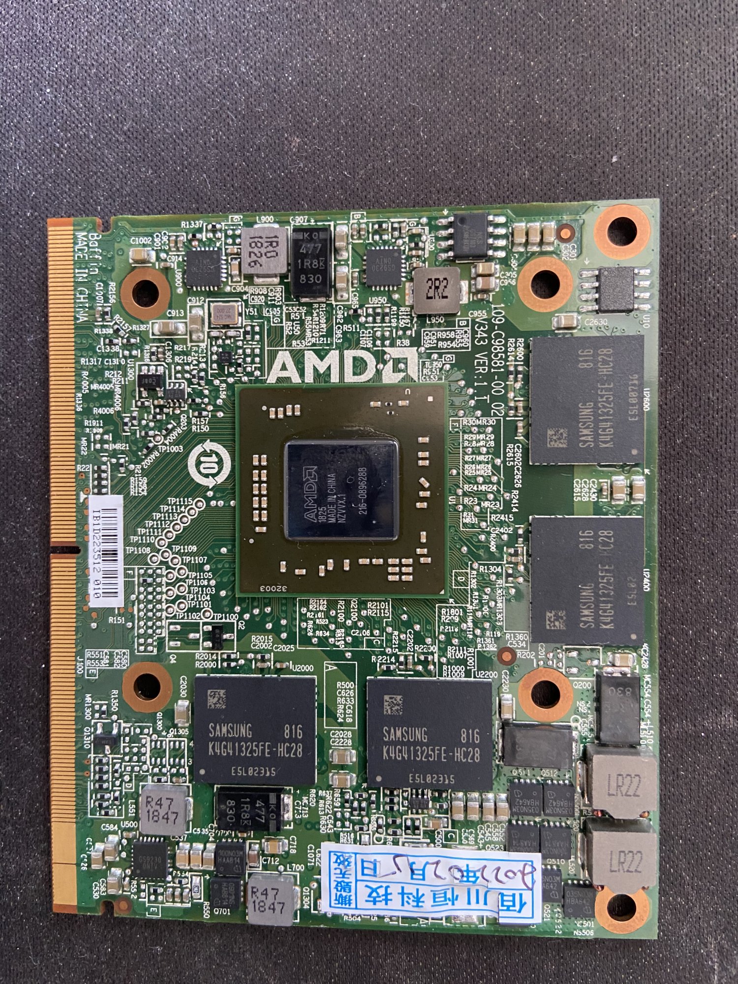

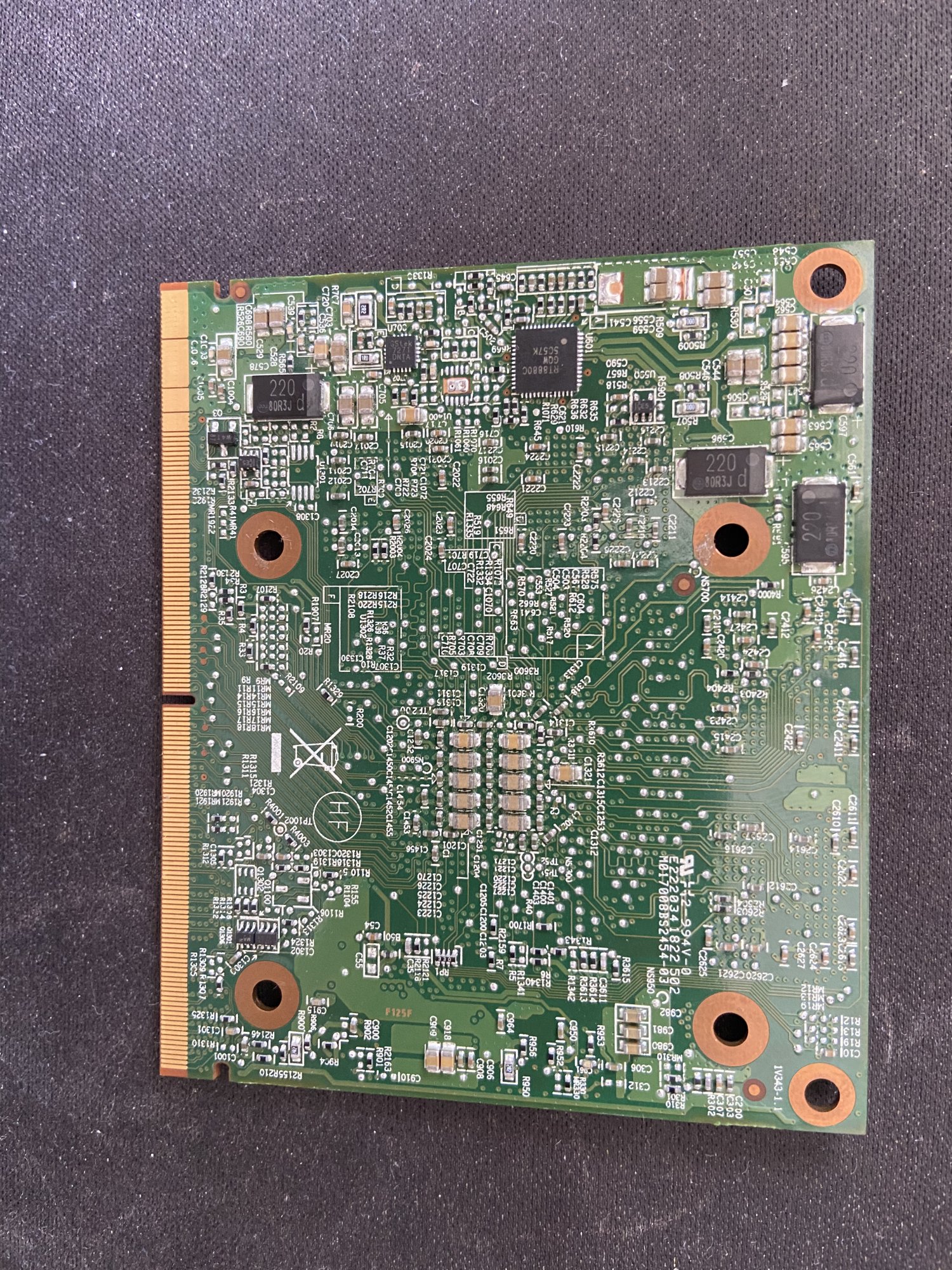

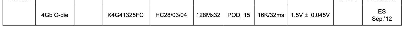

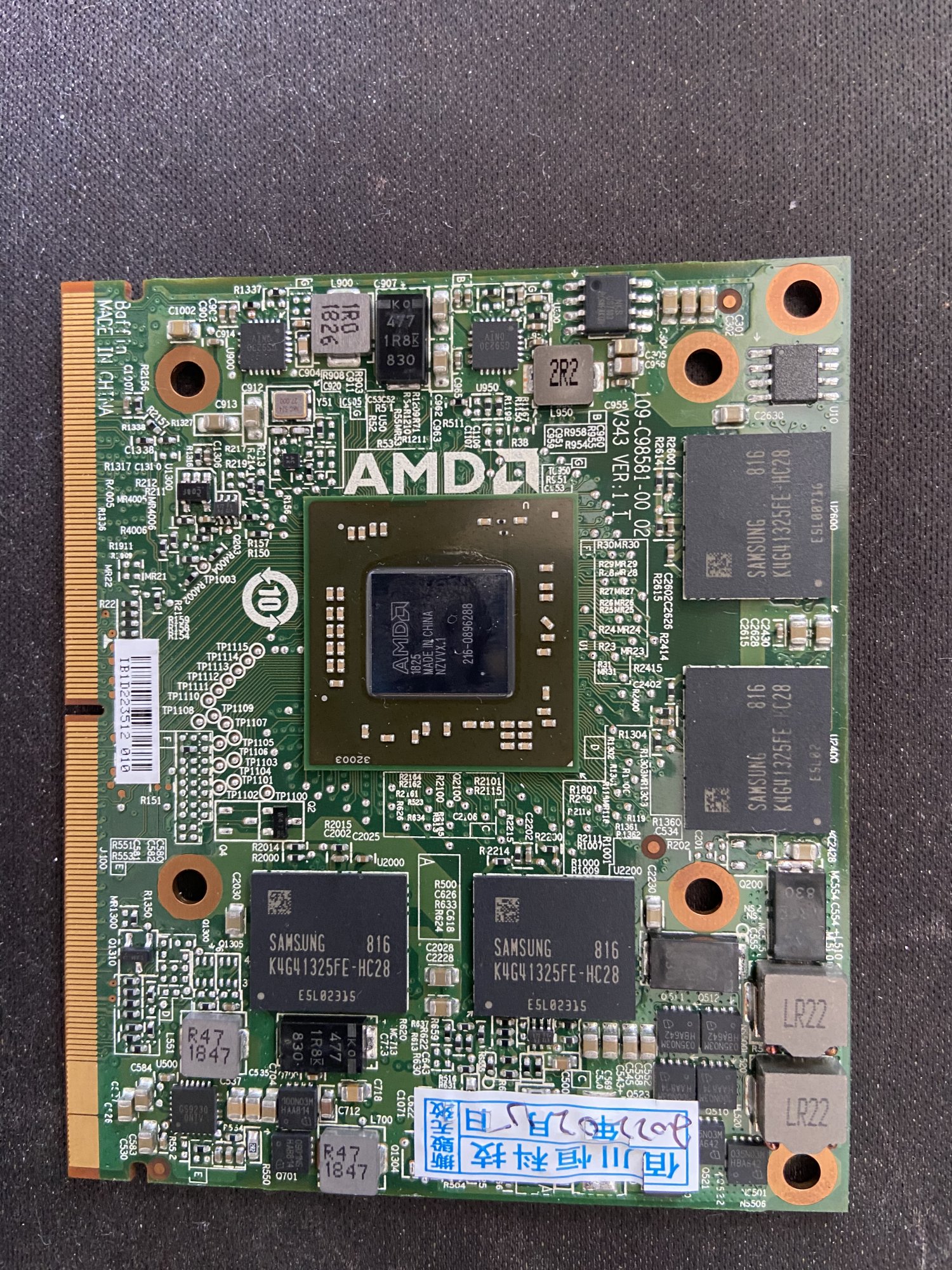

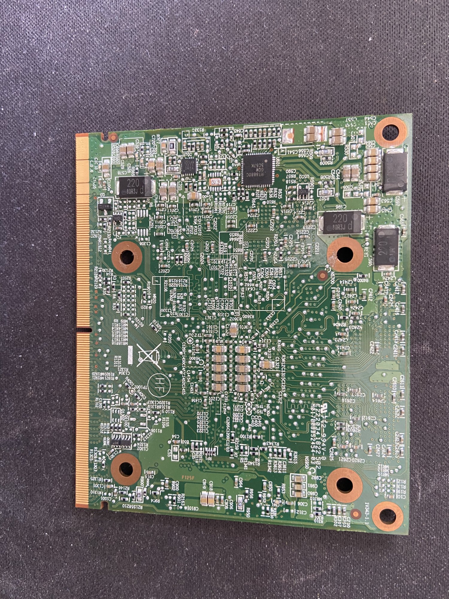

Hi friends! I need help identifying the video card. Is it wx4130 2g or wx4150 4g?
Asking back:
How would you try to achieve this and which part would make the difference?
Can you read out the print on these parts?
Can you feed the string them into a search machine and figure out the attributes of these parts?

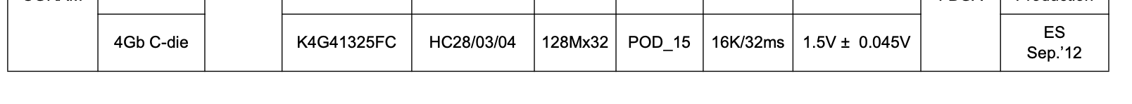

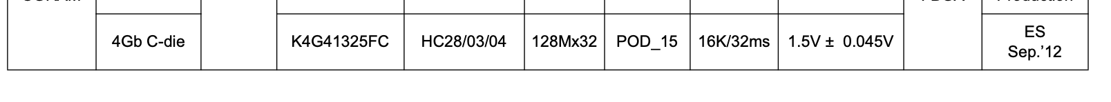

I was given this video card, what model it is unknown. I looked at the prints on the card in search engines, did not find a definite answer. I want to install this card in an iMac 12.2 27" 2011 and need to know what BIOS to flash into this card
But we agree at least you can read the string SAMSUNG K4G4132.... give it a try and count the chips and do the math.
That's gigabytes, right?
The first entry in the row said 4Gb - which is different from 4GB. You have four such chips, you were asking for 2GB vs. 4 GB in total. Now the last unknown in your equation is: What is the difference between a B (Byte) and b (bit).
BTW: 128M x 32 == 128M x 8 x 4 = 1G x 4 = 4G (and b not B although it has not been mentioned here exactly).
