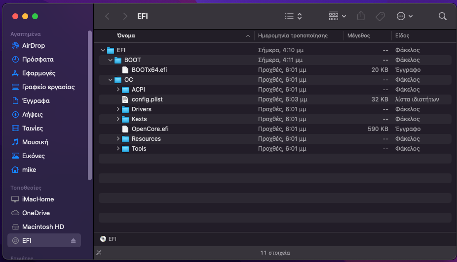

Also, can someone confirm this is the correct layout for the recovery CD? I cannot get the iMAc to boot from the recovery CD (pressing "C" right after switching on the iMac). I only get a black screen. Is there something I missed?
Anyone kindly assist with this? I cannot understand why I cannot get the iMac to boot off the CD. I believe that I have done everything correctly. Did I miss something?
