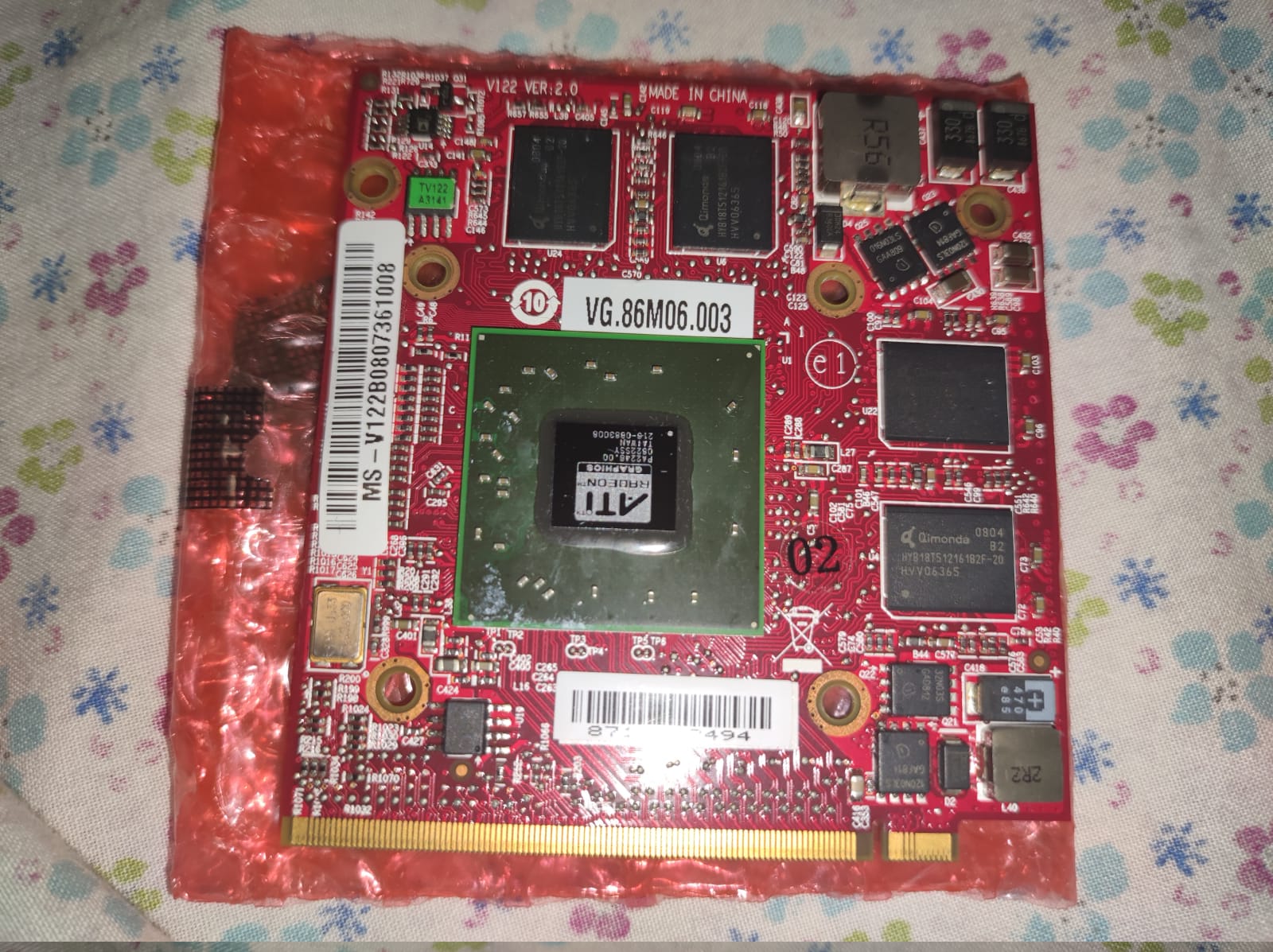

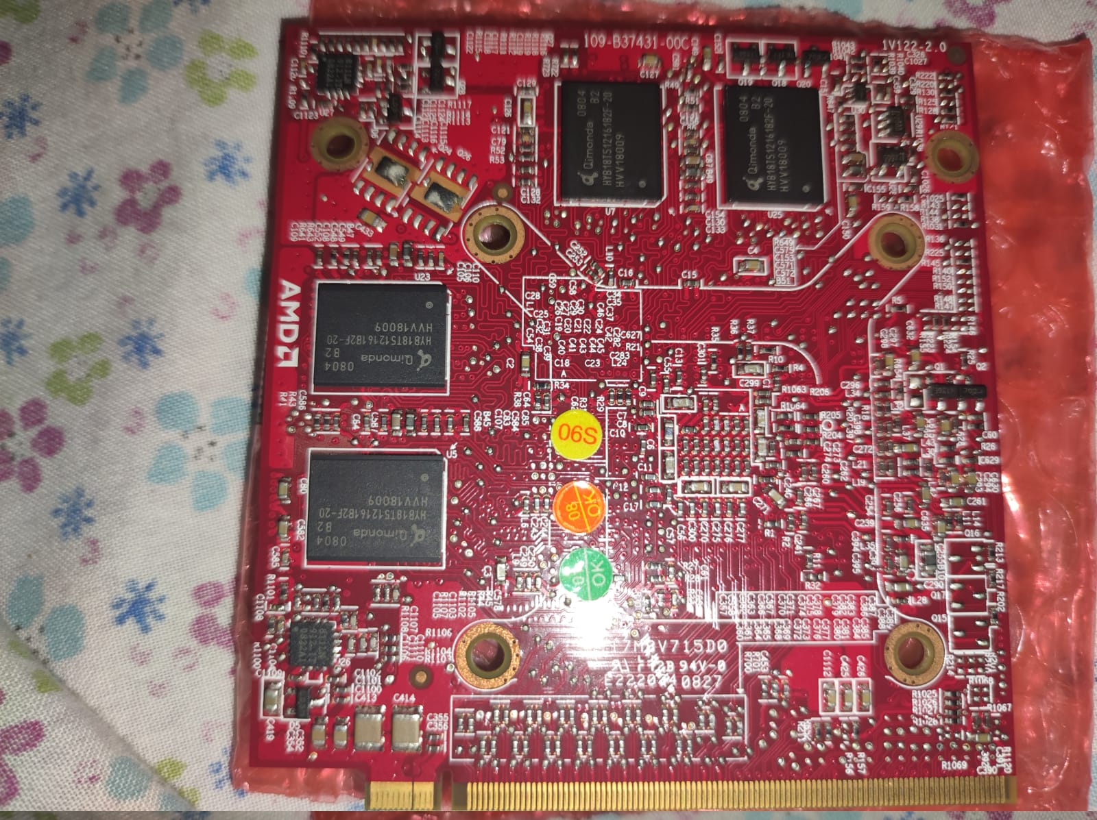

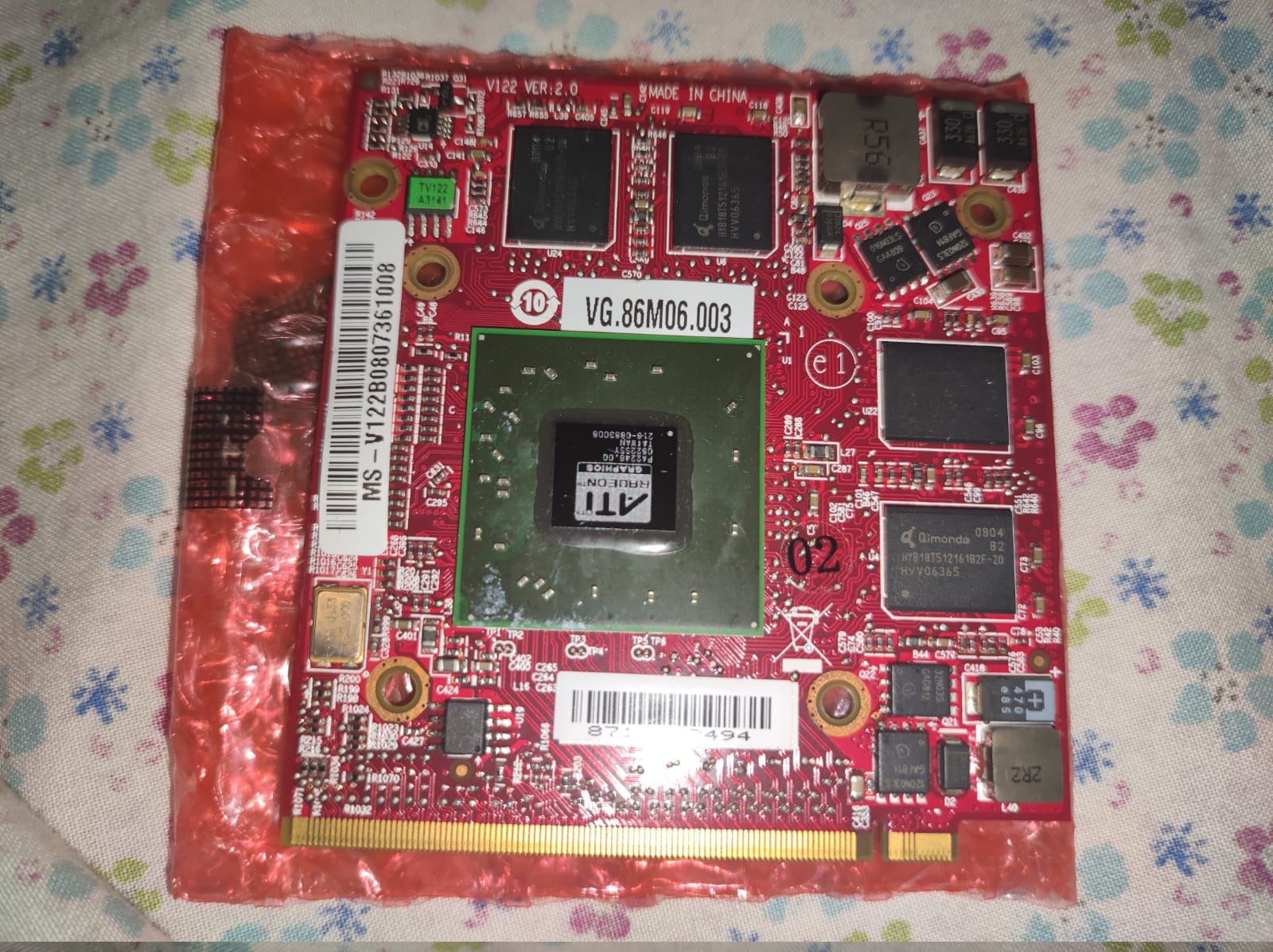

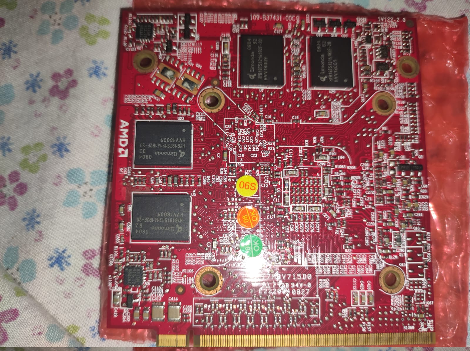

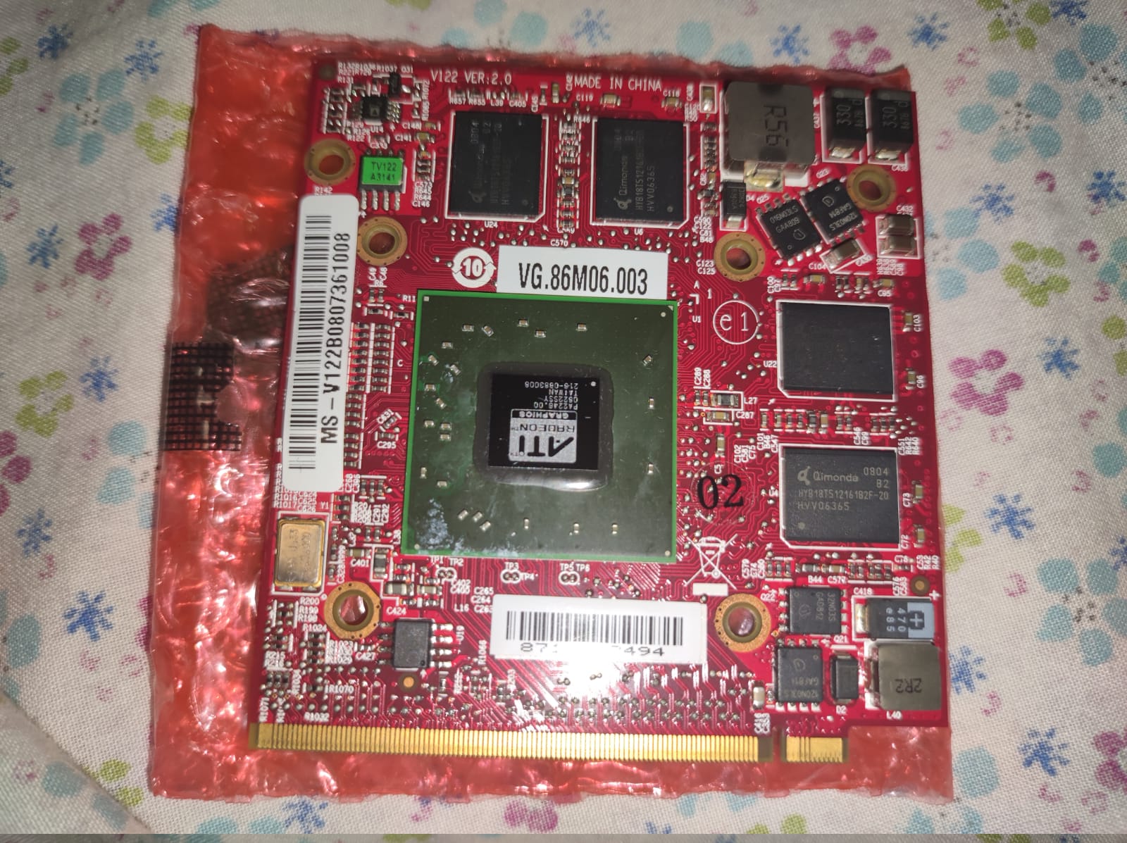

Maybe this is a little offtopic, but I just found this Radeon HD 3650 512Mb card I bought many years ago for a Windows laptop, and I didn't even use it. Would it work in a 21.5" iMac A1311 if my current HD4650 256Mb breaks? I think it is MXM II and the connector seems a little smaller than MXM-A/B.
Here it says MXM-A is backwards compatible:
Would it work with High Sierra? I can't find any Mac ROM.
Thanks!
