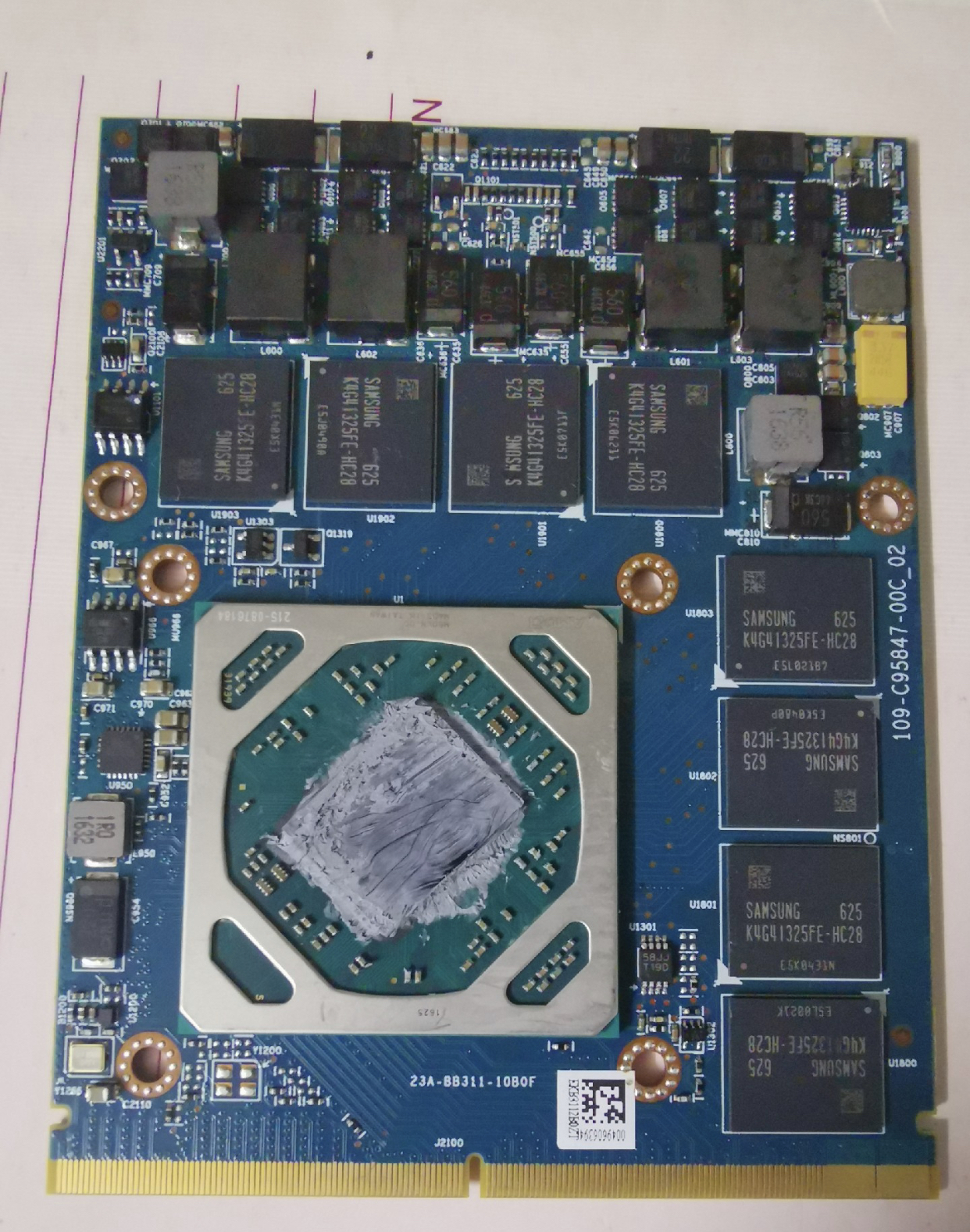

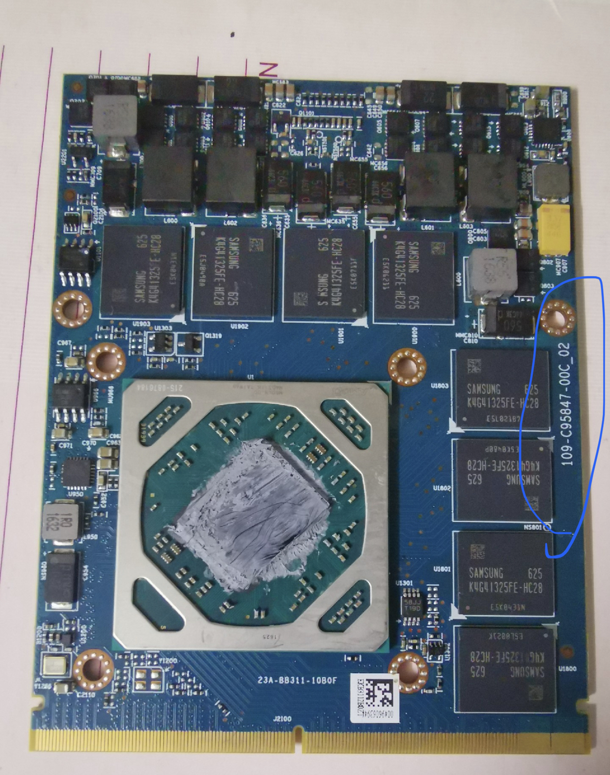

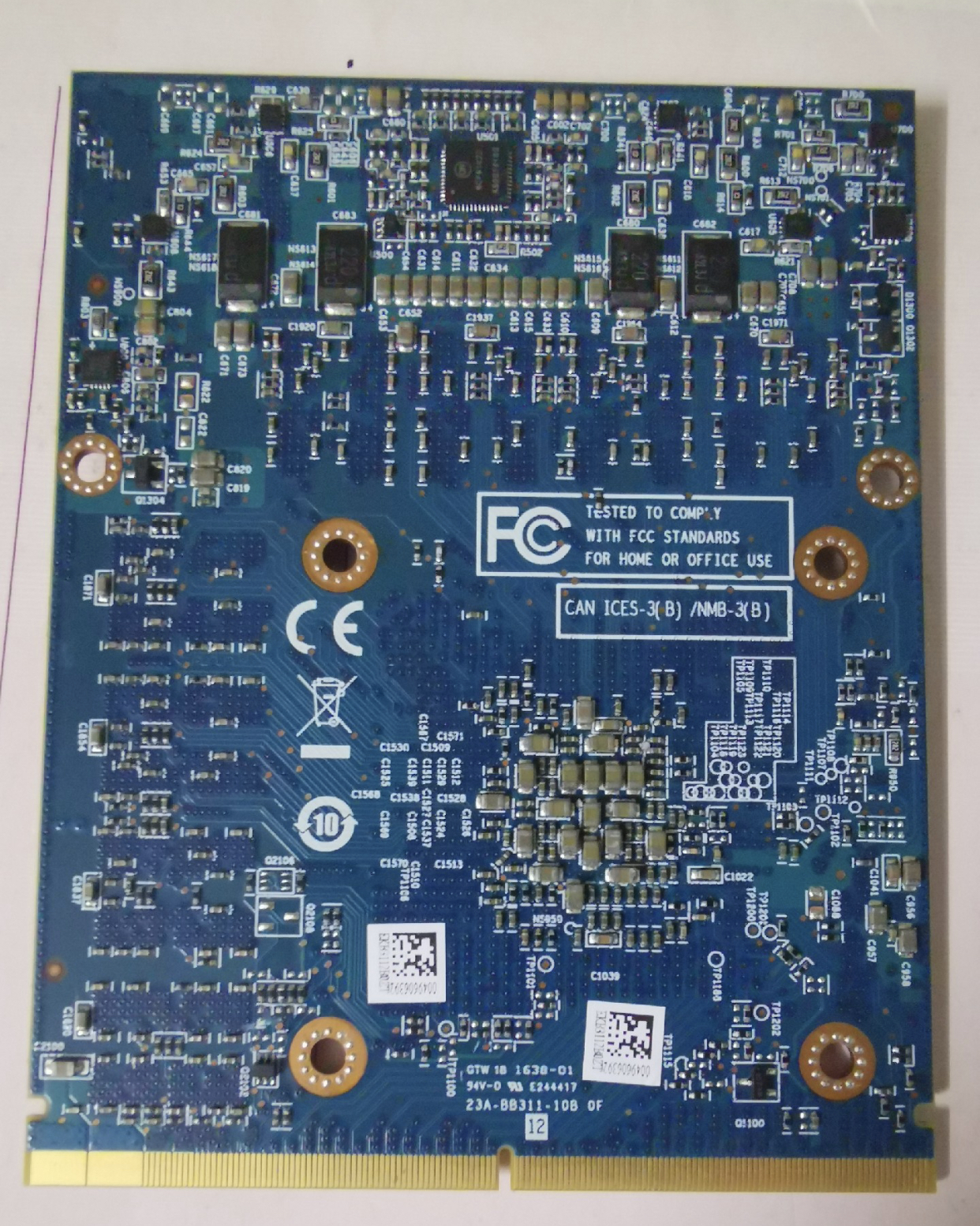

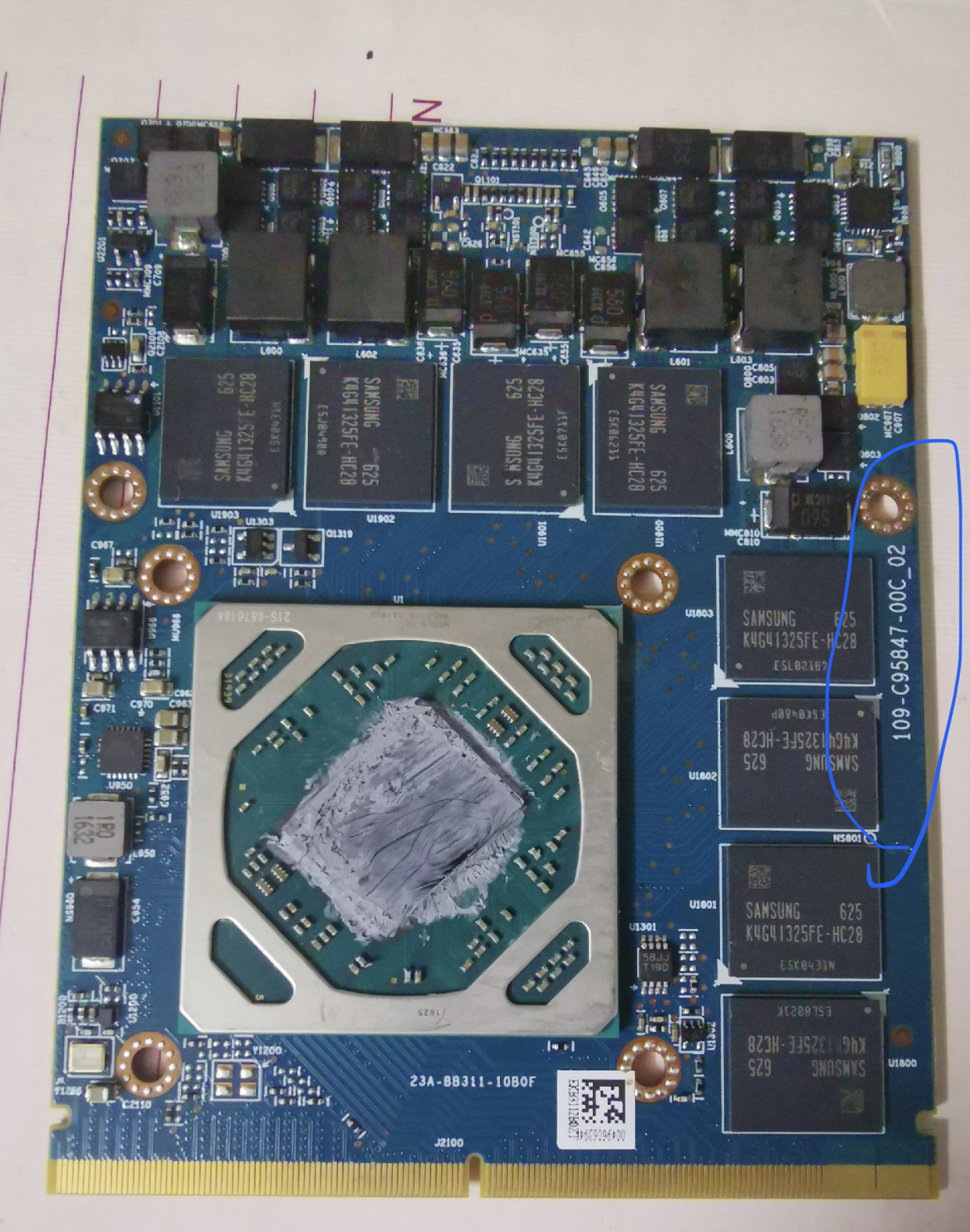

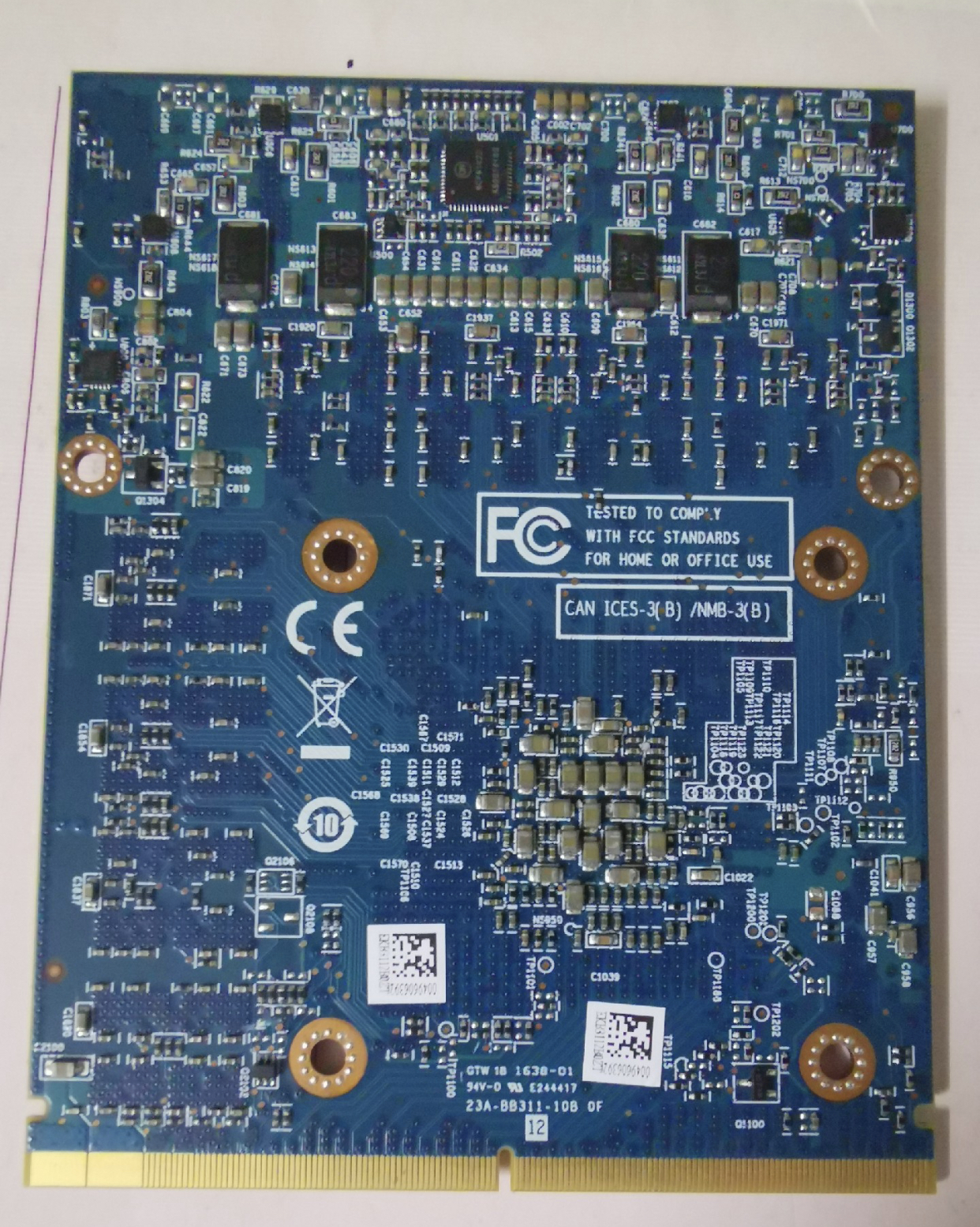

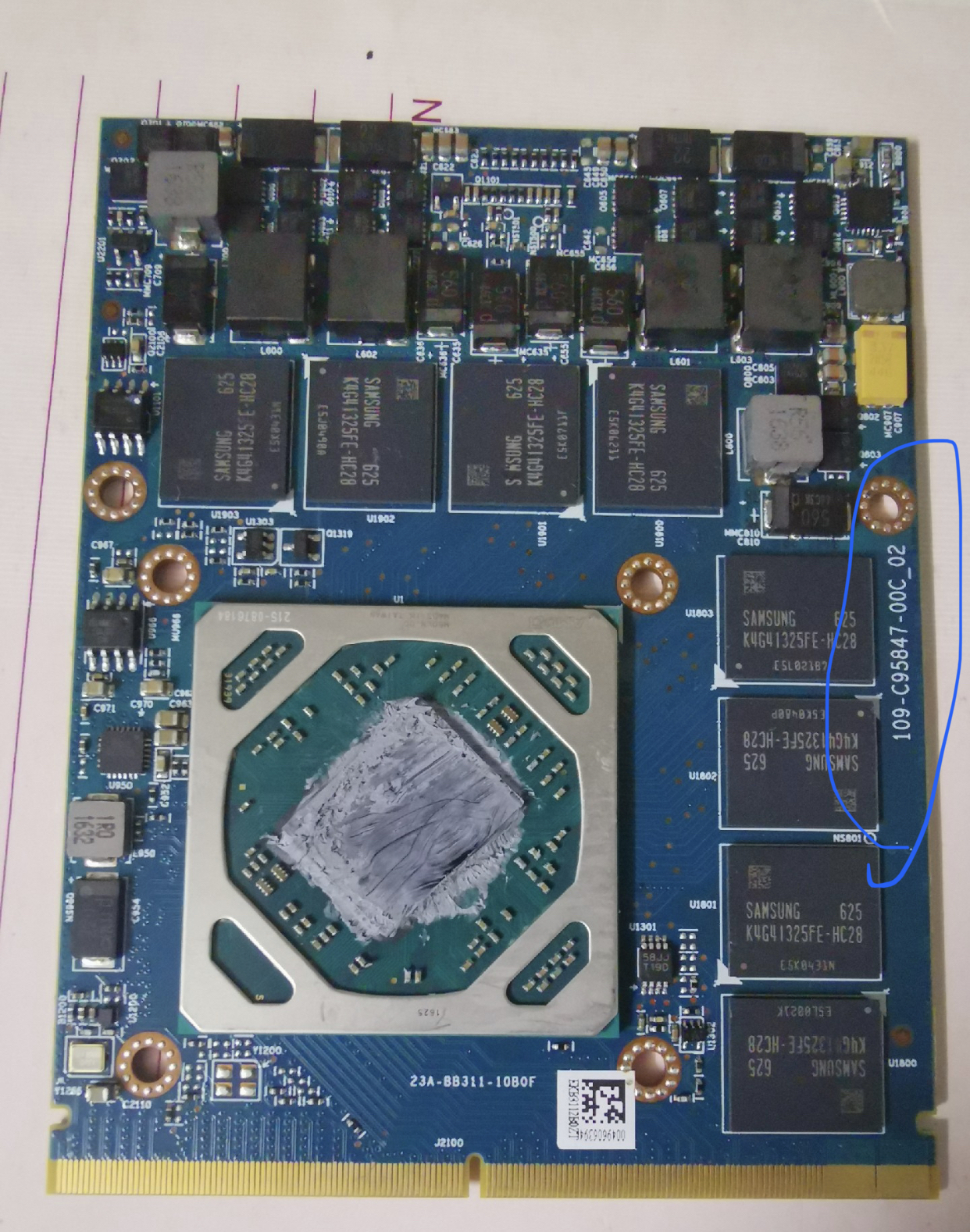

Can this one be used on imac 2011? Query the pcb serial number and find that it is wx7100 but I don't know whether it is ver1.1 or 1.0
Reactions: Ausdauersportler
If I search the number I get W7170M. Not a good candidate for the iMac12,2 2011. Check out the problems we discovered.
109-c95847-00c_02
The query seems to be wx7100, but it is not marked ver1.1 or 1.0 and the pcb is still blue
109-c95847-00c_02
Actually, this does look more like the WX7100. (Especially, the actual GPU die is larger at the W7170M.) Yes, I've already looked at way to many pictures of that card... That said, apart from the blue PCB this card looks more similar to V1.0 cards. But then again, there are V1.1 cards which are very similar to V1.0 cards, while most of V1.1 cards can be easily distinguished from V1.0 cards. The only way to know: Try it (if you can afford it).
