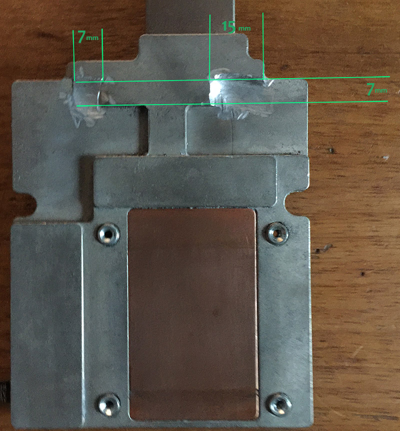

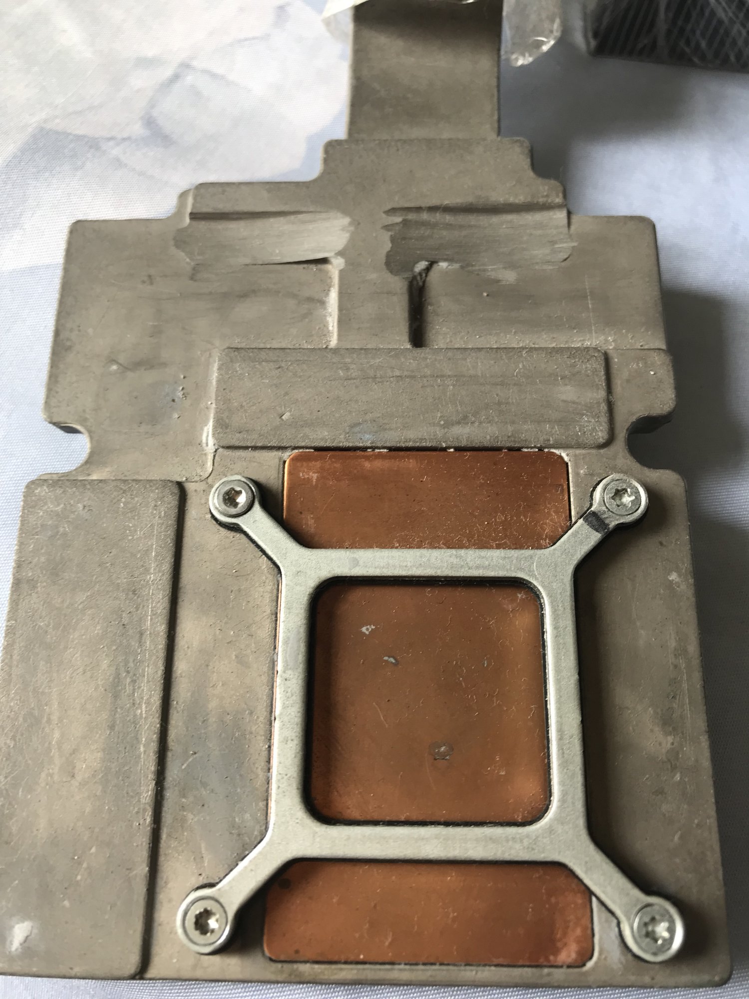

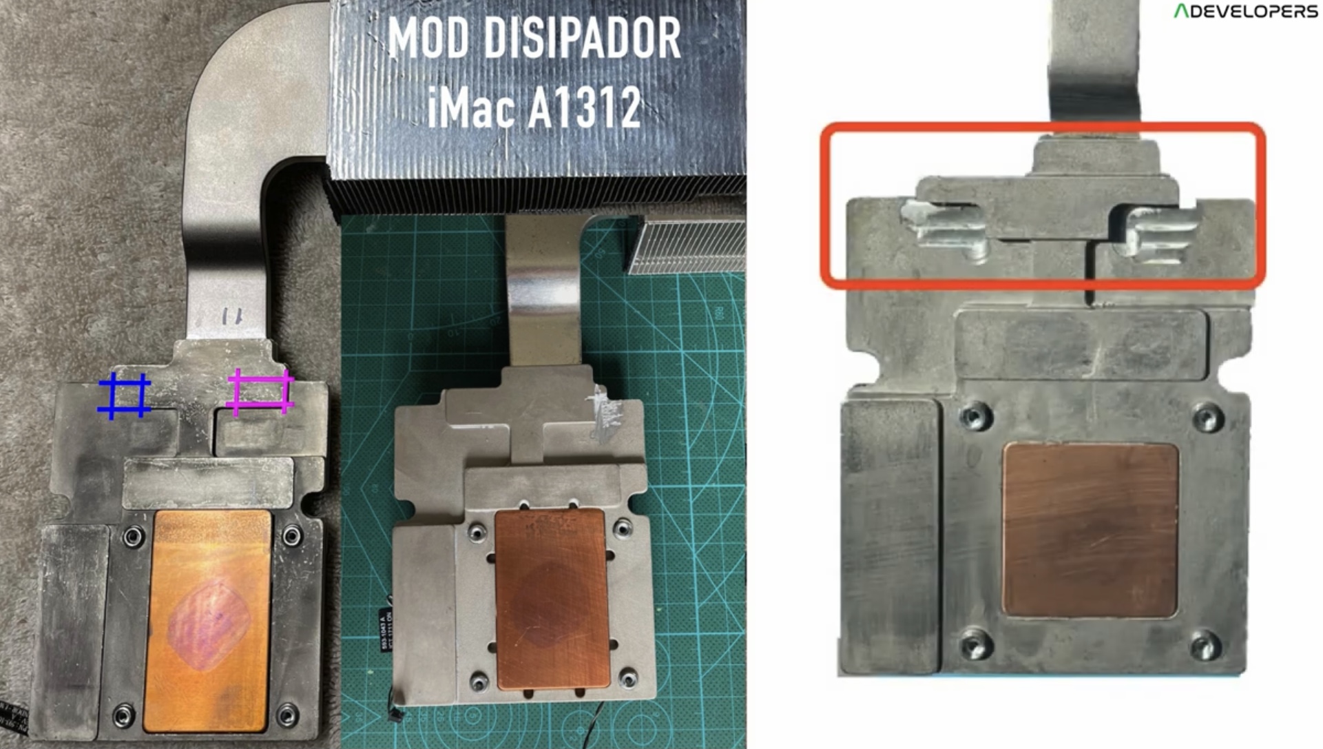

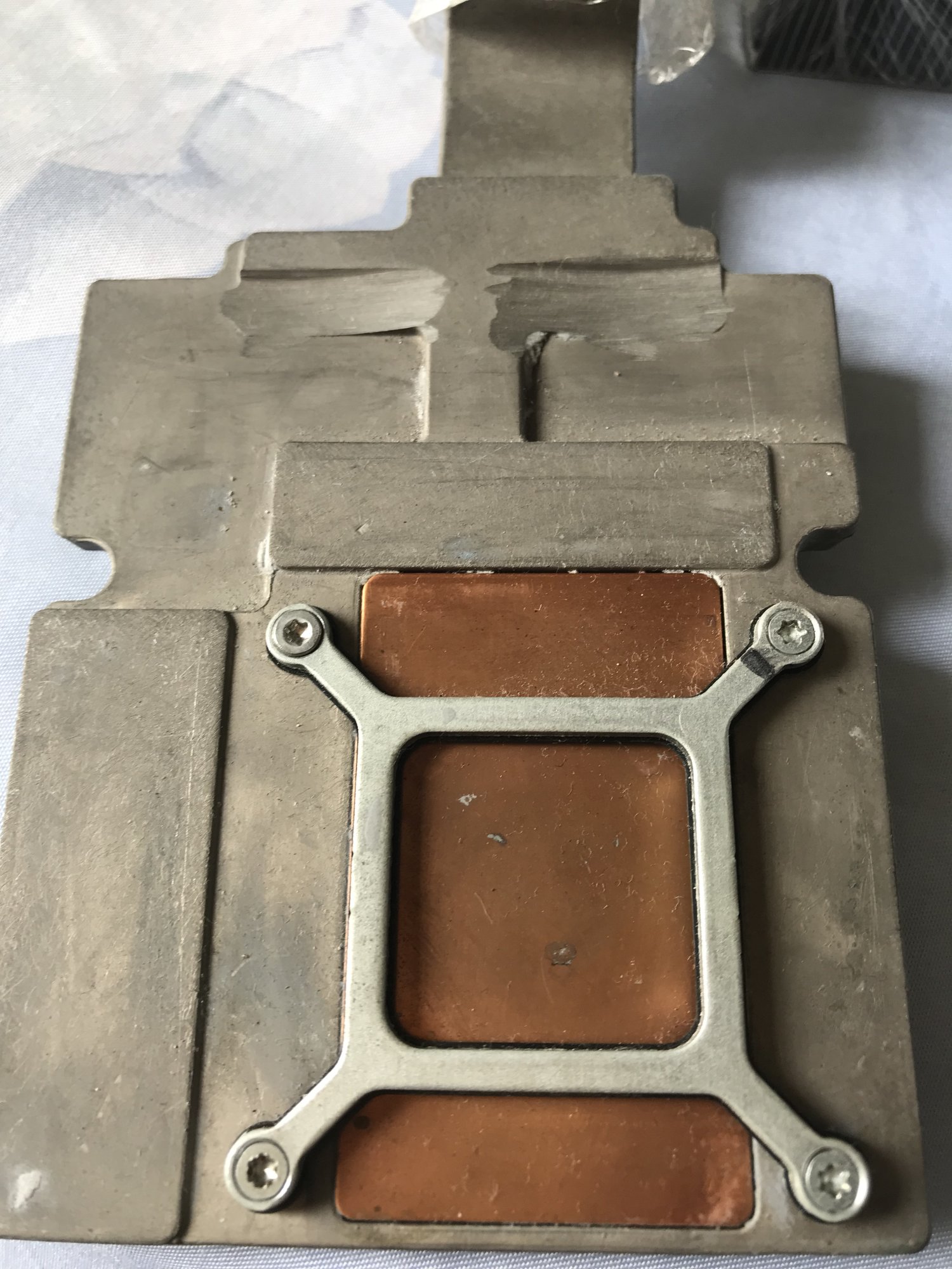

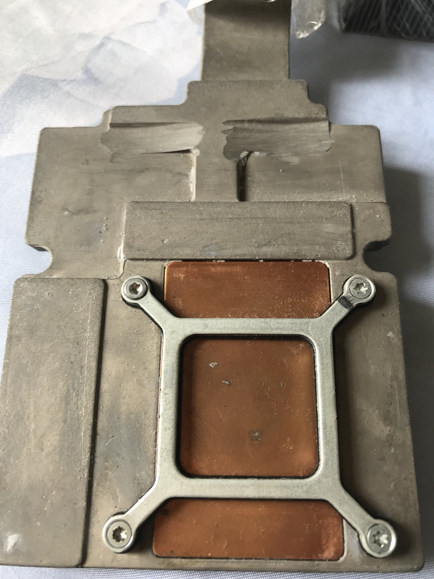

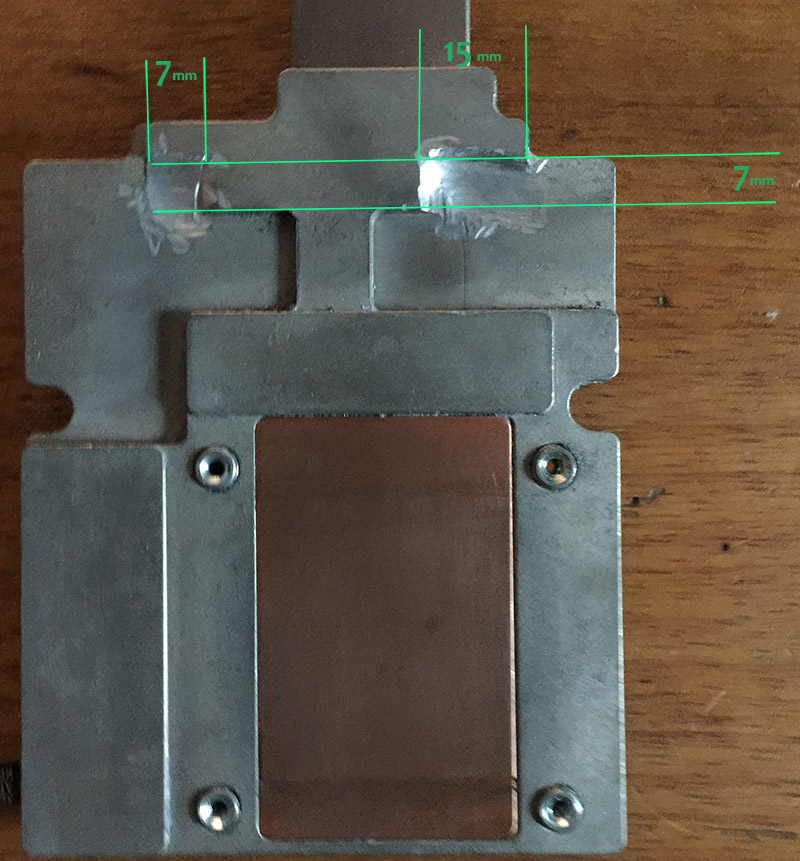

Is it possible to make such a modification with a drill?
I did the modification with both my power Drill and angle grinder.
The drill is difficult to control. I nearly created a hole on the copper pipe once.
The angle grinder is much easier to work with and extremely fast. Just 5 min, comparing with 30~50min with the power drill.

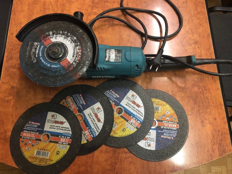

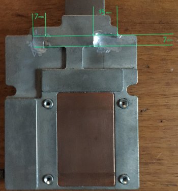

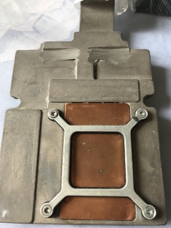

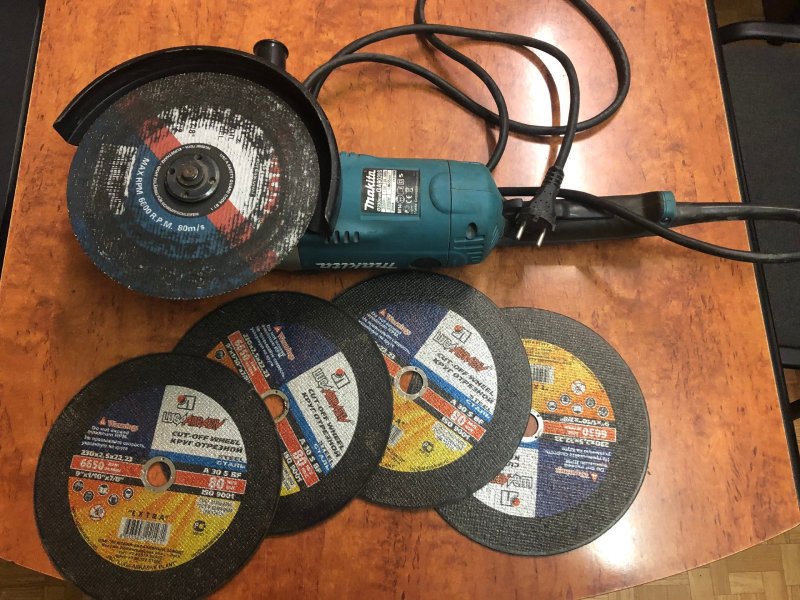

That is, with the help of an angle grinder you can make such grooves?
Did you use discs with a diameter of 125mm and a thickness of 2.5mm?
The photo didn’t survive, how did you do it with the help of an angle grinder? Did it work out neatly?

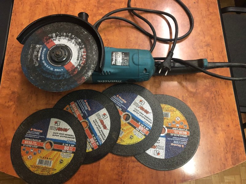

I used 100mm disc, thickness is 1mm or less, because it was a cutting disk. Keep the disc perpendicular to the heatsink surface. I think you can use the desk grinder also, with a small grinding stone (100mm or smaller)
Neatly? I guess so. At least it is better than the ones carved by power drill. Not as beautiful as those gone through a milling machine, but acceptable.

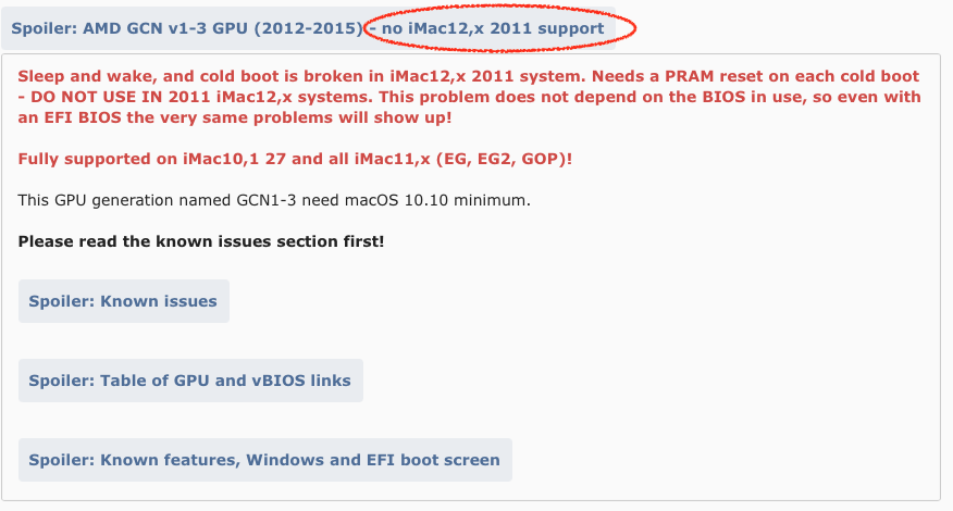

Excuse me for my English, I'm using a Goole translator,

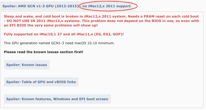

I'm having problems on an iMac 27 Mid 2011, where I put an Amd Fire Pro M6100 video card. I need to reset the Pvram for the screen to work, and when I run a video application it freezes, and the GPU is always at 600Mhz.

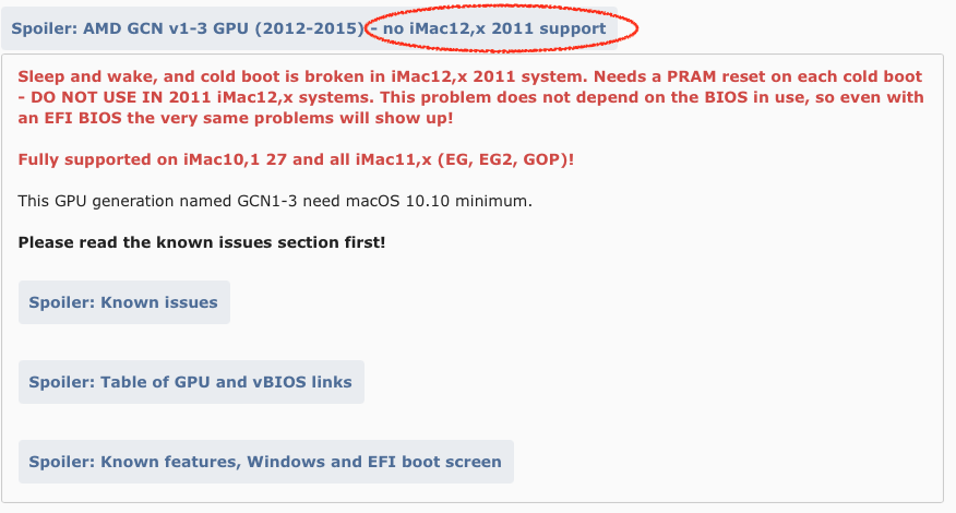

AMD S7100X support (AMD Radeon S7100X 8GB)
TypeidentBIOS versiondevice-idworking
Red AMD PCB109-C769A1-00_02S7100X6939yes
This GPU will be identified by the macOS as AMD FirePro R9 285 8GB - this is purely cosmetic!

Known problems:
- does not run reliably in the iMac12,2
- flashing using the GRML amdvbflash failed consistently - had to use the CH341A clip to avoid problems
Known features:
- Airplay is working until Catalina as with any other AMD metal card on iMac11,x and iMac12,2 (without using QuickSync)
- high metal scores
- boot screen with OpenCore
- GPU power management working
- still full Monterey support (no root patching needed unlike Kepler)
- DRM support (even with Ventura und OLCP 0.6.4+)
- card needs iMac12,2 MXM-B heat sink and the same Dremel modifications as the W6170M/W7170M cards.
- GPU chip was called a barn heater once here, it is dissipates the most heat of all cards ever tested
- failing to control the FANs or ignoring the ODD sensor replacement will burn the card to death in a few months!
If you use OPC 0.6.8 and MacOS Big Sur 11.7.8 and disable sleep mode everything should be ok

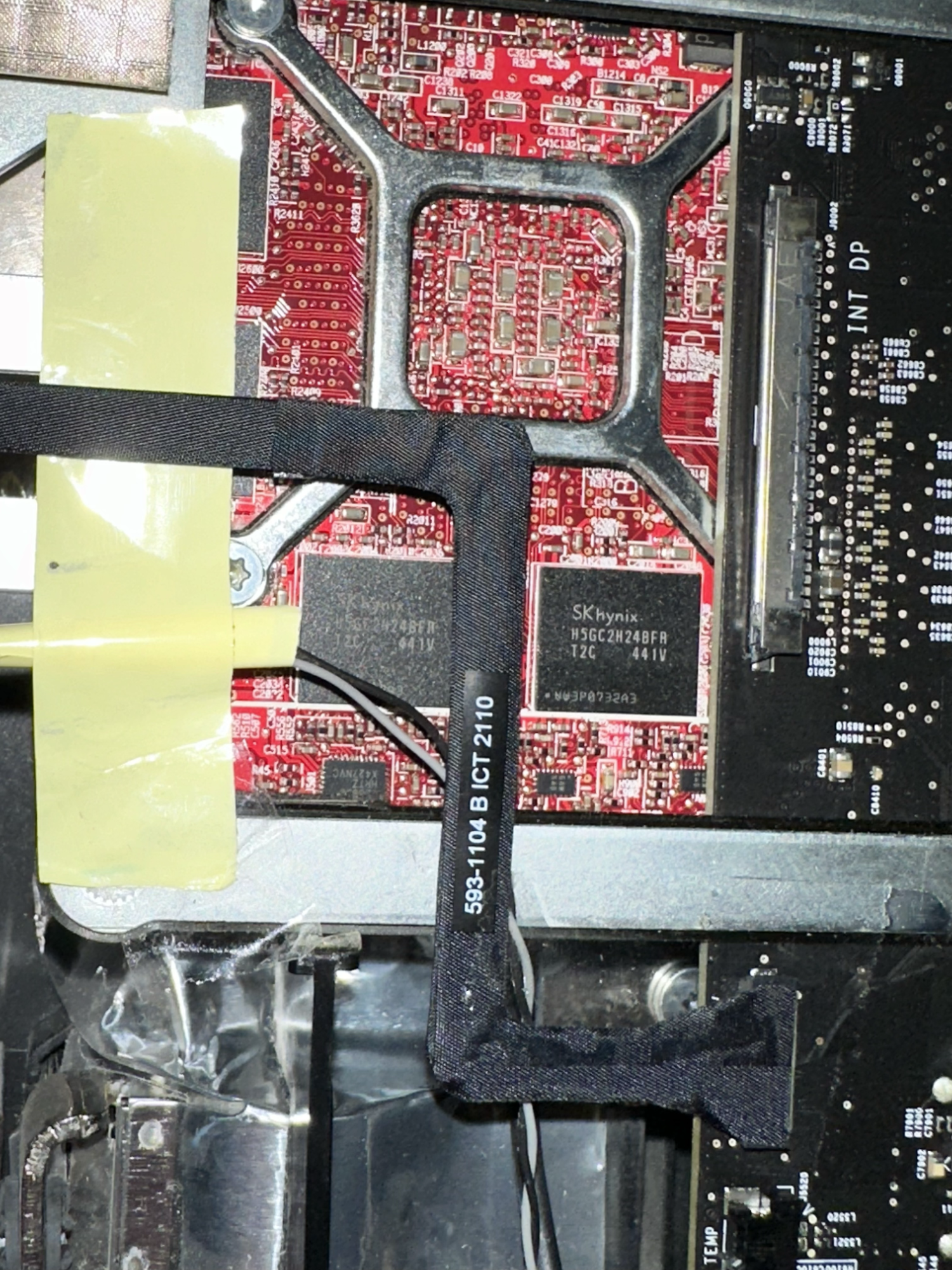

Is this maybe one of those cases where you need to have something plugged into the displayport, even if it's just a dummy connector?
Does not work.

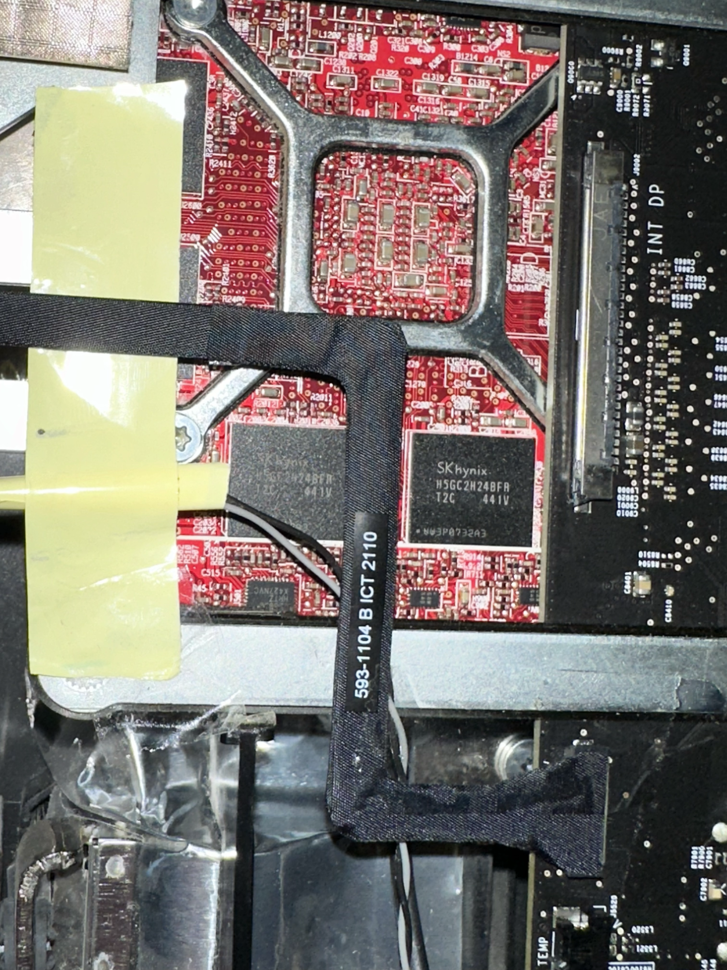

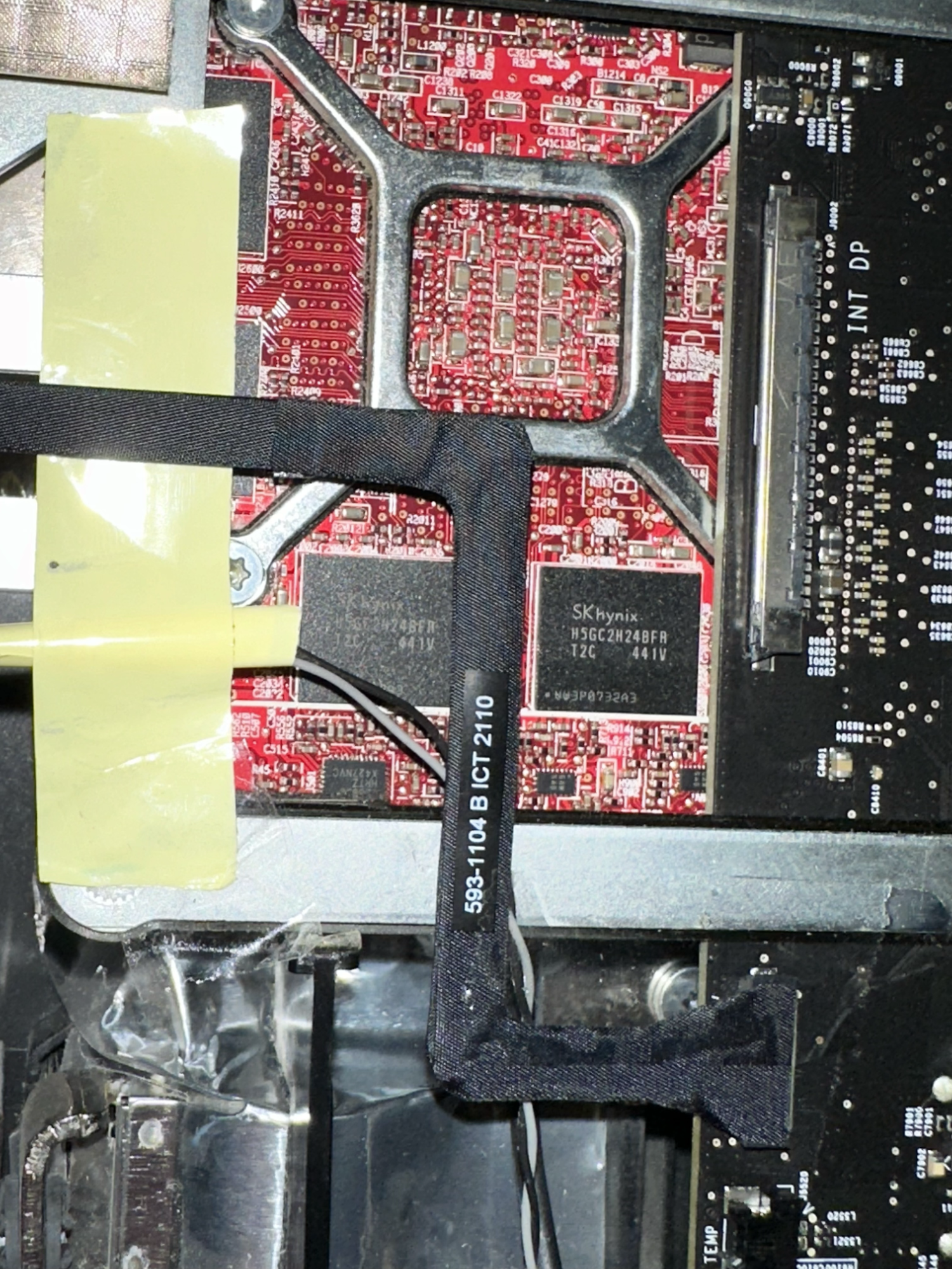

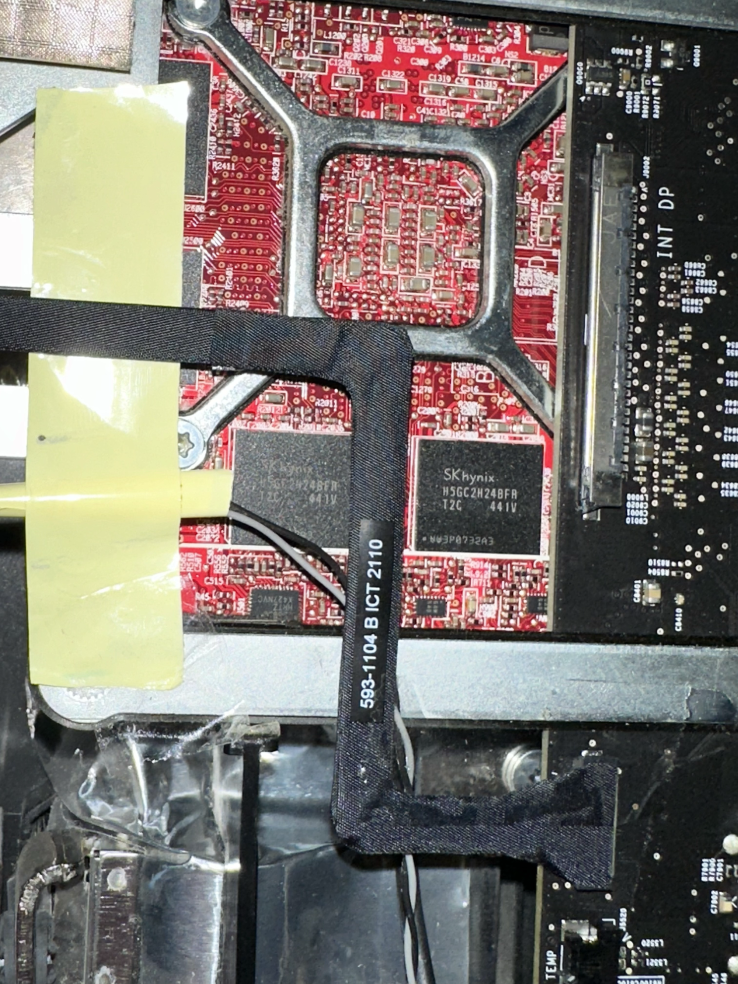

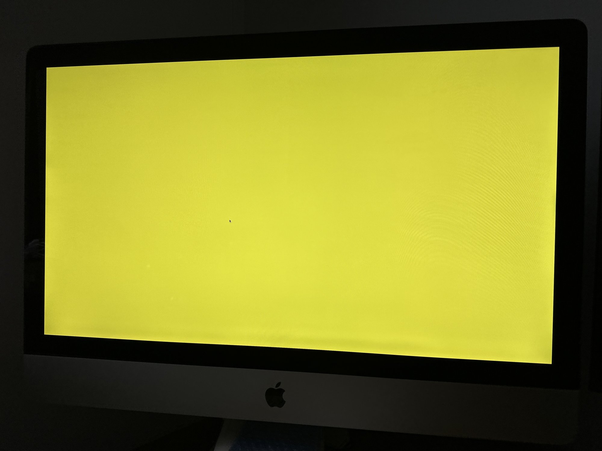

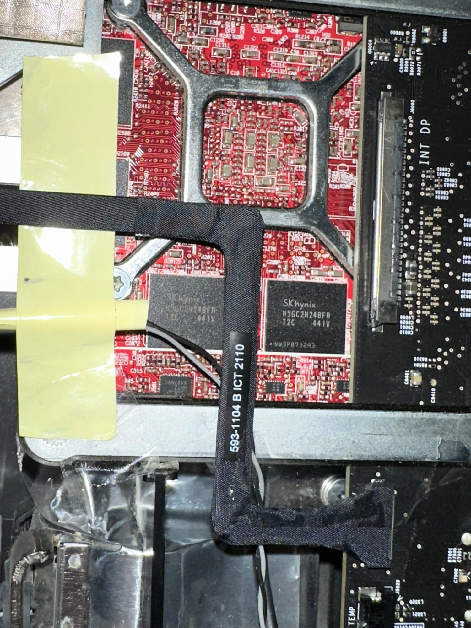

I tried multiple things. Bought this card: M5100
The iMac M5100 version, which is already flashed. It's the red M5100 version.

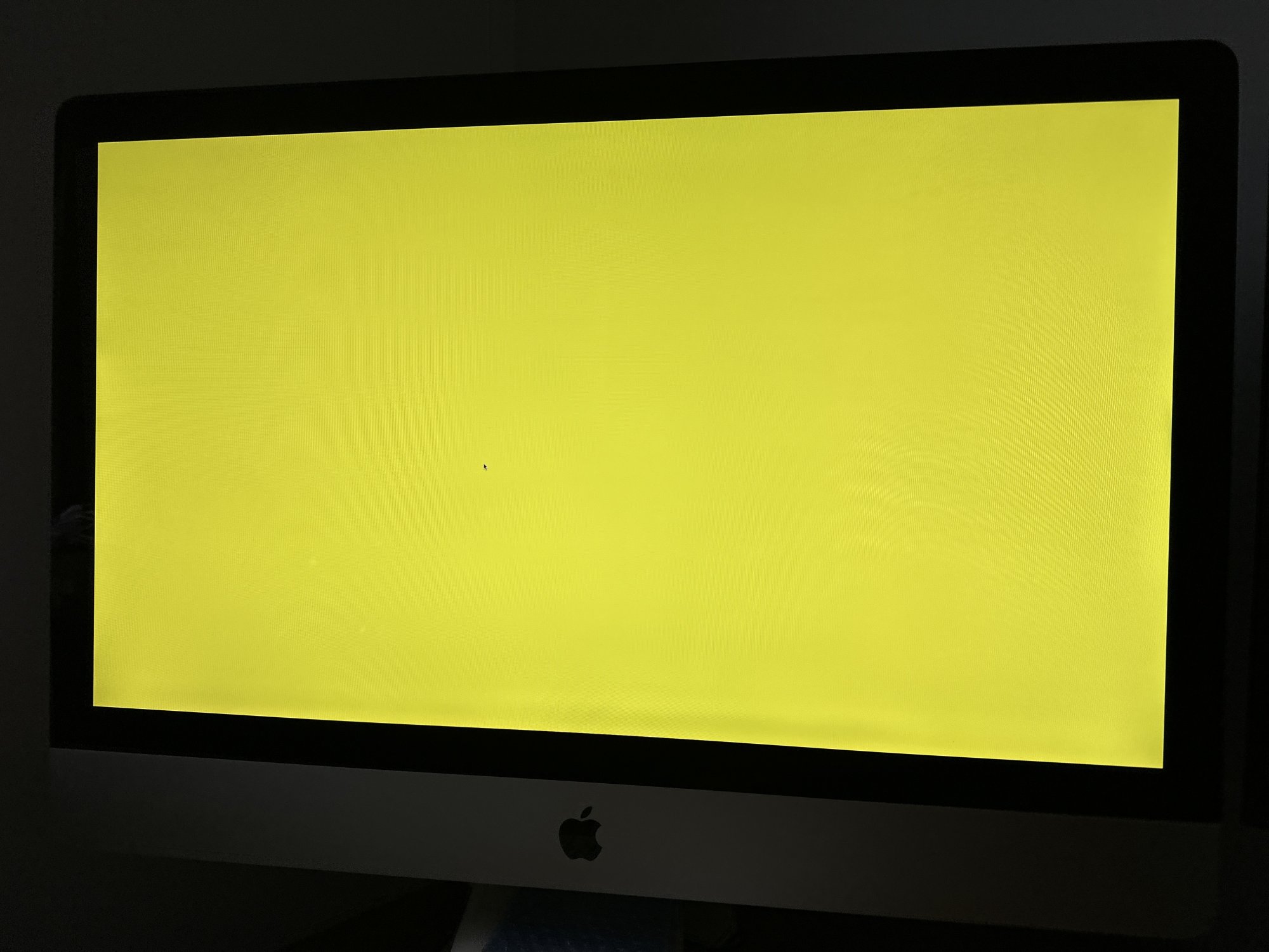

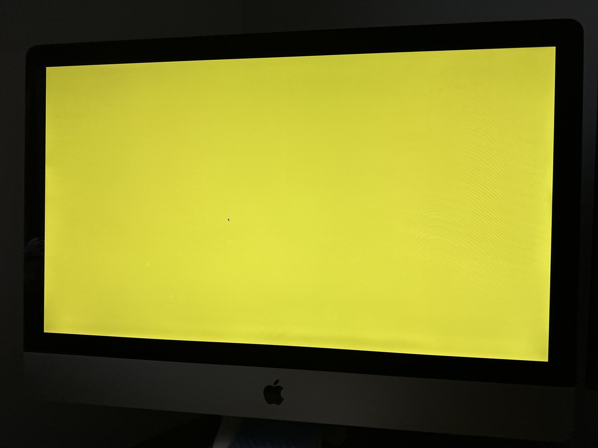

After installing the Post-Install OCLP patches it detects my GCN AMD Videocard. OpenCore then asks me to install these patches for my videocard which goes perfectly fine. Then after booting normally I boot into a dimmed yellow, sometimes purple screen (can only boot in SAFE mode to get a screen). Not showing anything at all, just plain purple/yellow. However my iMac shows it's an HD 7xxx card with 2GB of VRAM (which sounds correct). After reverting the root patches and then rebooting the Mac, I am perfectly fine booting normally into MacOS Ventura however it then says its a "Generic VideoCard with 14MB of vram". Tested multiple versions of MacOS.
SKhynix BFR version btw.

Does not work.
Not quite sure what I did wrong but I flashed the SKhynix BFR version btw. M5100-EnableGop91-LVDS-HynixBFR to the videocard, since it has the BFR memory. (SKhynix, H5GC2H24BFR T2C 441V).
Accessed the videocard now again via SSH using GRML Linux. I'm not quite sure what vBIOS is need. I thought that the HynixBFR version was the correct one. Can't seem to connect to the Mac anymore. Getting: Connection Refused on Port 22.

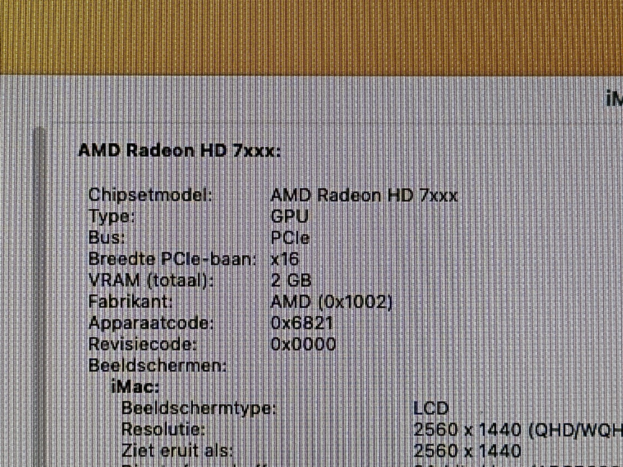

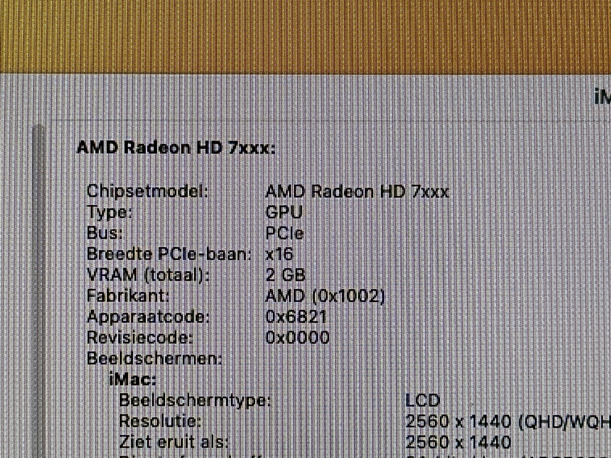

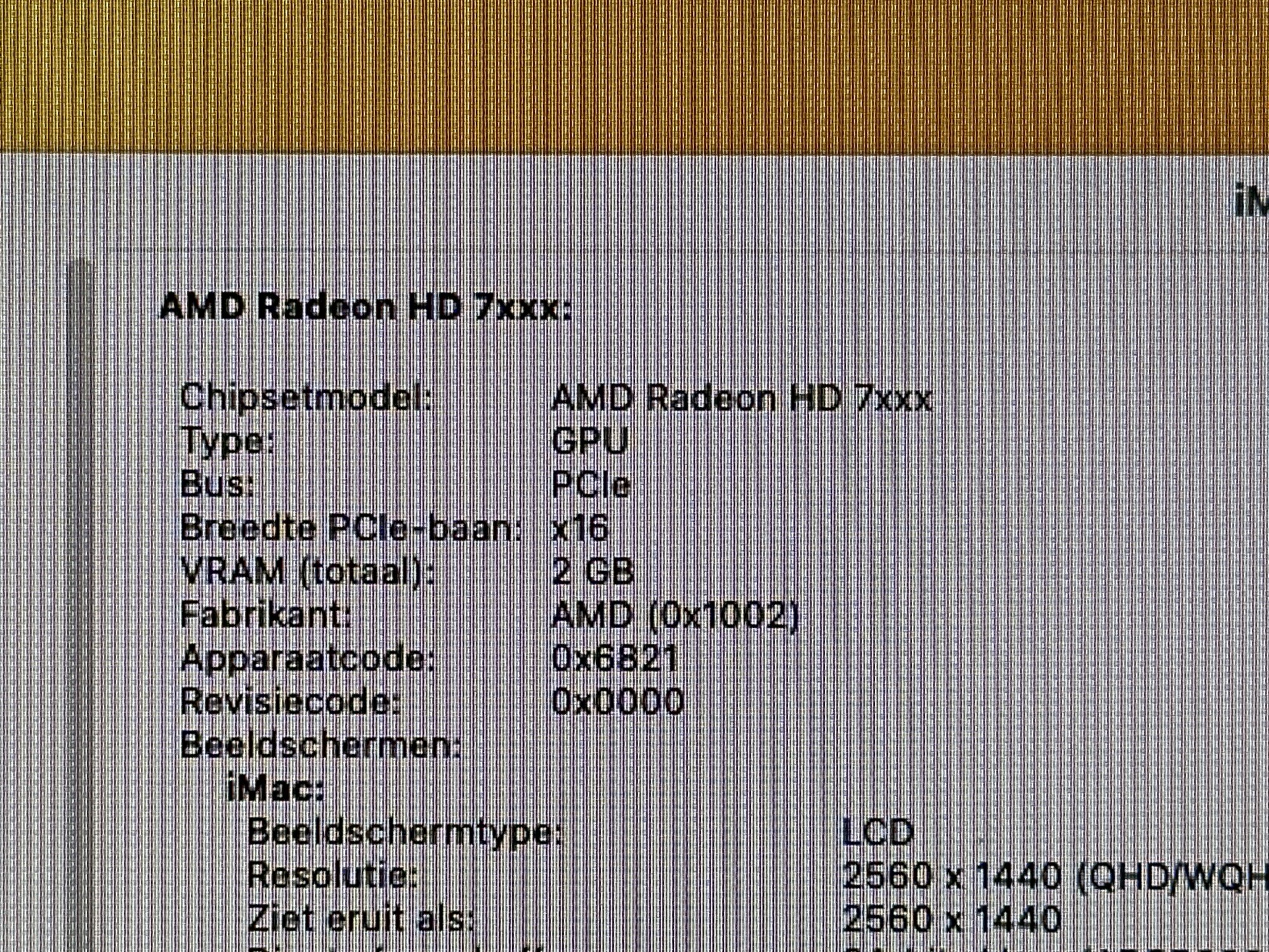

Update 18/09/2023
Okay fixed the SSH connection. Installed multiple rom's:
  1. M5100-EG2_HynixBFR_adj.rom, did not work, no screen, no bootpicker, all black.
  2. M5100-EnableGop910-LVDS-HynixBFR.rom, did not work, no screen, no bootpicker, all black.

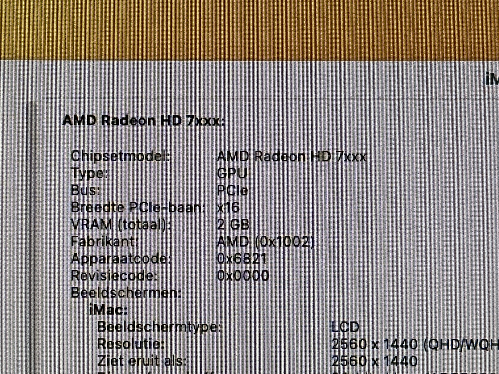

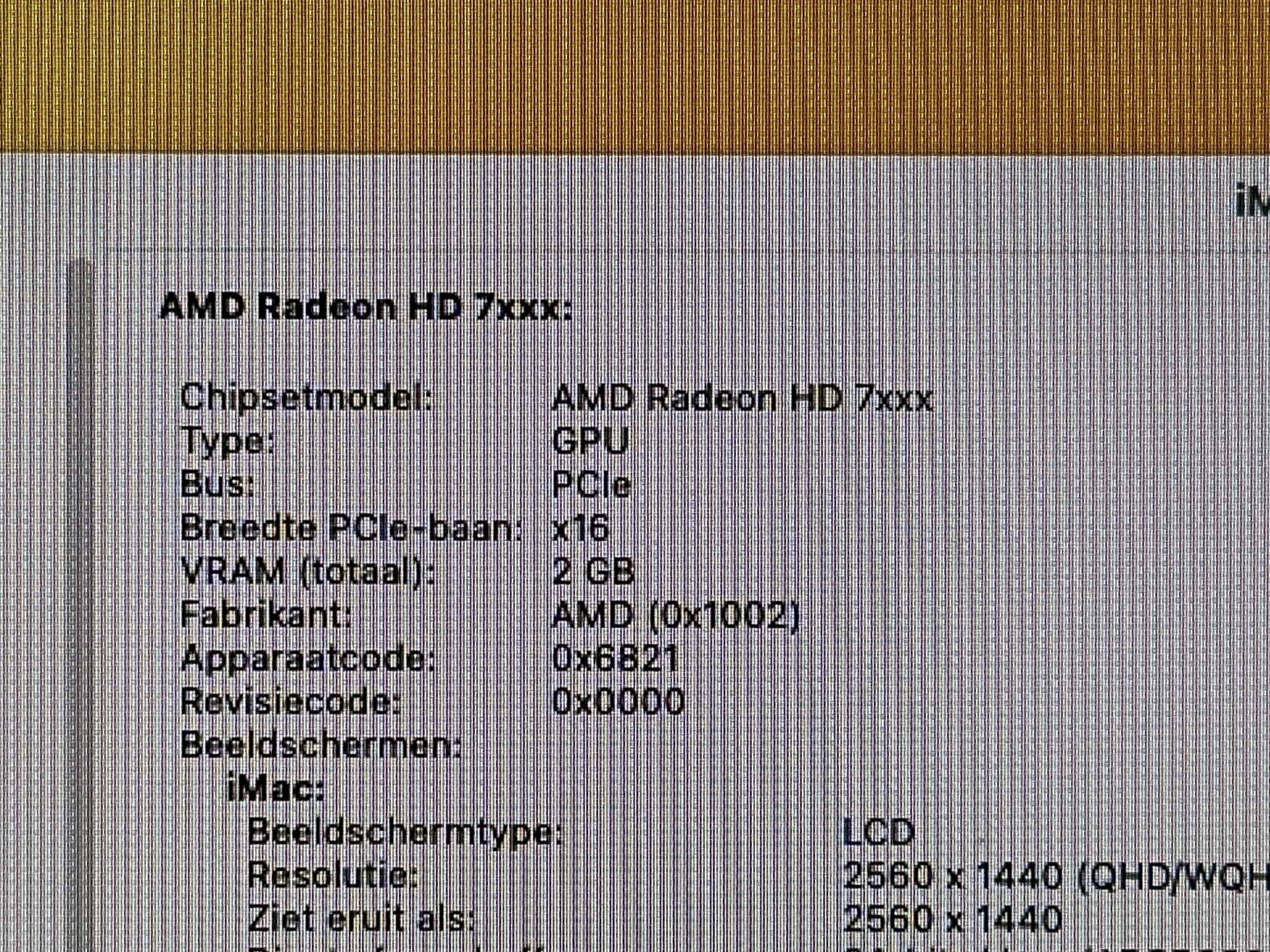

  3. M5100-GOP_HynixBFR.rom, does work, giving screen, can see the boot picker, but when booting into MacOS I've got a Yellow screen again, sometimes it's purple. Unless when I boot into Safe Mode. It is showing my GPU as an HD7xxx with 2GB vram tho.
@Ausdauersportler Have you got any ideas? Am I doing something wrong, am I missing out on something?
