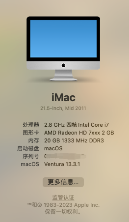

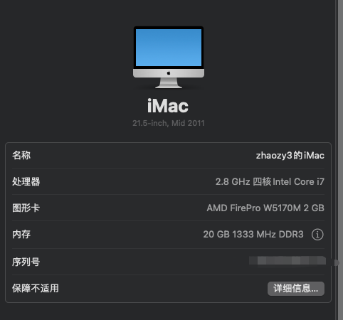

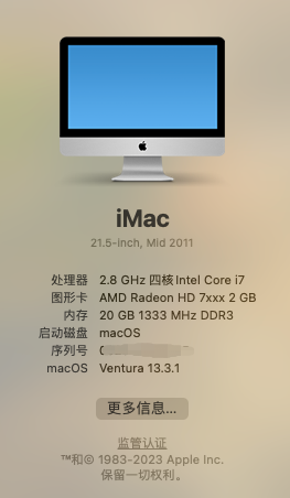

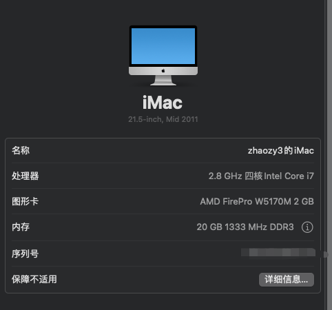

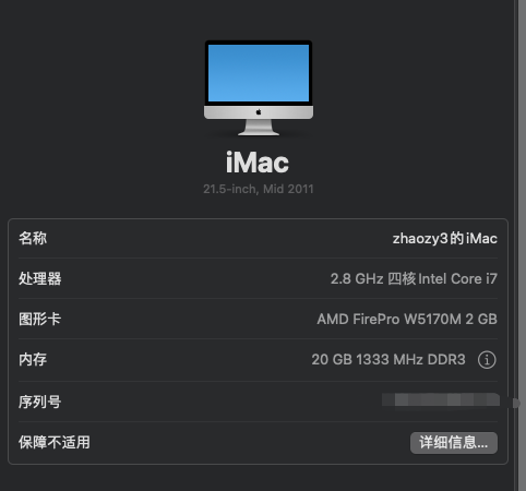

I changed a W5170M graphics card to my 2011imac, and successfully flashed vbios and drivers, but there is a strange problem, every time after a cold start, it shows that the graphics card model is HD7XXX, and it shows W5170M after restarting, passed the geek6 test, the performance it's the same
Hi ZZY159! Can you help me with the vbios and drivers flashing process? I cannot find the files or the right step by step. Thanks!!! I have a 2011 27inc Imac

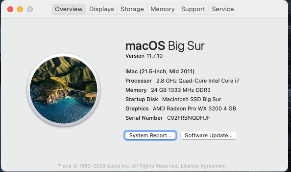

Hi. Bought an AMD WX3200 GPU from an Aliexpress vendor. The process was really easy
and along with an i7 2600s CPU and an SSD drive it runs excellently with a score of around
40 fps on Unigine. I'm running Big Sur and it's really stable. Eventually, would like to upgrade the OS
to Ventura. I've included the instructions in a pdf. The reason I got this model GPU was because the 4150
was out of stock.

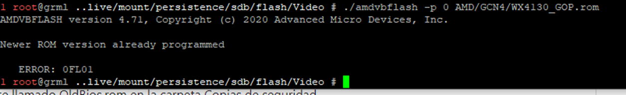

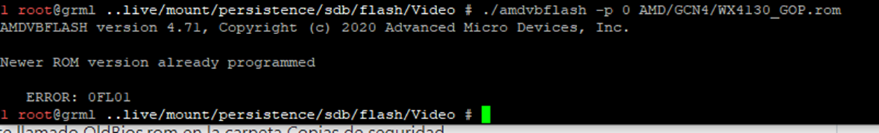

You need to additionally pass "-f" to amdvbflash in order to force flashing the VBIOS.

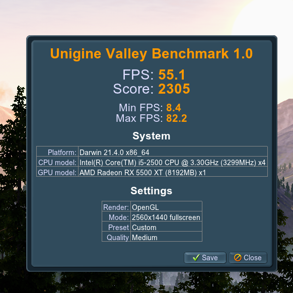

Performance RX 5500 XT:
- GeekBench Metal: > 40.000
- GeekBench OpenCL: > 40.000
- Valley: > 65 FPS, > 2729 (is more limited by GPU core and CPU frequency, not so much by resolution)
(resolution 2560x1440, quality low: 2716, medium 2703, high 2429, ultra 2157)
(resolution 1920x1080, quality low: 2729, medium 2729, high 2442, ultra 2396).
- MetalBench: 230 MRays/s
- PowerDraw: 19W idle - 95W max (observed by HWMonitor app)
I just re-ran some Valley benchmarks and without going into numbers:
Using standard settings does not utilize the card quite optimal, average power draw around 60W. But when moving on to higher settings like ultra quality and 2x or 4x or 8x AA the power draw hits on average the 75W wall while benchmark results barely drop - as visible from the list above.
Running the quite simple and short MetalBench draws 75W on average and it becomes quite clear this kind of app is better suited to get an idea of the GPU power running macOS.

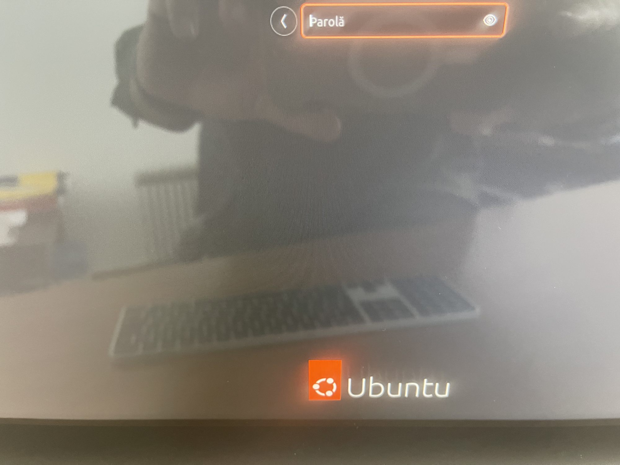

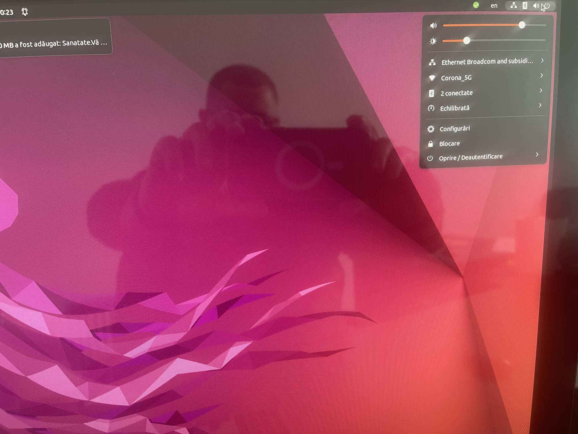

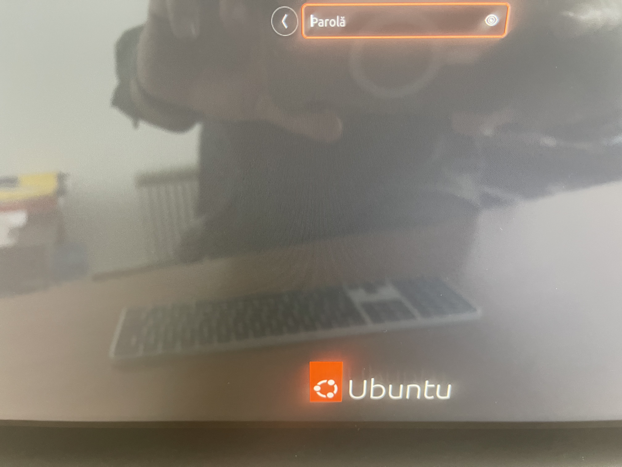

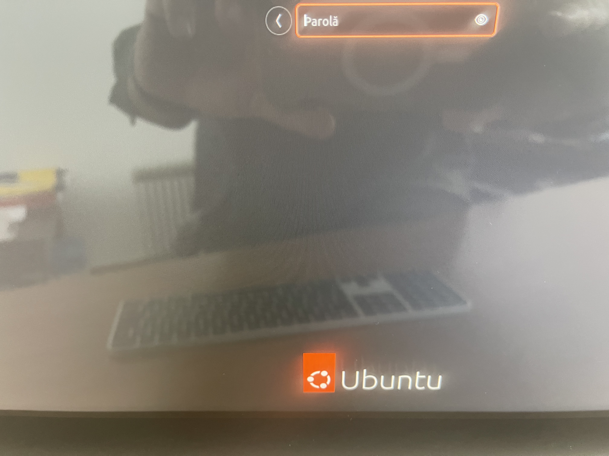

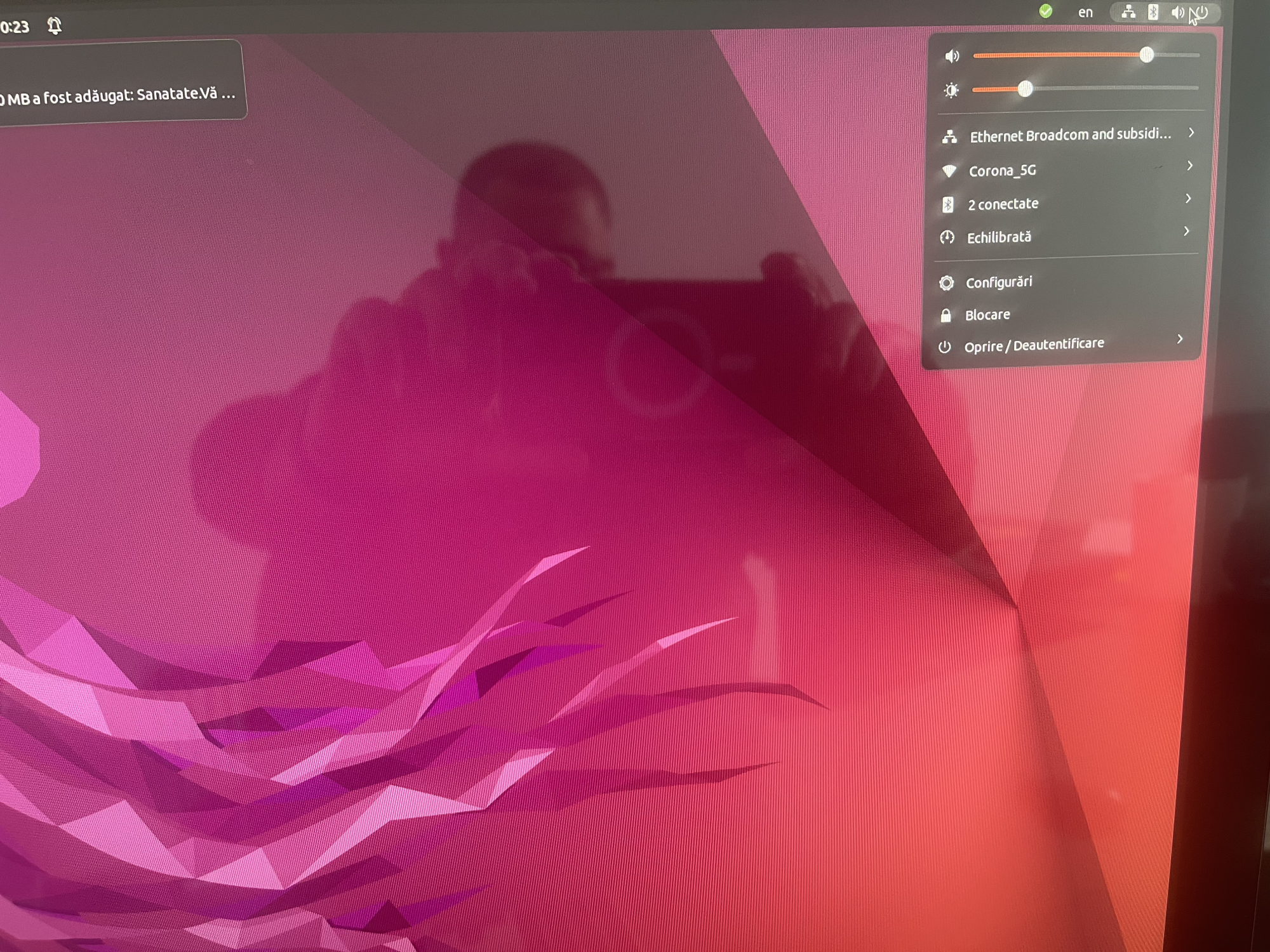

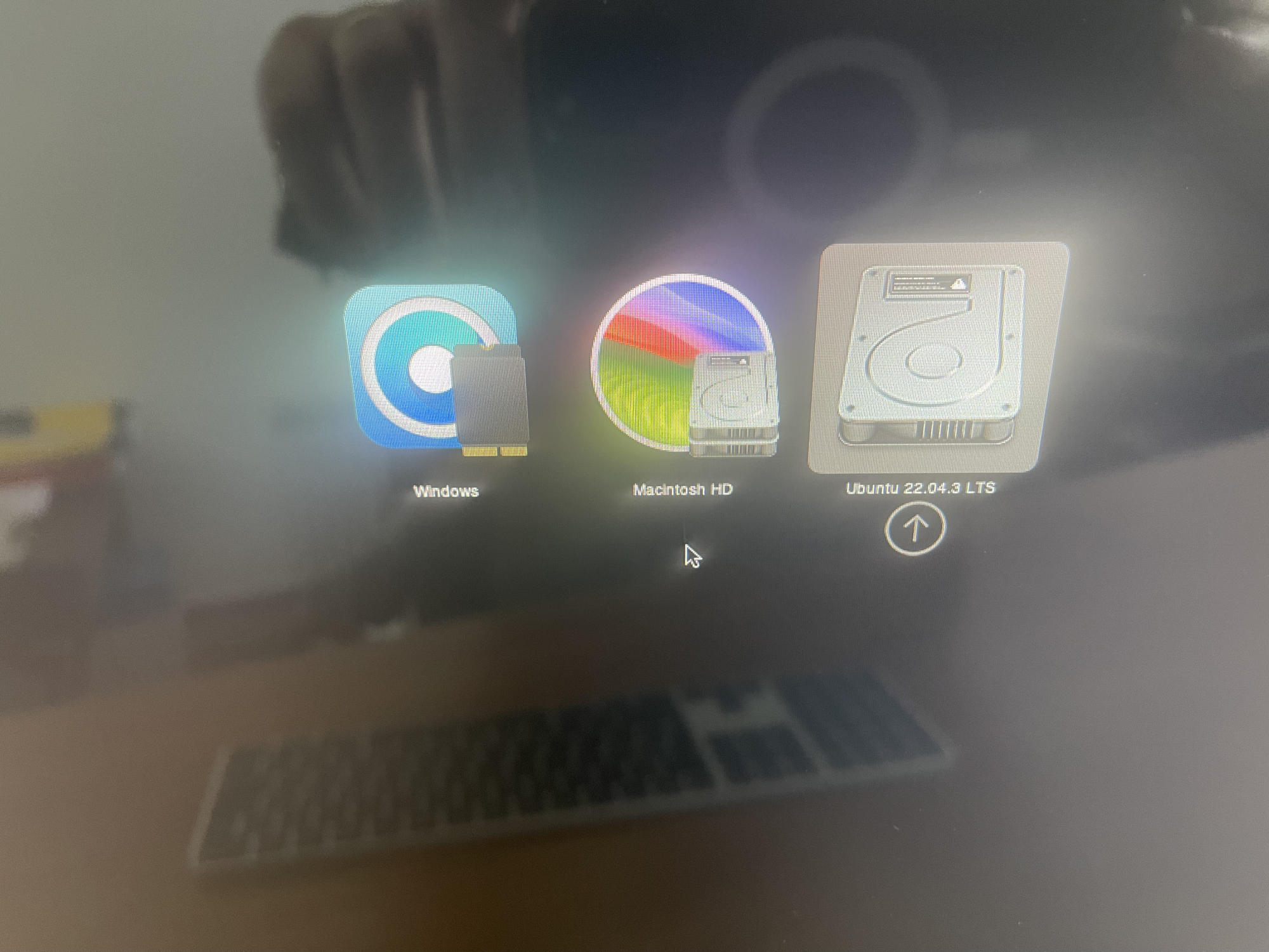

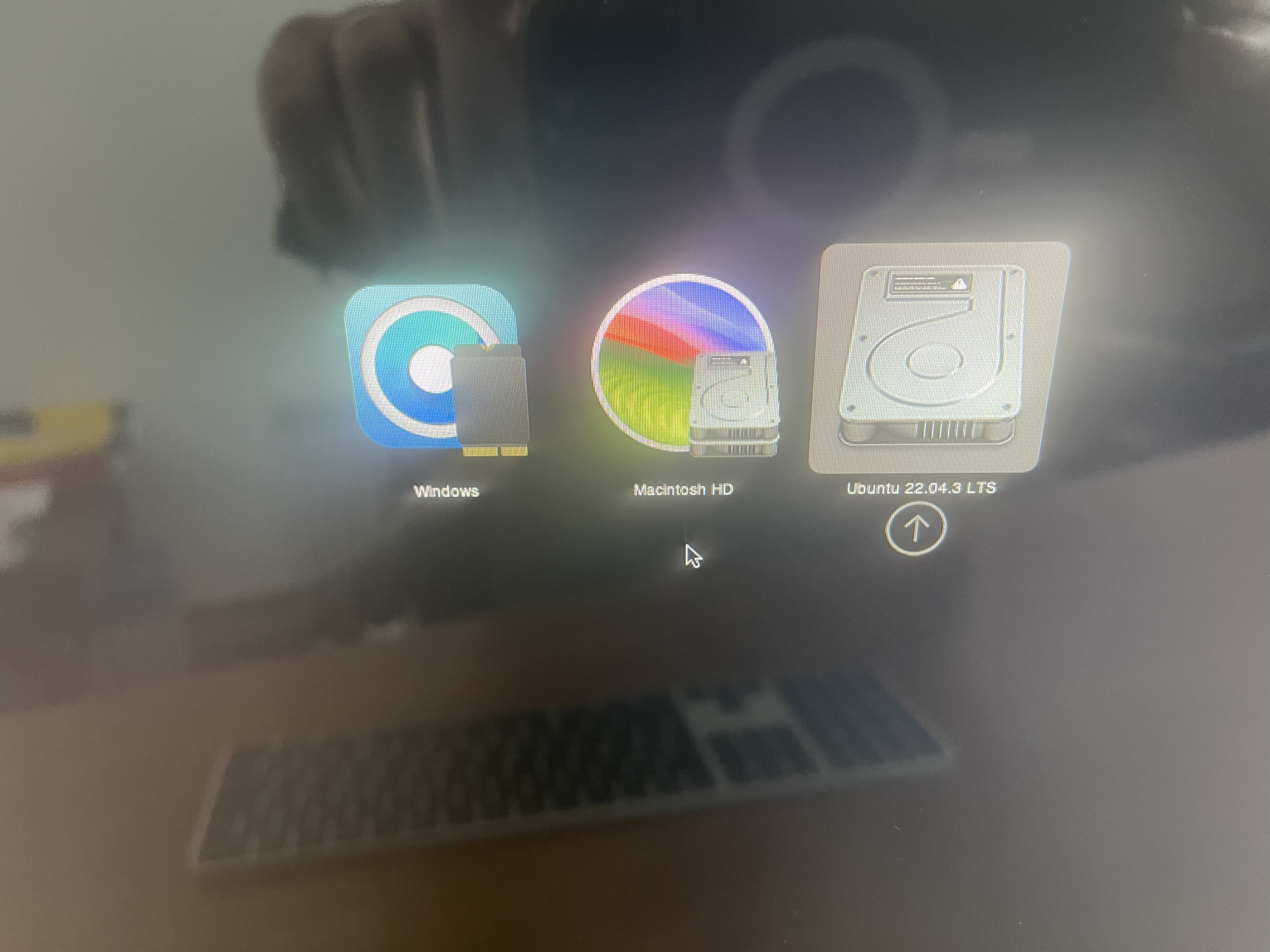

iMac 27 2011 + WX7100 Ubuntu 22.04 latest kernel.
Reactions: TheRealPorkchop

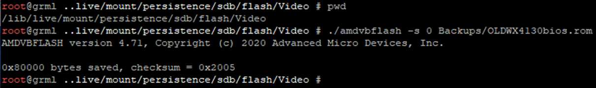

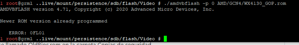

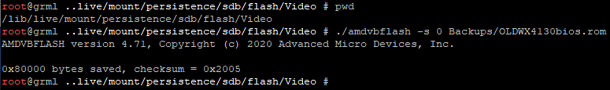

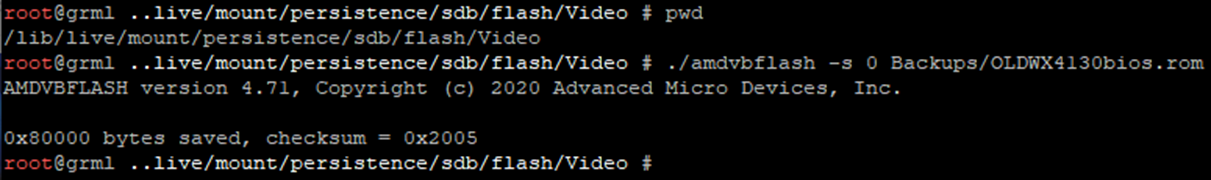

Hello everyone,
I have an iMac 27" 12.2 from 2011. I got the WX4130 and installed it. I took the copper plate from the old graphics card.
I then installed the ROM via GRML using the Flash tool. I noticed that the memory is not 2GB but 4GB?
I then started OCLP. But I saw a picture on the external and not internal screen. The main screen was also mirrored on the left and right... Could it be that there is a short circuit? I have read a lot about this in the forum. WX4150_GOP.rom was flashed.
Logs:
Old SSID: 17B0
New SSID: 0B04
Old P/N: BR20625.001
New P/N: 113-L10991-101
Old DeviceID: 67E8
New DeviceID: 67E8
Old Product Name: Dell/Compal Crane 15 BaffinM GL LE A1 GDDR5 4GB 300e/300m
New Product Name: Pegatron BaffinM GL PRO A1 GDDR5 4GB 214e/300m
Old BIOS Version: 015.050.000.001.020625
New BIOS Version: 015.050.000.001.000000
Flash type: M25P40/c
Burst size is 256
80000/80000h bytes programmed
80000/80000h bytes verified
Restart System To Complete VBIOS Update.
./amdvbflash -f -p 0 WX4150_GOP_ALT_VRAM.rom 4.12s user 1.14s system 99% cpu 5.277 total
Best regards
Hi! Looks nice, but what about process? I mean, you flash the firmware, then dropped some files into the EFI partition or something like that? I'm looking' for the clean system with only Linux, and without fuss, if possible. Because things like patches and crutches are easy to forget, and somehow after the next update you can be stuck for a long time, remembering what was there.

Did I understand correctly that the procedure is as follow
1. I install Linux with SSD wiping
2. I buy, for example, WX7100 card
3. I am flashing card with the latest GOP
4. Now I have a working Linux system with boot screen support
Is everything right? Or are there still some problems? I found this nice words: "this means you'll need OpenCore in order to have a boot picker", but isn't OpenCore just for MacOS?
My head could explode at any moment...
With Ausdauersportler's instruction, let's adjust your process a little bit. (Sorry for my ignorance previously)
I assume the below process will work.
1. Install Linux with new SSD (on a different machine)
2. Buy a preflashed AMD card WX7100. (Or buy WX7100 and flash it yourself)
3. Overwrite the Linux EFI by the original Mac OS EFI
4. Install OC EFI on the Linux SSD EFI (on a different Mac, adjust manually to match with iMac 2011 and GPU, Linux SSD in USB enclosure)
5. Install both Linux SSD and WX7100 into the iMac.
6. Now you will have iMac running Linux, with Opencore bootpicker.
Or this alternative process
1. Install Linux to a new SSD. (SSD1)
2. Move/overwrite the Linux partition from SSD1 (only Linux partition, not EFI partition) to the Mac OS SSD. (SSD 2)
3. Install Opencore EFI to the SSD 2.
4. Now install both SSD 2 and preflashed WX7100 to iMac.
