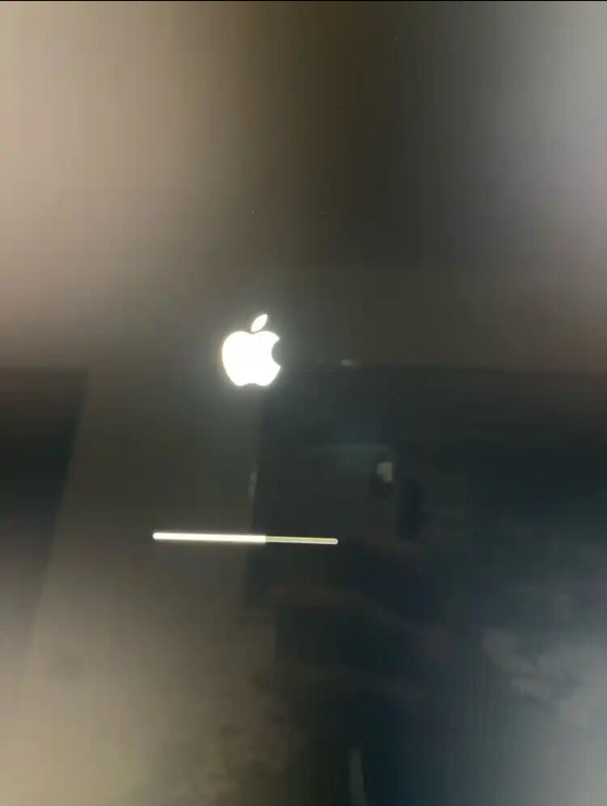

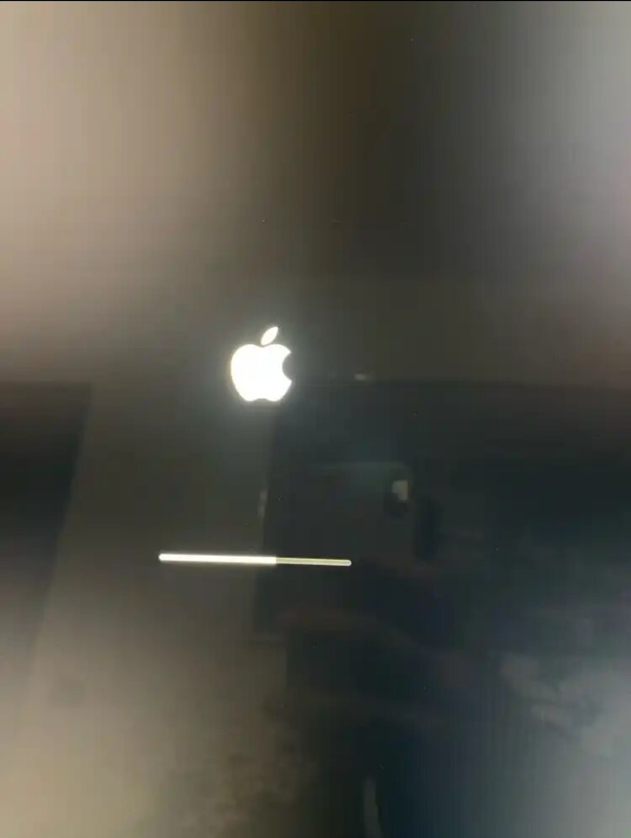

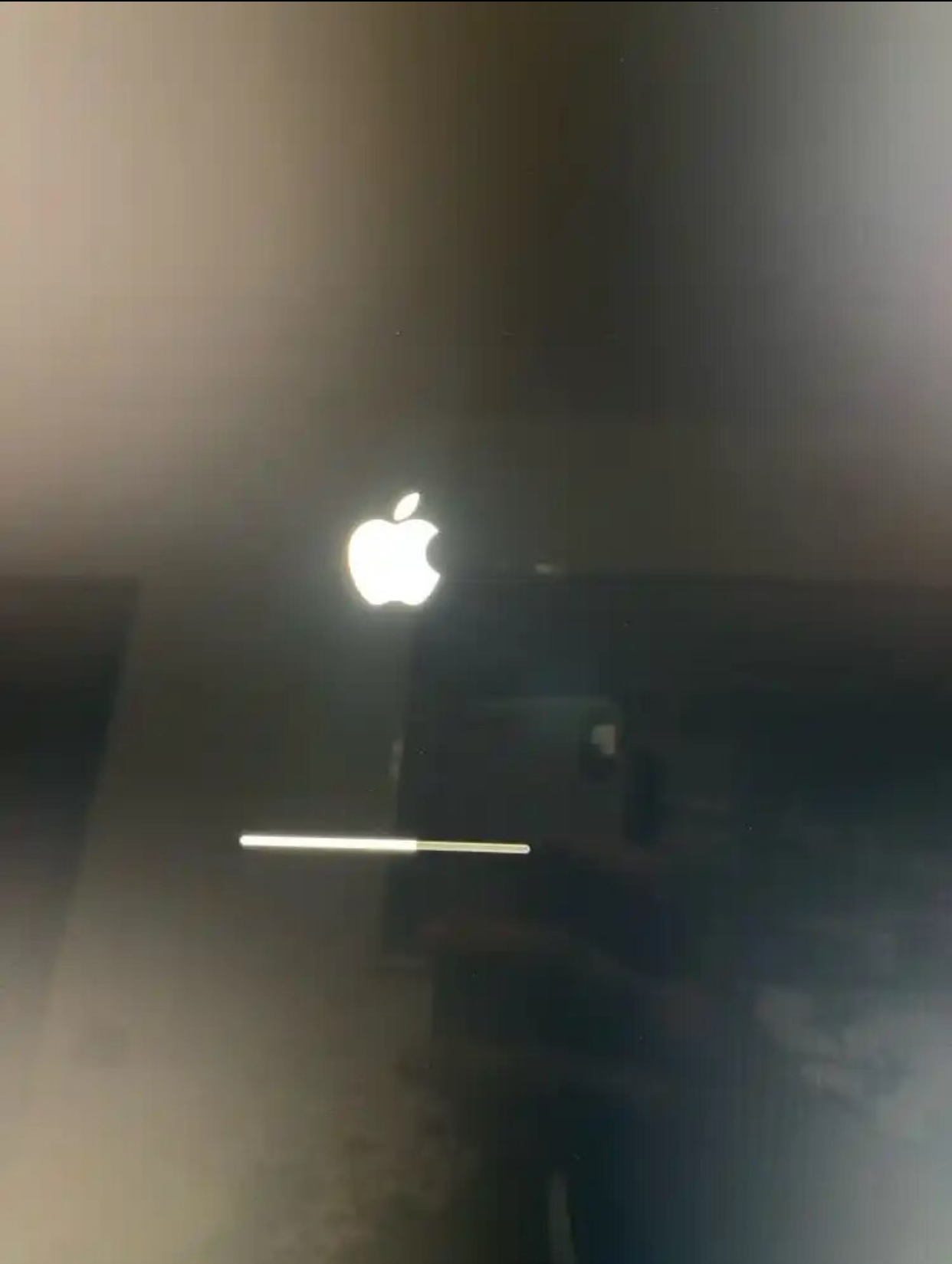

good morning, I flashed this k 1000m with high sierra without brightness it works, with any opencore even TUI, trying various configurations with and without kepler so it stops halfway. with OS and big sur usb
Catalina loader work but if i try to put opencore dmg to work brightenss imac sto the line progress
which iMac ist it? if it is a 2011 and you want to use Catalina go for the dos dude Catalina installer, it will provide working power management. If it"s a 2009 or 2010 go for open core - create the install usb (Big Sur and up to Ventura) from high Sierra- , did both successfully with a k1100m

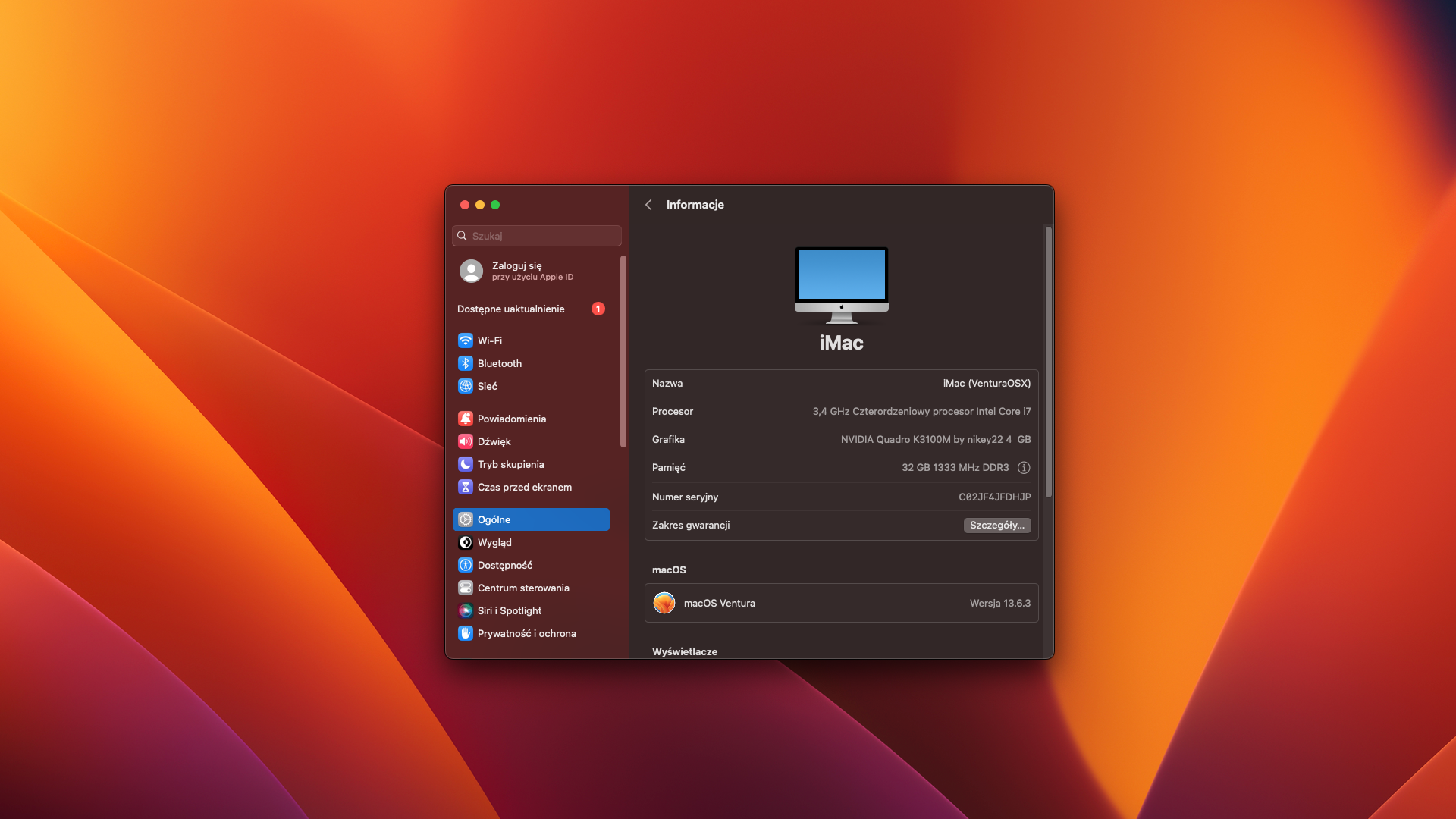

Can anyone, please, help me? i've got an iMac 27" 2011 12,2 few days ago with GTX 765M installed in it. I've tried to install macOS Big Sur using OCLP, with no luck (i've got the video, but acceleration seems to be not working at all).
Card has vbios flashed by nick[d], i was able to get it to work with clean High Sierra install, then i installed mac os catalina with catalina patcher. Tried to boot high sierra or catalina with OCLP - no luck, it just stacks, without OCLP it boots normally. Maybe i should add some args to oclp settings to get this Kepler GTX 765M work? Any advise?
