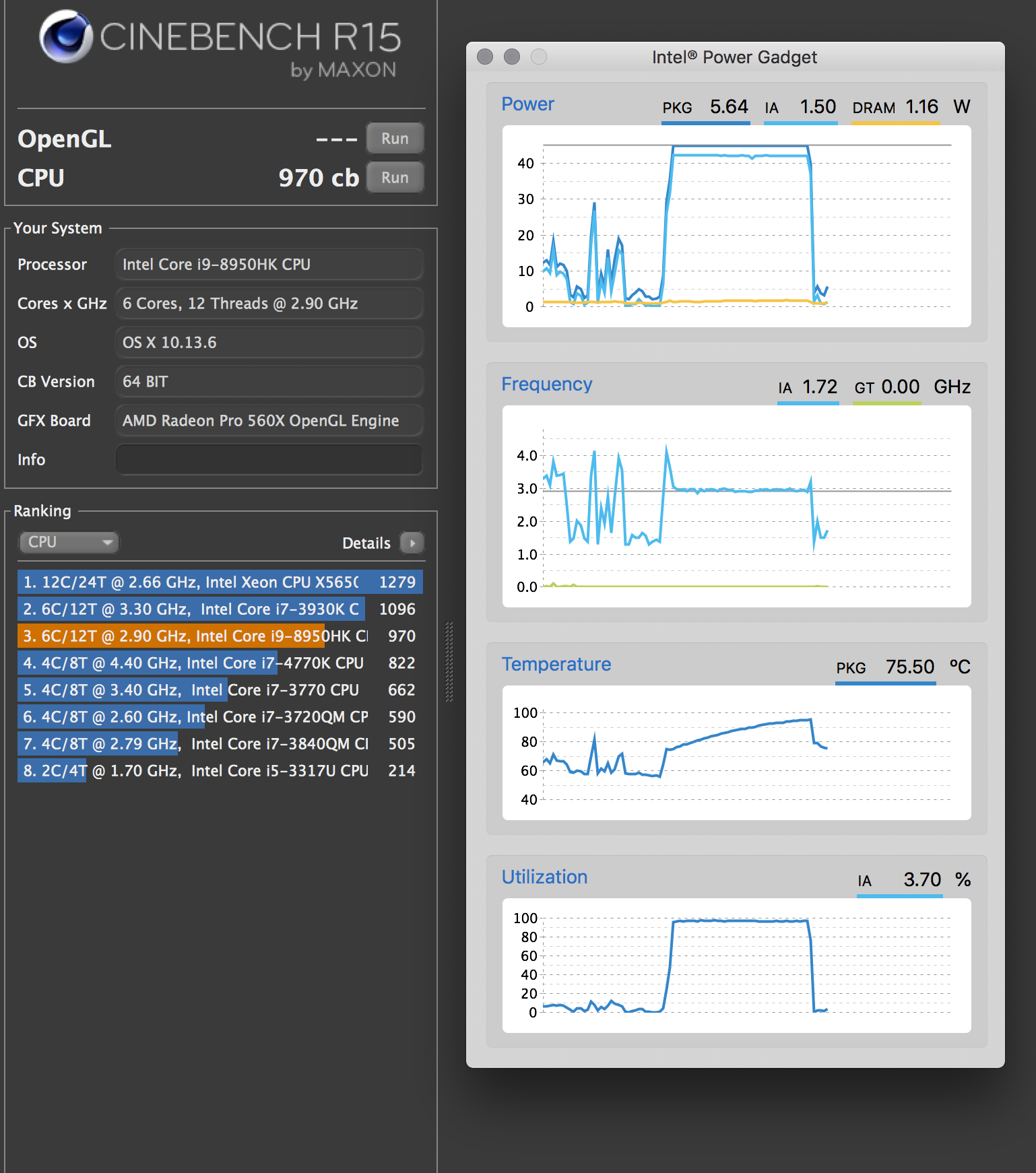

I've just tried volta and limiting TDP to 45w. It works. cinebench is now consistently scoring 1000+ on my i7 2.6
dang, that beats i9 by 100.
Makes you wonder though what performance difference it’s would make also limiting the i9 as well.

yeah, this actually makes me hopeful for i9...
if it can sustain 3.0ghz i'm okay with that.

I did the test few posts back. The i9 actually performs worse than the i7 if you use the 45W limit:
Doesn't look bad to me. That's stable 3 GHz so at least made it to base clock (0.1 GHz higher) without ramping up the fans. Try to increase the fans a little or if you have bootcamp try setting the power limit to 50W~55W. It should perform better.
I did a bunch of tests here:
https://forums.macrumors.com/thread...-throttling-discussion-merged.2127869/page-34
I can barely reach the 1000 only if I allow the boost for few seconds before the throttling kicks in, at which time I limit the wattage to 45W. Unfortunately that is all I can do with the Volta app. Fans were set to max.
I don't use Windows so Apple needs to have a firmware update in which they limit the wattage to ~55W after few seconds of >60W consumption + improve the fan responsiveness.
There is a lot of exaggeration from both sides, which mostly helps for YT clicks. But there is definitely something to be done here and Apple should listen.
