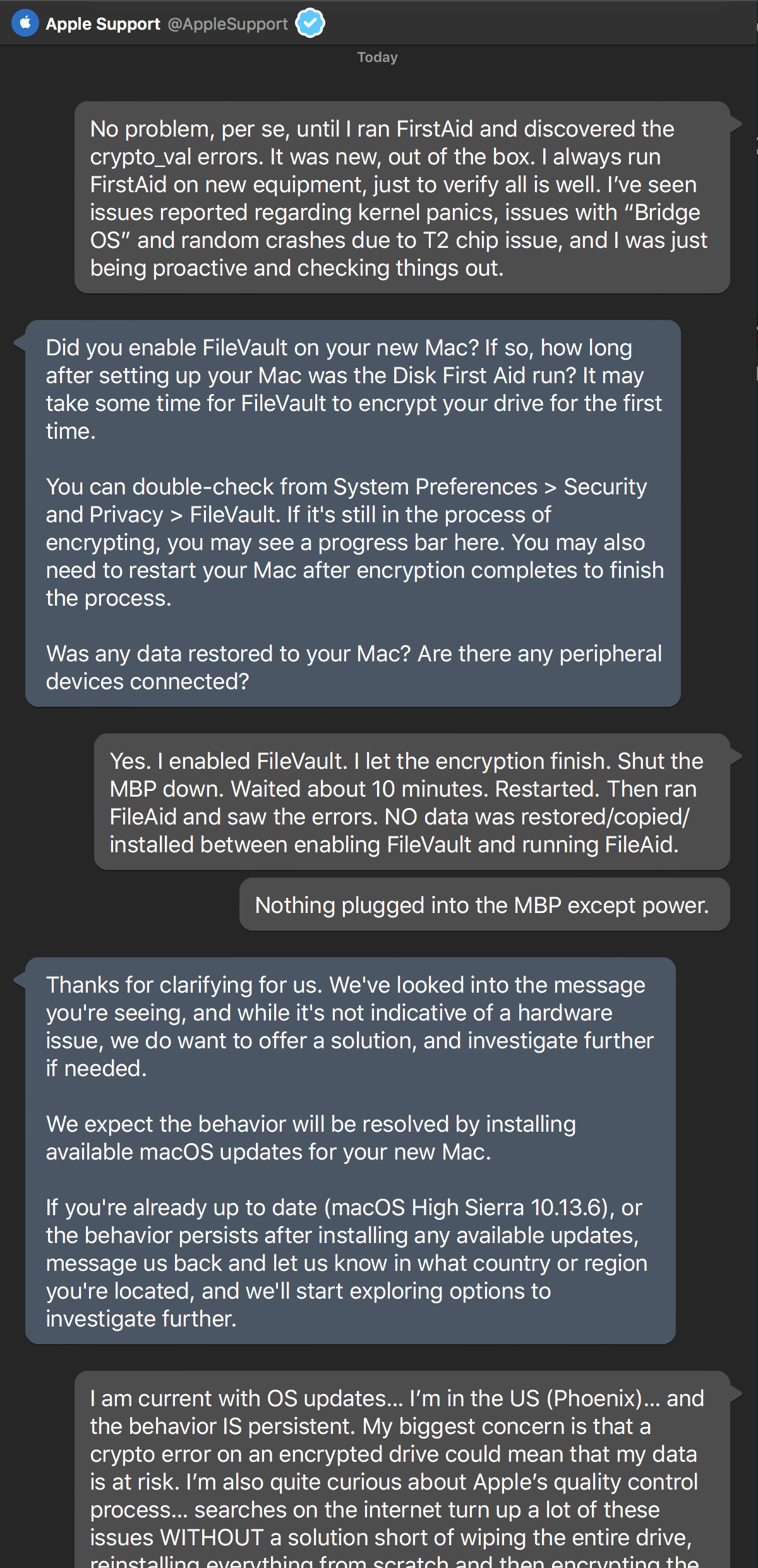

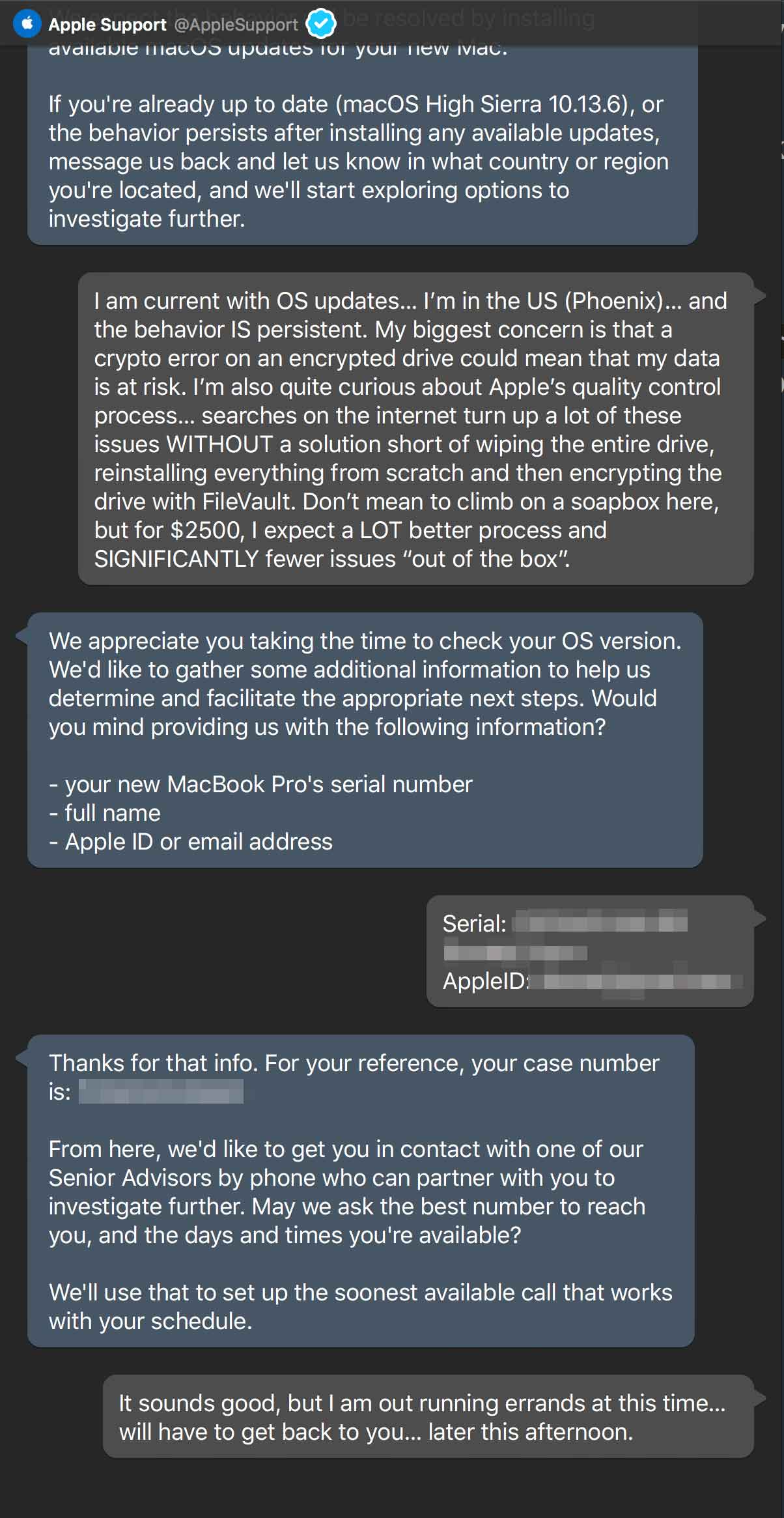

Apple support, at least the Twitter version is pretty clueless... and since I've already wiped my drive, it's pointless to follow through.

Regarding the messages, I was told the following during a chat:
...and:

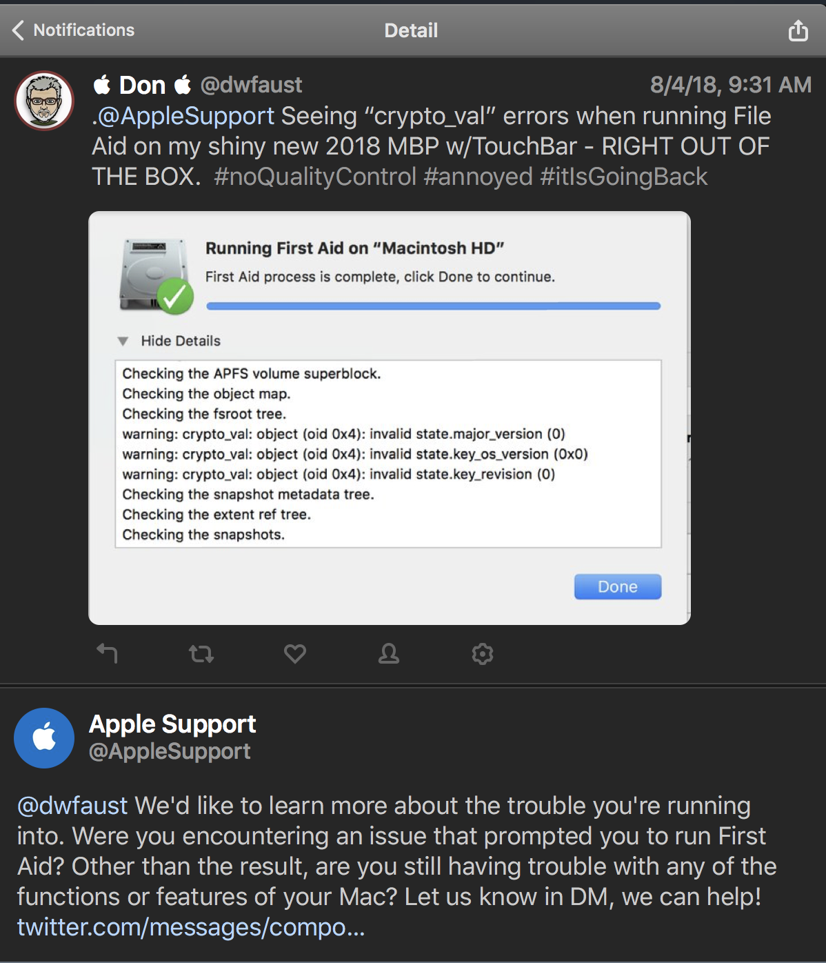

I just ran Disc Utility and First Aid and have 3 crypto-val warnings. I haven't turned file vault on and have had no restarts or any other problem with the computer. Once when listening to Pandora a text message came through and there was a brief crackle in the speaker when that occurred but otherwise nothing. I have the 15" 2.6, i7. purchased 7/15.
[doublepost=1533412738][/doublepost]
I haven't had any crashes yet. However, I ran Disk Utility and do have the following crypto_val errors:
warning: crypto_val: object (oid 0x4): invalid state.major_version (0)
warning: crypto_val: object (oid 0x4): invalid state.key_os_version (0x0)
warning: crypto_val: object (oid 0x4): invalid state.key_revision (0)
That is exactly what is on my computer.
