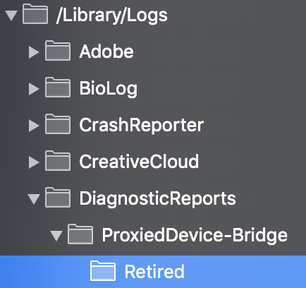

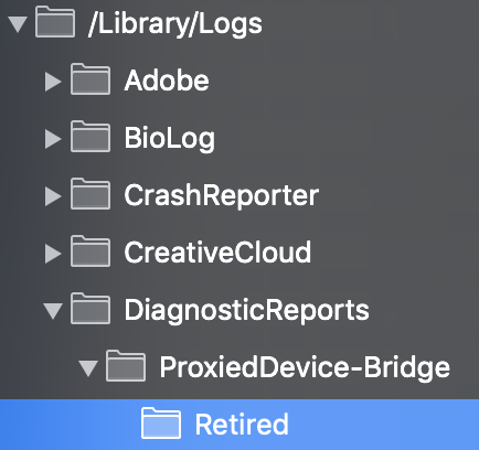

Actually, you should have got a message at startup stating your computer had to restart. You may check the Console in :
/Library/Logs > DiagnosticReports > ProxiedDevice-Bridge > Retired (picture to help)
And still, you can go days or weeks without any KP depending on how you use your Mac. For example if you never leave it with screen or drives attached nor unlock It with your  Watch, you are eliminating a lot of risk. Plus from my understanding, some KP were solved since 10.13.6 (hardware KP)
Hi!
I can get to /Library/Logs but then I don't seem to have the DiagnosticReports folder. Where else can I see logs of what happened?
EDIT: I had a typo in the path. I can get to Retired but folder is empty?

Hi!
Then you most likely haven't had any KP. Nothing yet on my exchanged base 15" model either. Crossing my fingers.
