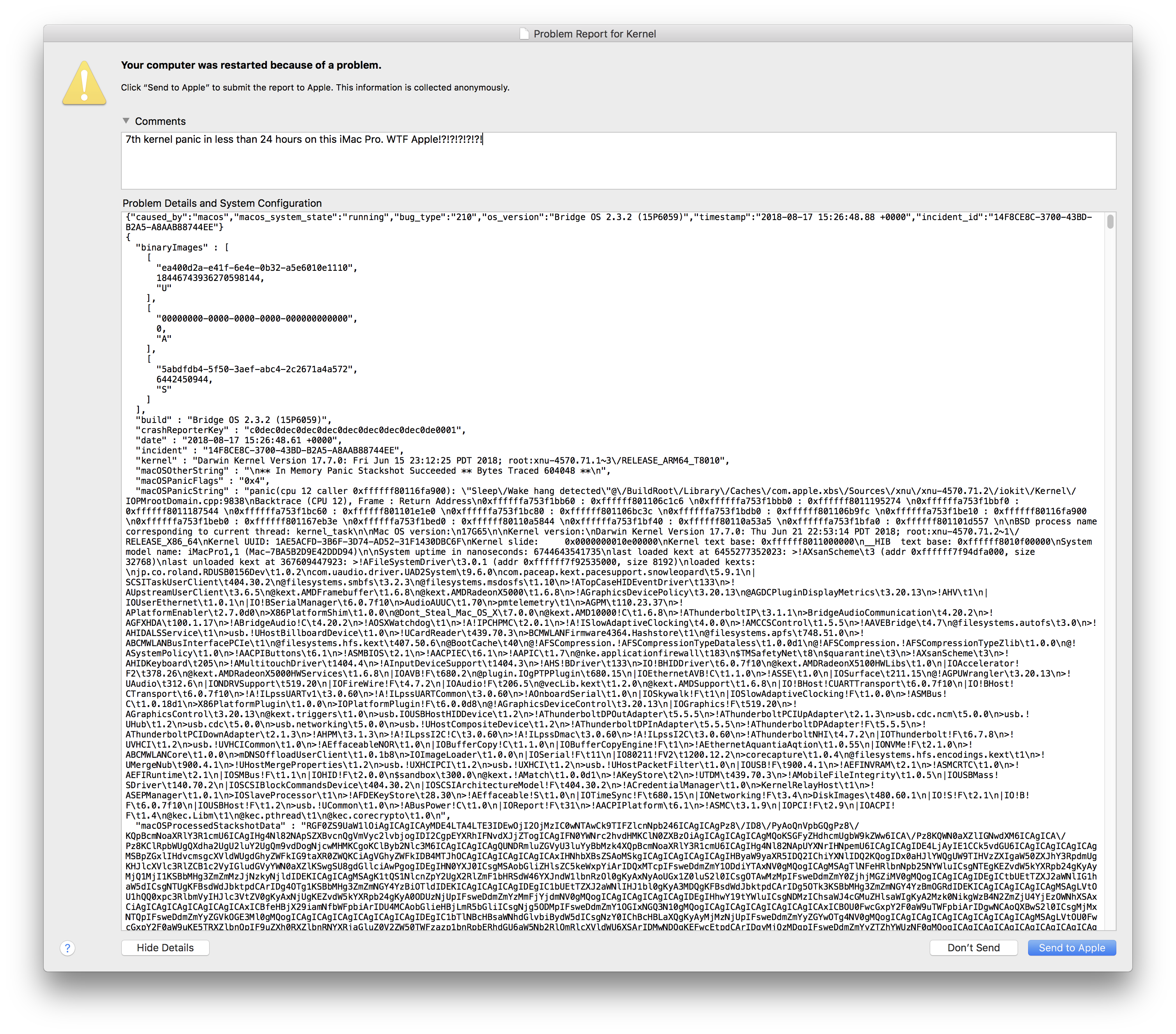

I have been studying the problems reported and have done some independent research.
I think the tell-tale aspect of the problem are the CATERR and Global Reset syndromes in the panic reports.
In my view, the problem is for Apple to update BridgeOS to handle the error signals (they have been updated) and provide extended diagnostic reporting.
Intel have a "Processor Reorder Buffer (ROB) Timeout Debug Guide". In there, they explain how a CATERR signal is sent instead of IERR or MCERR, and so system management code needs to be updated to match. They describe particular registers that characterise the nature of the problem; these should be provided to the panic code handler. They also list a good set of debug techniques for such scenarios.
