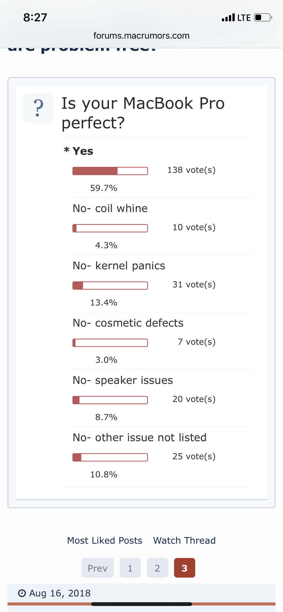

From a thread measuring
Reactions: zargap
