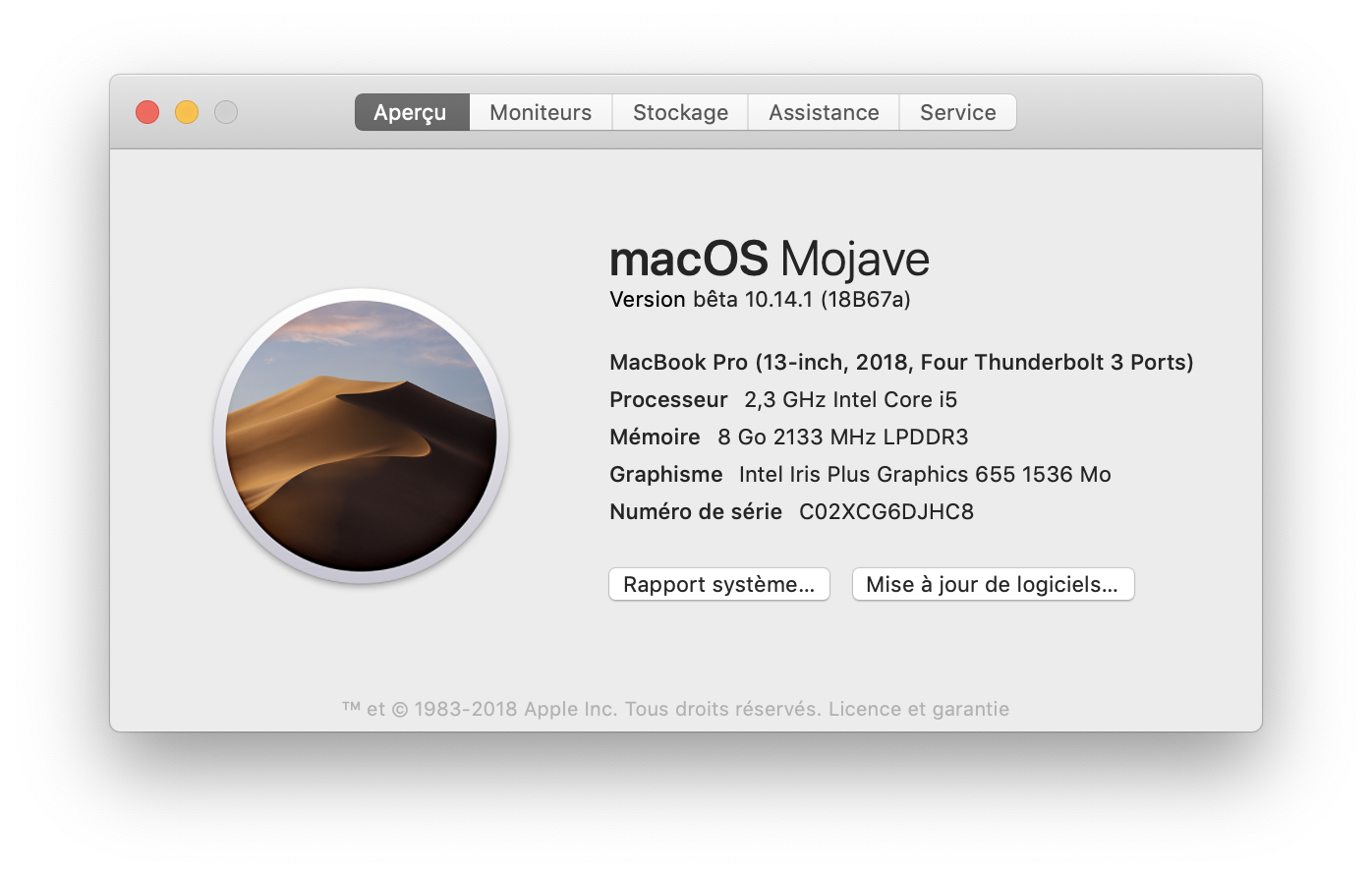

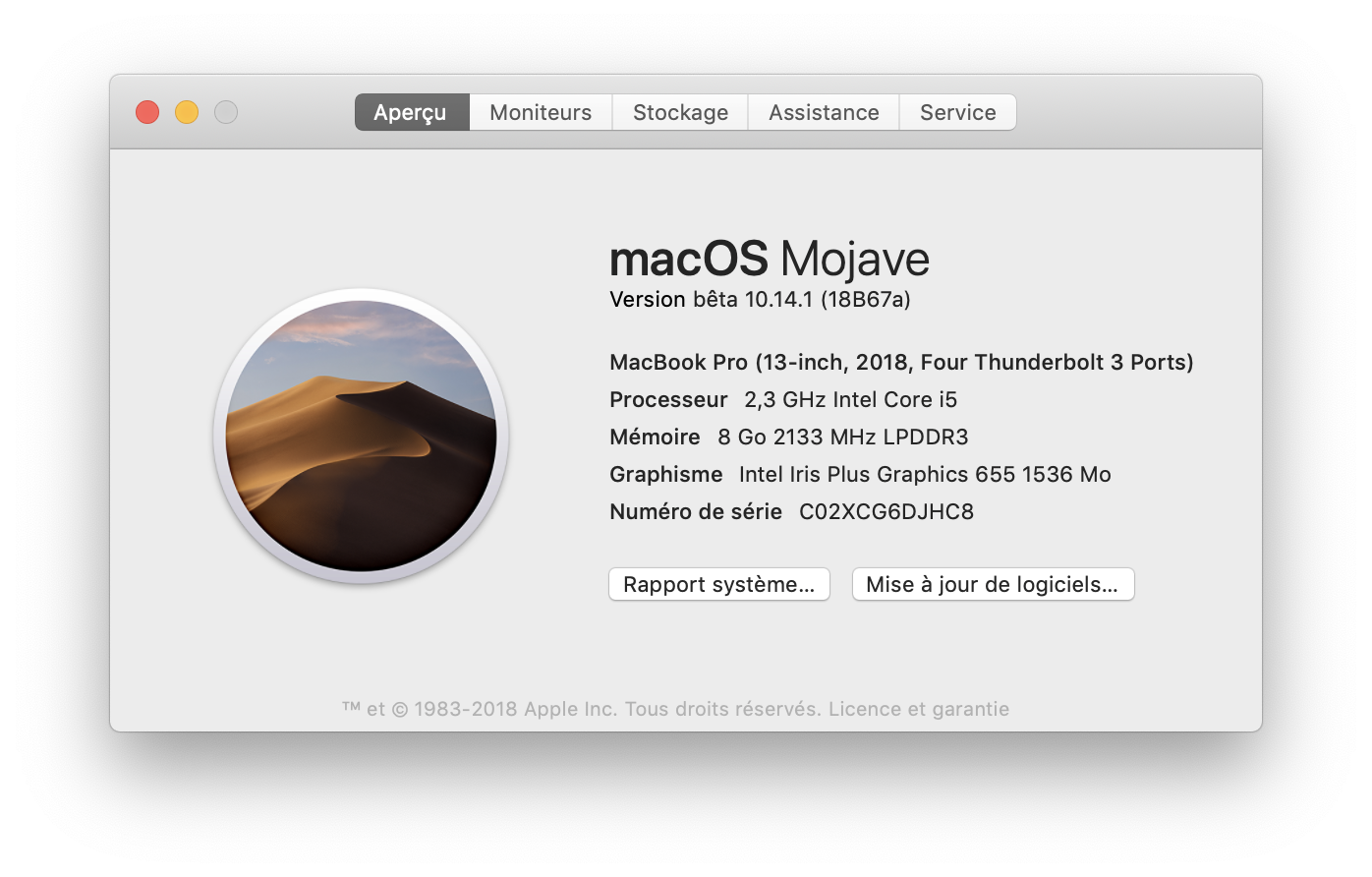

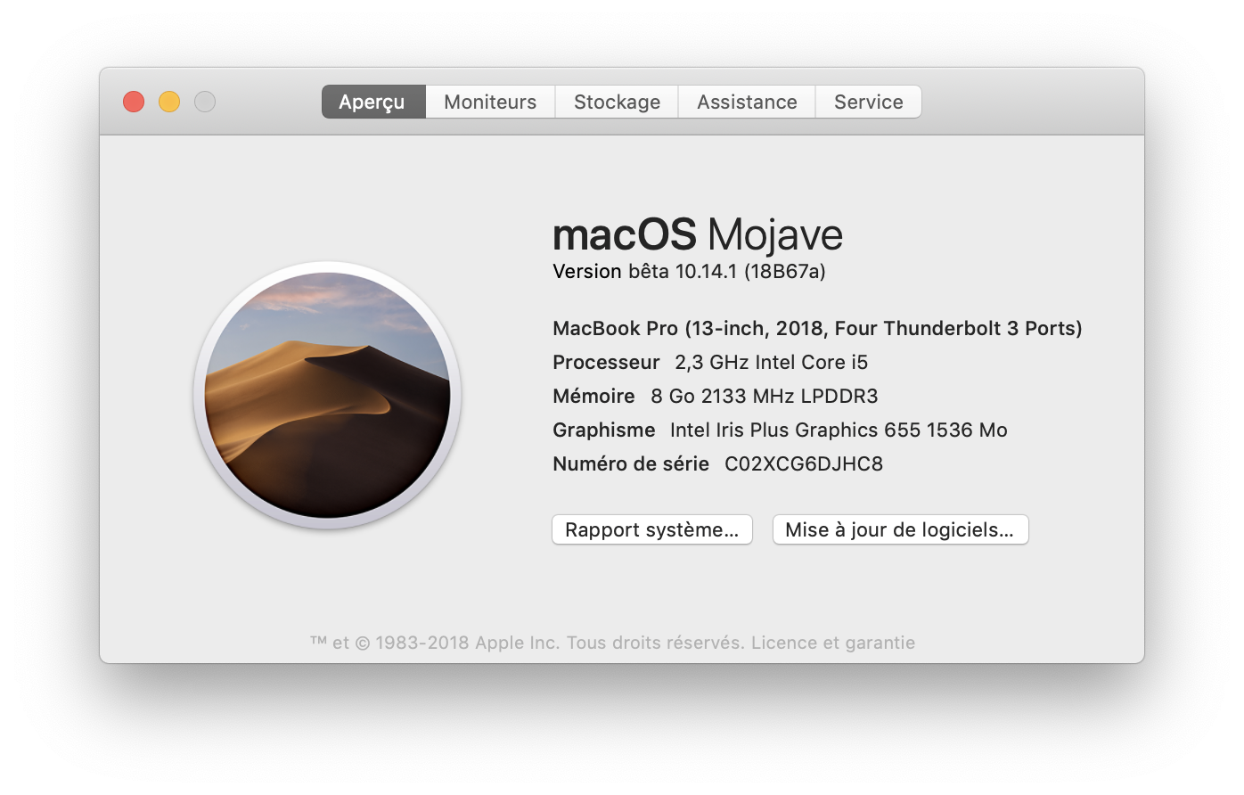

Do you mean beta 4 with 16P51061a firmware? If affirmative, then it seems Apple engineers are as confused as we are, because not getting it fixed after so many tries is telling this issue is non-obvious.
BTW, what kind of report did you get for the crash? Does it mention BridgeOS?
Here is my actual version, last beta I've got at the end of last week.
Code:
{"caused_by":"macos","macos_system_state":"running","bug_type":"210","os_version":"Bridge OS 3.0 (16P51061a)","timestamp":"2018-10-21 18:35:04.16 +0000","incident_id":"CCFECF48-59E7-480D-AAE8-ABB809DF2AC8"}
  "build" : "Bridge OS 3.0 (16P51061a)",
Here is the beginning of the crash report. Yes, BridgeOS.
Code:
This crash isn't caused by BridgeOS. It's a macOS kernel panic, you can see where it says 'caused_by'. *All* kernel panics are reported by BridgeOS now; it's how the new machines work.
So this has nothing to do with the original issue.
Apple should probably hide 'BridgeOS' in the panic log, because the fact that it says 'BridgeOS' means literally nothing. Yet it's all people see it seems.
