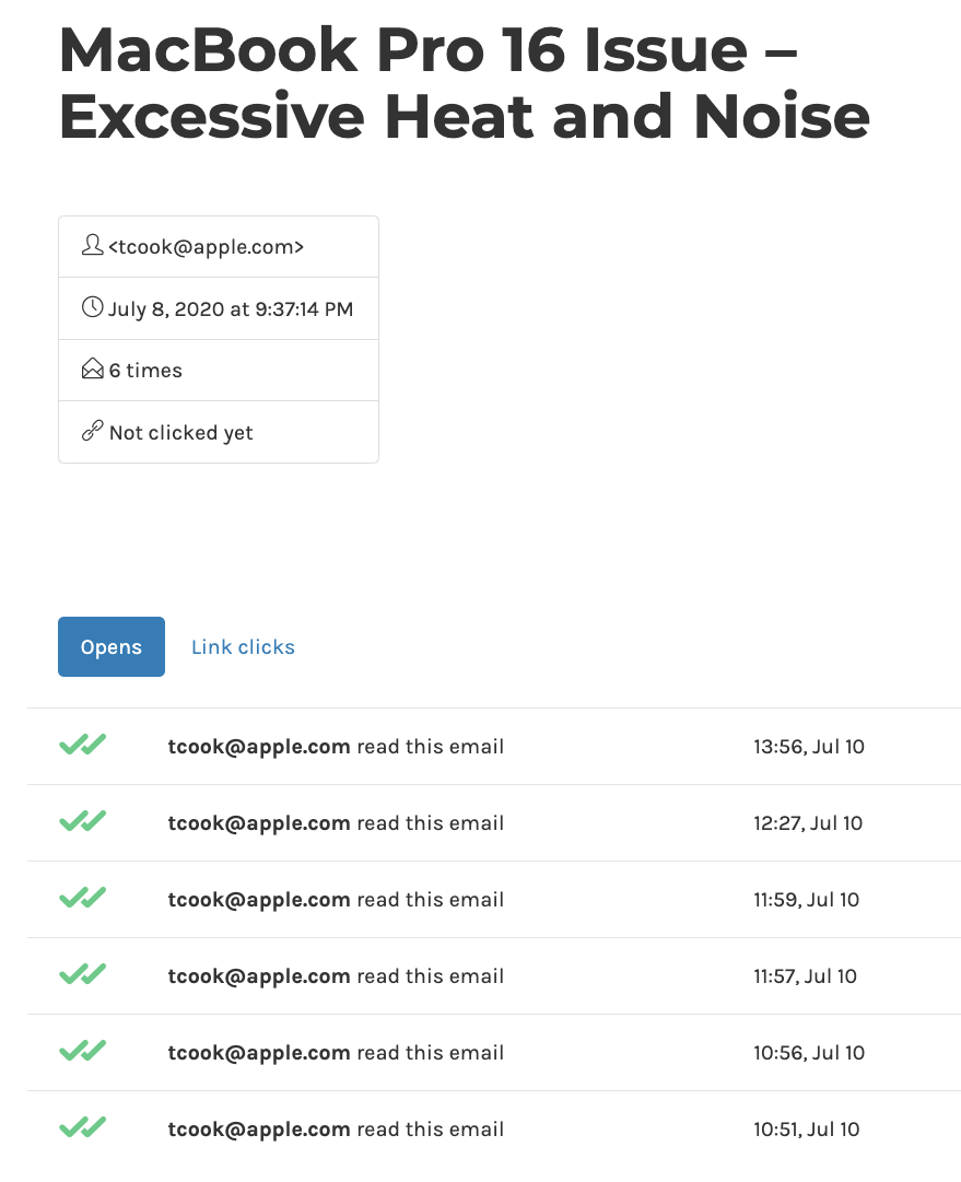

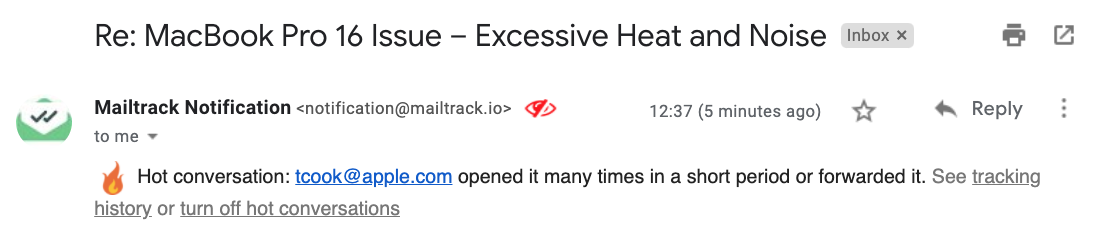

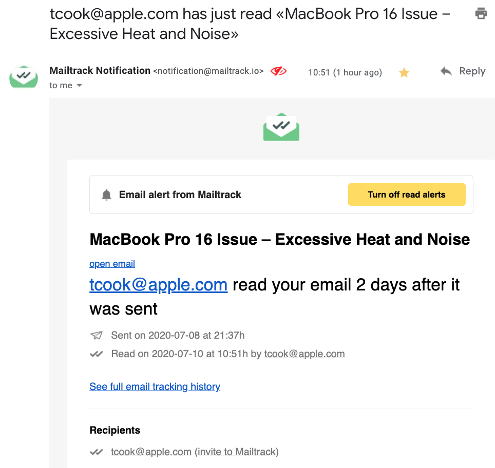

Appears that my email to Mr Tim Cook tcook@apple.com which was sent on Wednesday July 8th was opened today Friday July 10th..
..then it was forwarded on and opened several times, which categorised it as a "hot conversation". A little ironic given the topic of this thread...
..then I got a call from Apple Support around 1400 CET. He thanked me for my valuable feedback, but offered no concrete steps towards making my 2019 MacBook Pro function as well as my 2015 MacBook Pro did. It is indeed a sad day when someone has been forced to set their expectations of a $3000 new device so low that they simply want it to function at least as well as their previous 2015 device. Not better, but at least as well.
One grain of hope was that he said there may be an Apple Service Program created if enough feedback reaches Apple
Everyone needs to go leave feedback ASAP.
I sent feedback recently. Feedback is always good and sometimes you get a reply to follow up on your case.
