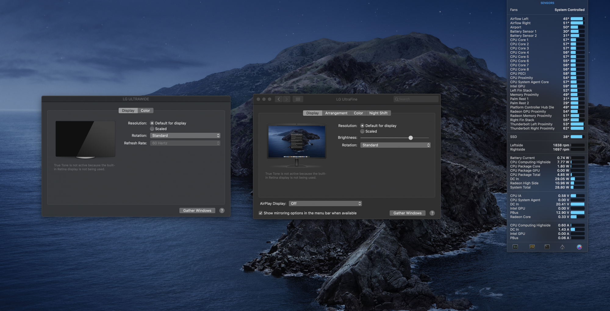

That's in line with what I saw. Single monitor in clamshell was OK. Once I added a second monitor (exactly the same brand, settings and connected the same way - displayport via a different thunderbolt bus on other side of the MBPro) the power usage jumped until I rotated one of the monitors.
Rotating both monitors caused power usage to drop also. My educated guess (as a software developer) was that the rotation was triggering a different path through the downclocking decision logic and thus maybe bypassing a bug. Others have reported better behaviour in Bootcamped Windows with exactly the same setup they had for MacOS. I never tried this myself before returning the 5500M. But it is more evidence that behaviour may be partially due to a bug in the video drivers but that said maybe the scaling behaviour in MacOS means the GPU is driven differently.
The 5600M can drive these two displays (in standard rotation) at less than 10W suggests some sort of bug also. As I type this email I'm driving the 2 x 4K displays, the internal display plus a 1920x1200 display and the 5600M power usage is under 9W. This arrangement was 24W+ on the 5500M. 5600M stats below:

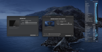

2 external monitors macbook pro in clamshell. seems ok I suppose. this is at idle. 5600m graphics

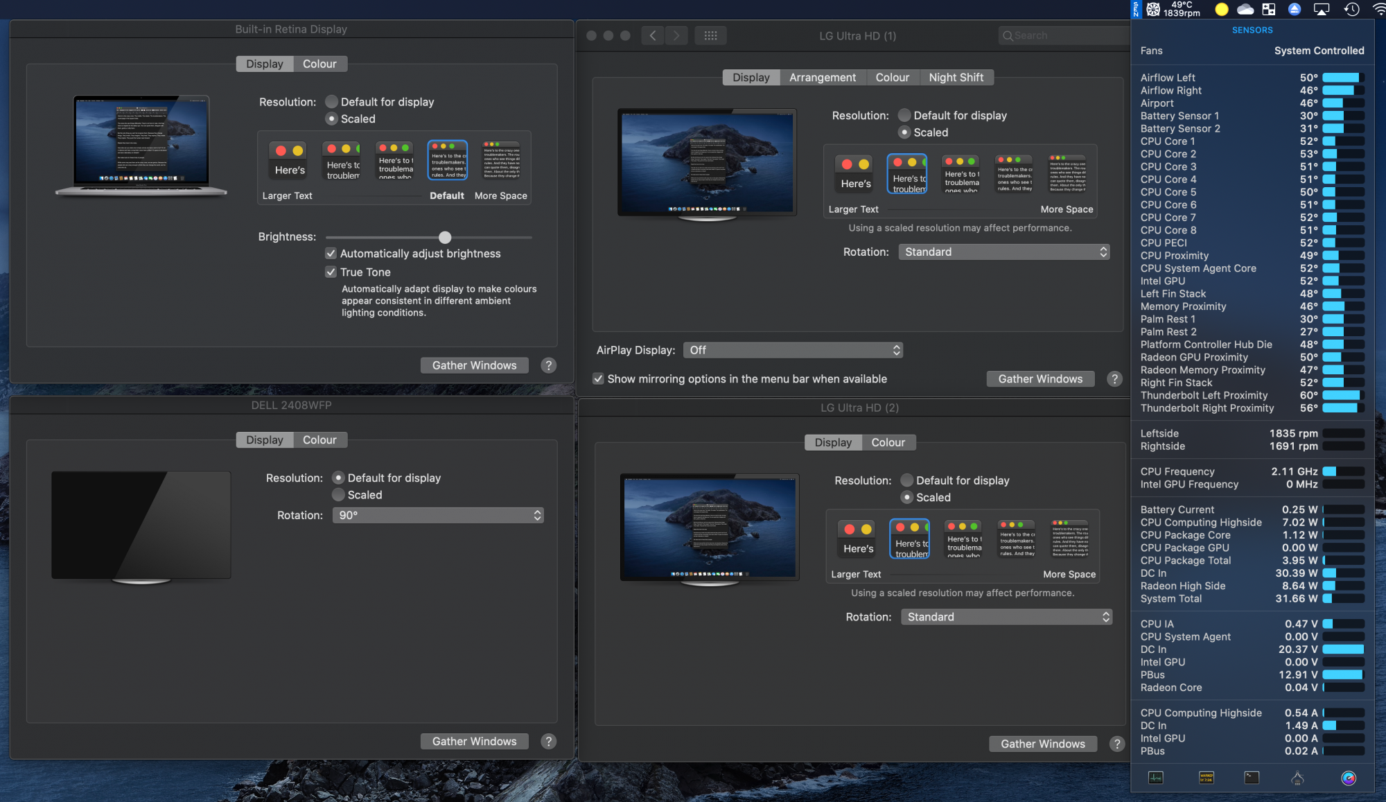

So similar figures to mine with 4 displays - so 5600M idle at full clock speed looks to be around 11W. Suggests that the HBM does make a difference as others have suggested. I agree with suggestions that hardware limitations are having an impact but I still think in some cases software issues are at play here - especially in the rotation scenario that reduces power usage.
Nice. Can you share the laptop lid open readings of Radeon wattage. Also what are the fan speeds?
For me with 5500 I am getting 9 W\1900 RPM with one 4K monitor in clamshell mode. Need to see if that shoots up if I add second monitor to 18 W\3000 RPM (currently this the reading I see with Laptop lid open and connected to 4K).
