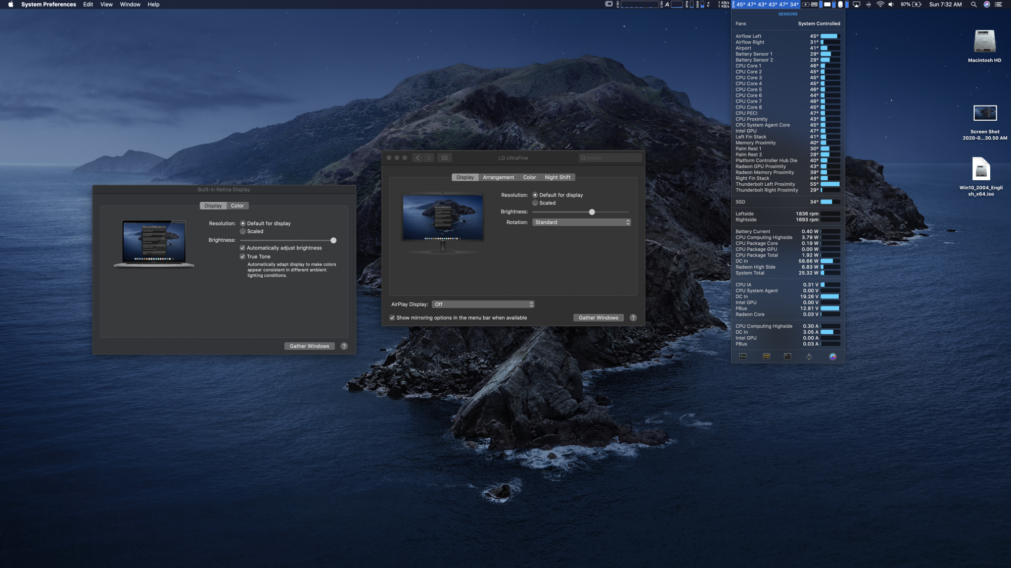

single 5k with macbook open. I took the 29 monitor off the setup. too many screens. lol

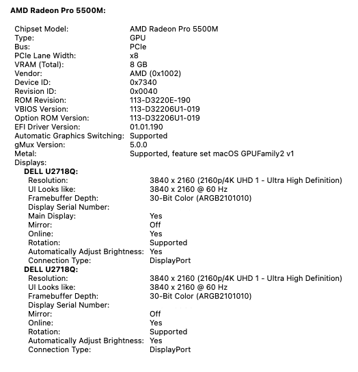

I'm not sure if it's helpful at all, but I'm seeing significant improvement (at least so far) when using a fresh/clean install of MacOS Big Sur Beta 2. I was previously using Catalina and experiencing the same problem discussed in this thread. I also had issues when upgrading to Big Sur Beta 2 from a previous Catalina install.
My config:
  • MBP 16,1 (2019 16") - i9 2.3/64GB/Radeon 5500m 8GB
  • Running in clamshell mode
  • Caldigit TS3+ dock
  • Dual Dell U2718Q monitors
    • One connected via dock's built in DisplayPort
    • One connected the dock's Thunderbolt port via USB-C to DisplayPort adapter

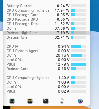

What is the result with using the lid open + 1 external monitor?
High (19.43 watts). Doesn't seem to make any meaningful difference if the monitor is connected through the dock or with the USB-C adapter connected right to the computer.
