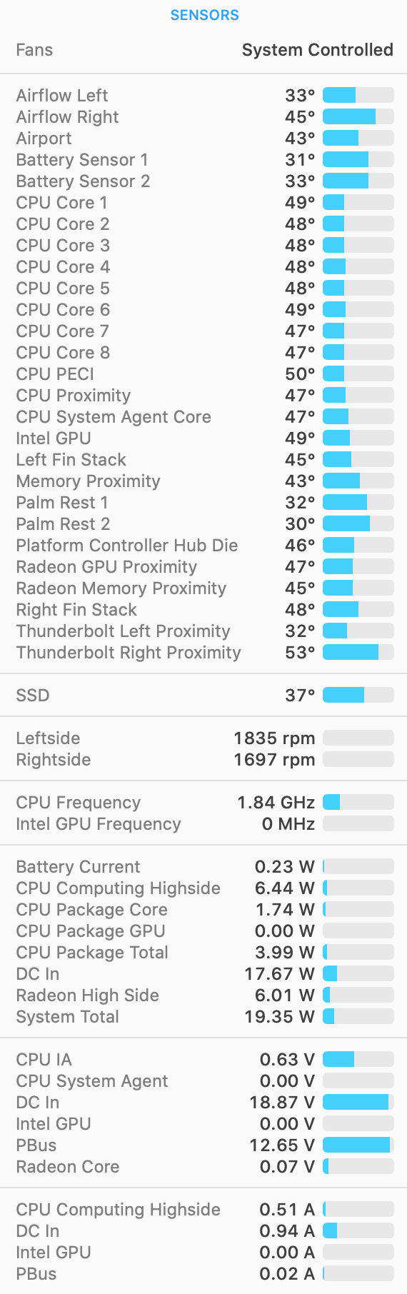

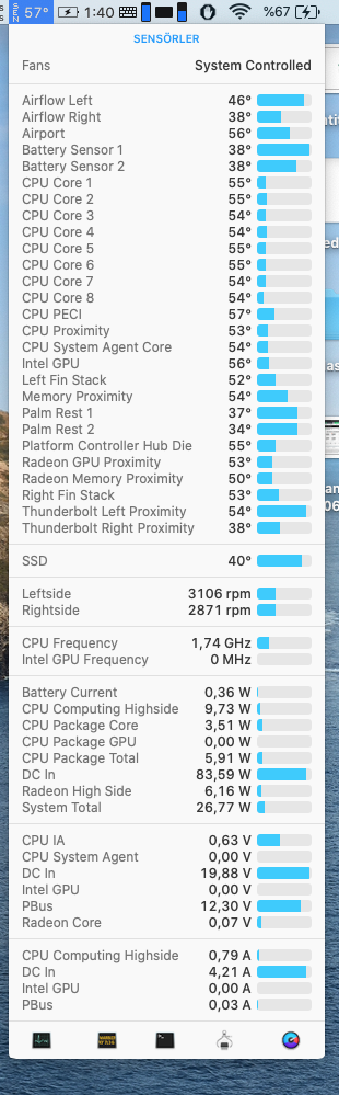

hello,yesterday i received my 16”mbp i9 2.4 64gb with 5600m.Its connected to my 27"asus 2k 60hz monitor , i see fans idling around 3200 rpms and it bothers me.As i read the 5600m shouldnt have this problem.Any ideas?
hello,yesterday i received my 16”mbp i9 2.4 64gb with 5600m.Its connected to my 27"asus 2k 60hz monitor , i see fans idling around 3200 rpms and it bothers me.As i read the 5600m shouldnt have this problem.Any ideas?View attachment 954974
Radeon High Side wattage is normal, and so is everything else. I'd suggest you keep using it, perhaps it's still doing housekeeping tasks like analyzing photos for duplicates/faces.
You could check Activity Monitor > CPU > View > All Processes. There may be some processes going on with double digit %. It will very likely settle down over the coming few hours/days, just let them run. Note that it's a bit of a Schrödinger's cat situation: when you start looking, the processes disappear. They're designed to run when the computer is idle. Result: Fans can run at 3000 RPM during idle. That is to be expected.
You've already verified that there's no dGPU excess wattage via this screen shot, so if I were you, I'd uninstall iStat and stop worrying. Don't mess with the fan profiles. Just wait and let it do its thing. Then check back in a week. :)
Reactions: nameste

Sure, no excess wattage, but his fans are still spinning too fast.

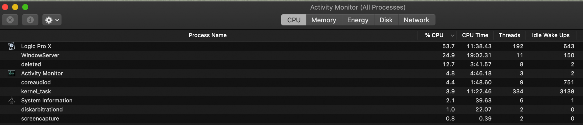

So you're saying - when you restart the machine, the fans come on and stay on, even when you don't start anything? If that's the case, start Activity Monitor, go to CPU, and sort by CPU % - to try and find out what's causing that.
As far as processes to look for, it depends what you have installed / running, but look for what's consuming a high CPU percentage in Activity Monitor.
I'm using two 4k LG monitors (with a CalDigit TS3+ dock) and my laptop in clamshell mode. Both monitors at 3360x1890 - and the machine is silent with Safari, even with running a ubuntu VM in Parallels. Anyway, I opened Logic up, ran a small project with 4 VSTs (a Keyscape piano, emotional Violin/Viola/Cello), and playing 12 bars on cycle repeat for the past 15-20 min (non are frozen/bounced), and just two strips with stock reverb/eq -
The fans sounded as soon as I opened Logic, and I'm guessing are now around 1-2 levels bellow max volume..probably high 3000-low to mid 4000 rpm if I had to guess (I deleted iStat and don't want to get drawn back in to stat watching)).

Heres my activity monitor during cycle repeat if you want to compare:

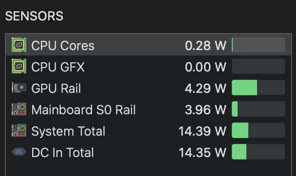

I got my i7 5600M model today. After install latest version of iStat Menu, it shows only one temperature sensor for the SSD. Not sure why. Emailed technical support.

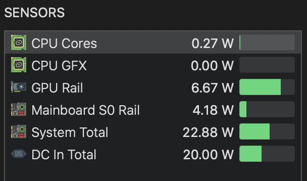

I installed Temp Monitor, and it shows GPU power 6.7W for internal + LG5k, and 4.3W for LG5k only in clamshell mode.

Yeah, fan speed at minimum (below 2000) when system is idle or light tasks. When dropbox sync a lot of files, it can still runs very hot.
I also tested with 2 external monitor, Dell ultra wide 38" plus Old mac 2560x1440, GPU power 7.5W.
So 5600M works as expected.
The one I returned with i9 and 5500M 8GB, GPU will run at 18-20W (and fan speed >3k) when open cover and connect to an external monitor.
