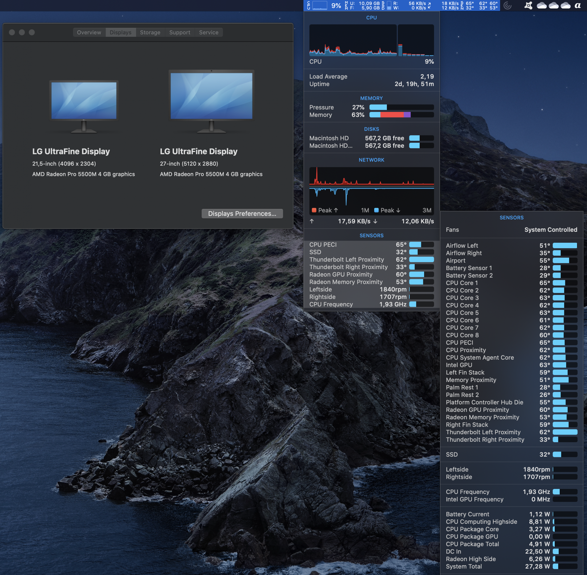

Having experienced the issue for a while, with any scenario including more than one monitor (external+internal, or two external in clamshell) this morning, with both a LG Ultrafine 5K and a 4K plugged into the left TB ports, laptop closed, it is reporting low (normal) wattage on Radeon high side. Weirdly, I normally do not get picture on both monitors if connected to the same side, but somehow this approach works now... I would be very interested in hearing if anyone else found the same.

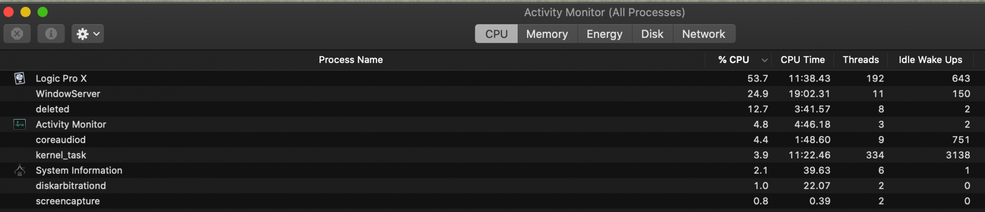

I'm using two 4k LG monitors (with a CalDigit TS3+ dock) and my laptop in clamshell mode. Both monitors at 3360x1890 - and the machine is silent with Safari, even with running a ubuntu VM in Parallels. Anyway, I opened Logic up, ran a small project with 4 VSTs (a Keyscape piano, emotional Violin/Viola/Cello), and playing 12 bars on cycle repeat for the past 15-20 min (non are frozen/bounced), and just two strips with stock reverb/eq -
The fans sounded as soon as I opened Logic, and I'm guessing are now around 1-2 levels bellow max volume..probably high 3000-low to mid 4000 rpm if I had to guess (I deleted iStat and don't want to get drawn back in to stat watching)).
To be honest, I think this performance on a laptop of this size / spec is great.
Heres my activity monitor during cycle repeat if you want to compare:
It is hit or miss...2/3rds of the time the fans come on at midspeed (2-4k) at startup. AS SOON as I open Logic, regardless of the project, they ramp up to 4.5-full speed and the machine becomes warm/very warm to the touch. Yes, the machine is fast. But this is not ideal behavior at all.

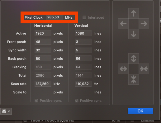

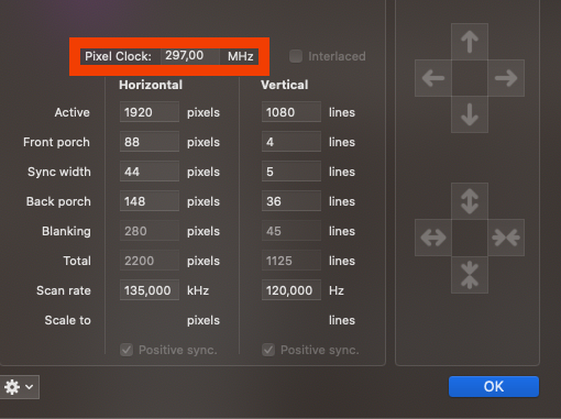

My results and theory:
17W usage with 1080p @ 144hz, 120hz, 100hz
5W usage with 1080p @ 60hz, 50hz
I have some experience with settings up custom timings for monitors with CRU on windows so I thought I'd give SwitcherResX a try on Mac and for some reason my monitors EDID is reporting two seperate 120hz timings at 1080p. The second one set my usage to 5W.
It seems to be linked to the total "pixel clock", here are the two 120hz timings for comparison:
17W
5W

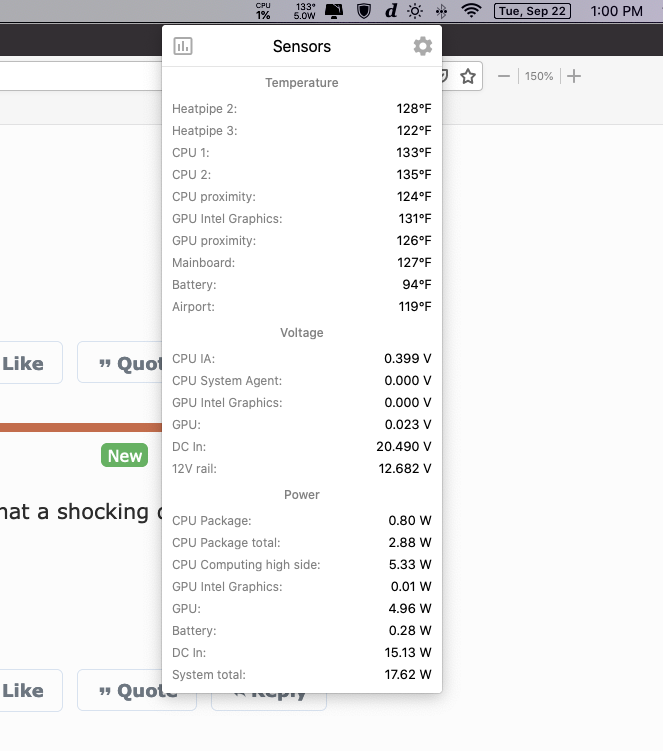

Hello all, I've been keeping up with this thread since March when I was trying out a Dell U2720Q with my MBP. I ended up returning that monitor due to the same issues all of you have been having. Recently, I tried out a different monitor with much better results. Do note that I am using this only in clamshell mode.
Specs: 2019 16" Macbook Pro, 2.3 GHz, 32 GB RAM, 5500M 8 GB
Monitor: ASUS PA278QV
Cable: USB-C to Displayport (by Uni)
Resolution: 2K native
*If you do go with this monitor, you will have to run this at the monitor's native resolution and set the refresh rate to 75 Hz*
These results are with one Youtube tab in the background (for music) and another with this forum. Current temperature in my city is 82 F.
Internal temps: 133 F
Radeon High End: 5 W
Of course this isn't a solution, but I thought I'd share my results just in case anyone really needs an external monitor while working at home.
Cheers!
Also, here is a link to the Stats app I'm using: https://github.com/exelban/stats
Reactions: mcnuggetswithcheese
