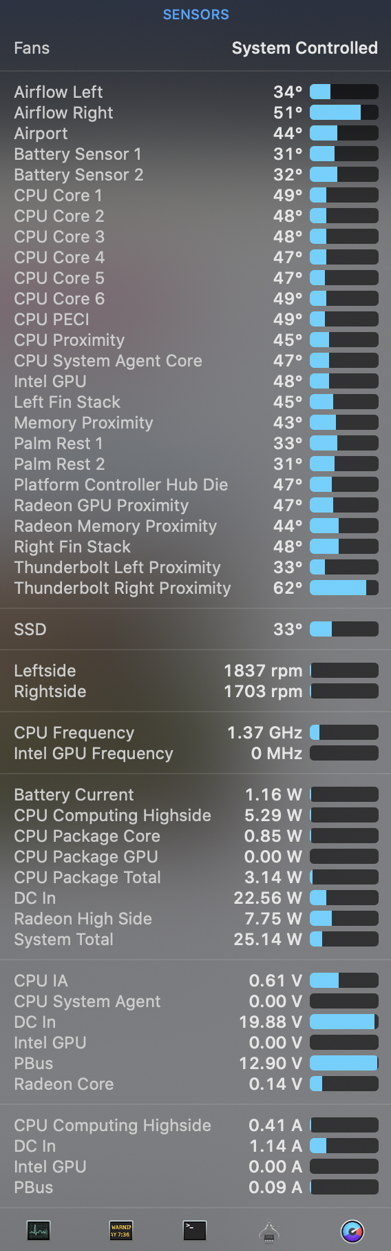

Internal monitor plus LG5k connected to the right port at idle:

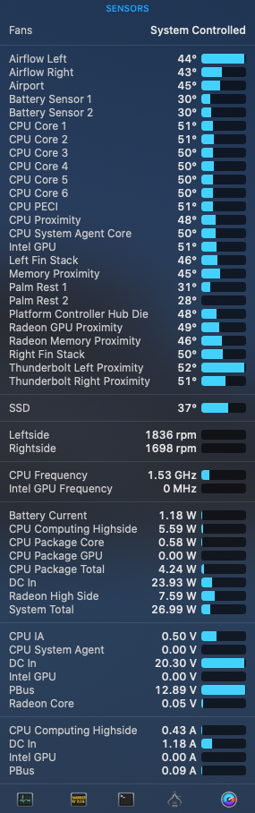

Internal monitor plus Dell lU3818DW on the right, and Apple LED Cinema Display (27 inch) to the left through a docking at idle:
I do noticed that Thunderbolt is the hot spot when connect to 5k monitor.

Right, my i7 5600M stay cool at normal use.
How many hours did you use your MBP at idle before making those screenshots?
