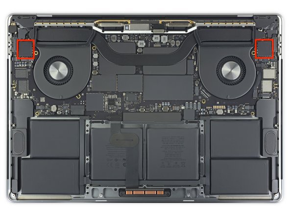

Also have a look at your (Left) TB3 Controller. Those Intel JHL7540 are rated for up to 65°C. It's already at 62°C here.
I also did some testing around this and the TB3 controller heat can also let the fans spin up. CPU and GPU (while having 18+W power consumption) where not hot enough to kick in the fans (in my tests). When under higher load (without external monitor) both CPU and GPU can go way hotter before the fans actually spin up. Plugging in an external monitor lets the TB3 controller's heat jump up to nearly 60°C in a short time.
Keep in mind that Apple routes almost everything through these chips: Thunderbolt, DisplayPort, (probably also USB-C) and power delivery. They're not connected to the heatsink and also have nothing that helps it to dissipate heat. They need airflow from the fans.
Here's a pic for those who don't know where the chips are in the 16".

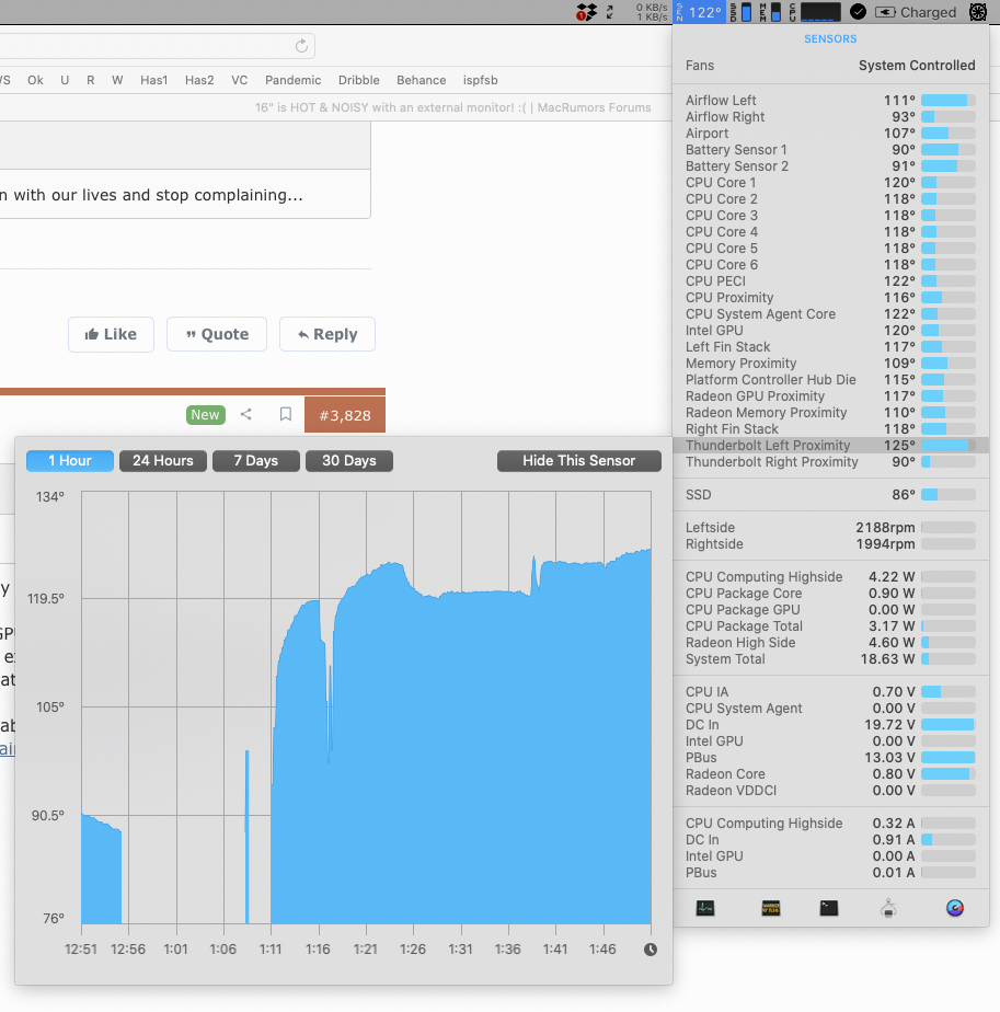

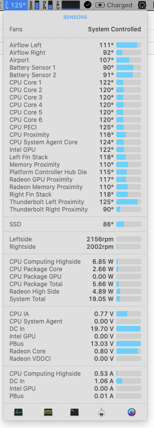

Thanks for the info. Today I connected an eGPU to a 15" 6- core MBP'18 and it DID reduce dGPU heat from 17W to 5W, but 3 problems remain:
1) the dGPU is still burning 5W, despite me driving all the external monitors through eGPU. In spite of the external monitors connected to the eGPU, gfxcard from gfx.io does NOT allow to disable dGPU, saying that external monitors are in use (see print screen).
2) both Thunderbolt ports are getting hot, especially the left one, that I connected both eGPU and Caldigit to (moving Caldigit to the left only slightly helps the left port, while significantly increasing temps of the right one
3) The computer is tot when fans are on auto, but not as hot as it was without eGPU.
So I have 3 questions:
1) Is it possible to calm down the dPU to 0W?
2) Is it possible to calm down Thunderbolt3 ports somehow?
3) Do Thunderbolt3 ports on the 16" suffer the same or they are bigger/better?

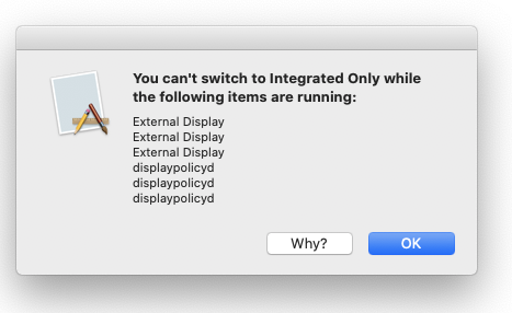

Isn't the dGPU has to be active as Apple's dGPU implementation has any displayport output routed via the GPU itself?
What you can try is this:
1. Disconnect all external monitors.
2. Set it to integrated graphics.
3. plug it back in.
See if that works. (I think it worked on my rMBP 2015 15" with r9 M370x, connecting to a monitor via displayport/hdmi as you would get black screen on external monitor.) But I don't know if its going to be the same on later models.

Your numbers seem normal, and I'm surprised if it would lead to any real problems. Five watts shouldn't change anything meaningful, especially if you're connected to AC — it won't even consume the battery. You may be trying to over-achieve in that regard. My 16" setup is fairly similar, and the Mac stays warm. Most temps hover at around 55...65 °C. That would be normal.
Port-wise, use the right side for charging (via eGPU?) and if you've got many devices, use them evenly on left/right. This is important. Charging from the left creates much more heat and fan pollution than charging from the right. If you're charging from the left, that may explain any symptoms you think aren't OK.
I've got the eGPU (charger) and Caldigit connected to the right, and an LG 5k connected to the left. Temps stay mid-range. Switching it around would bring the left side Thunderbolt to higher figures, which affects the temp readings and fan curves quite significantly. But I can't demonstrate it with numbers anymore, haven't got iStat installed. It works now, so no need to touch it. But I'll still hang around here for general interest.
Nope. Even when the iGPU is used for display, the the dGPU is still on. Metal and OpenCL can use the dGPU without switching to it. So you can run Metal/OpenCL on both the iGPU and the dGPU at the same time while iStat or gfxCardStatus show that the iGPU is active.
For example: I'm right now on the iGPU, no external display and no compute intensive applications running. Radeon high side is about 3W. The dGPU is always powered on.
I was thinking about that. Someone I know wanted to test whether some small heatsinks (for a raspberry pi) would fit onto them (maybe have to cut them down). The other idea would be to use a thick piece of Thermal pad and connect it to the chassis. That would obviously heat up the bottom plate.
Otherwise: There's nothing. The chips should've been connected to the heatsink or should have at least a small passive heatsink on them. But they're naked.
I was talking about the 16". The 16" has two dual port controllers (one on each side). The ports on the same side share lanes and bandwidth. That's why you have to connect some monitors onto separate sides in order for them to work. Like 2 6k XDR screens.
Any device plugged in to the ports will heat up the TB3 controllers. Even a USB-C SSD will heat them up while transferring data at high speed. Although it's quite minimal. Charging/high power draw and external displays are the worst when it comes to heating up the TB3 controllers.
And then there is another thing which is a bit harder to test. The VRMs. They also get really hot and they're not connected to the heatsink. You can easily see throttling when exporting a clip in Final Cut. The CPU is limited to 1.8GHz even though heat and power of both are still fine. The fans run full blast and the CPU (i9 2.4GHz) is locked to 1.8GHz. I'm 99.9% sure that this is caused by the VRMs but sadly, we cannot read the VRM temps.
3. plug it back in.
No, has not helped :)

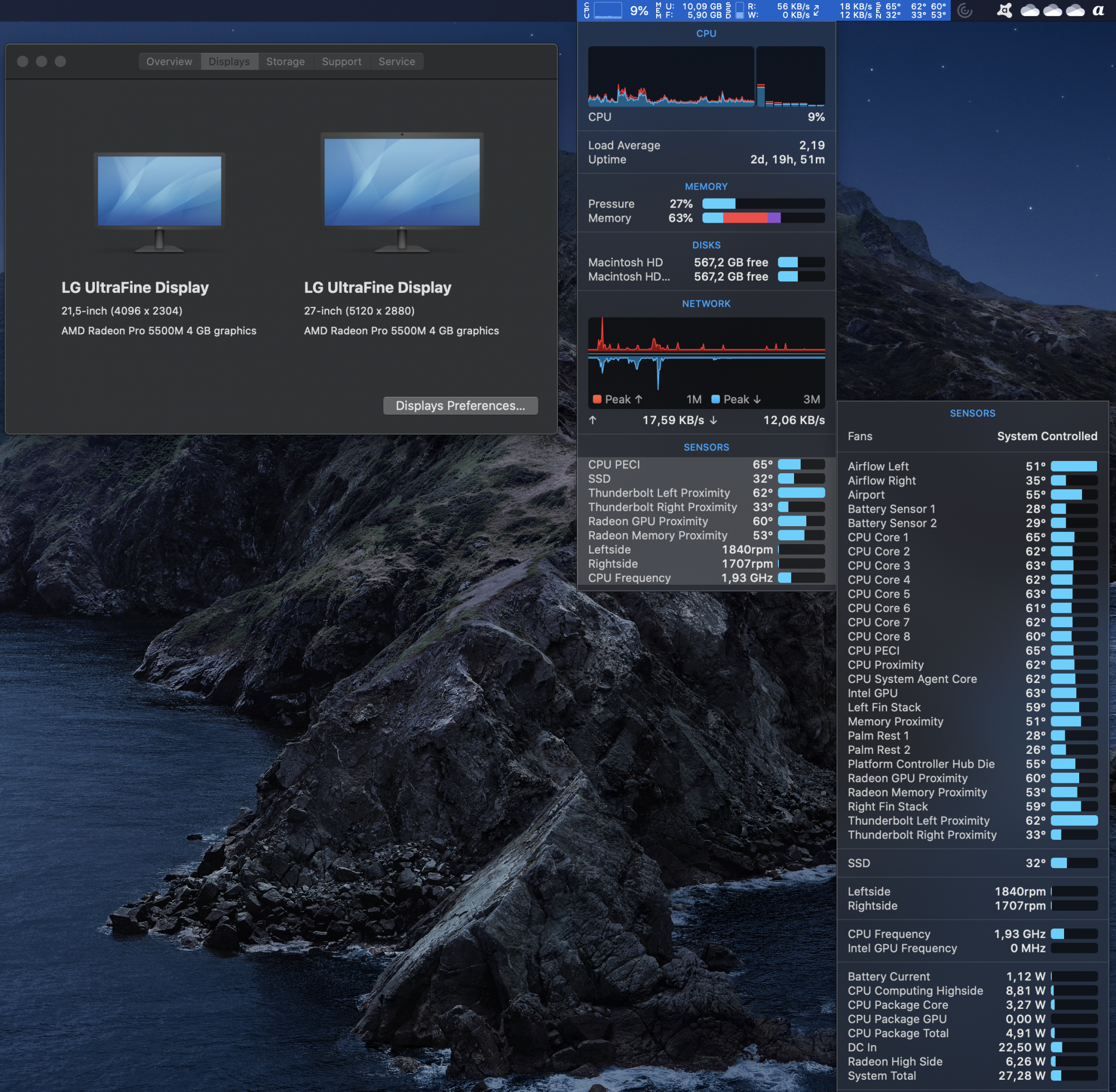

I haven't had the time to read all 154 pages of this thread but can report the following (for an 8-core i9, 5500m 8GB, 32GB MBP16):
1) Running 2 x Dell 24" 1080p monitors via a docking station with DisplayLink does not result in high temperatures and fan noise for my typical use - c. 40-50 Safari & Chrome browser tabs, Slack, Mail, MS Office apps, multiple terminal tabs (normal <10% of CPU). The laptop is open and on a stand that allows good airflow to the base.
2) I plug the docking station into one of TB3 port on the right-hand side of the machine. Monitors are connected via HDMI and DisplayPort to the Dell docking station.
3) The docking station defaults to using the integrated GPU, only changing to dGPU for apps that cause it to switch, such as Photos or Final Cut Pro. Switching to dGPU doesn't noticeably increase fan noise for most apps (Photos, Netflix, YouTube). The iGPU performance is perfectly fine for web-browsing, videos, scrolling large documents, switching between apps or virtual desktop spaces etc.

Because you’re using DisplayLink. It’s a driver that encodes the display content like a video stream and sends it to the dock as USB data. The dock decodes it and forwards it to the correct monitor. That way the monitor is not directly connected to the Mac. It’s actually more like sidecar, which also doesn’t trigger the heat problem of the AMD GPU.
But interesting to see that DisplayLink (which is more known to be a resource hog) causes less heat than connecting monitors directly.

I have an MBP16 and don't have this problem and run it with 2 x 1080p monitors (via DisplayLink on a docking station), so there is no inherent overheating in the design, at least with my configuration.
Is it only when using the dGPU? Or just with 4K monitors?
In my case, the fans become noticeable when the CPU or GPU usage rises - as expected. Probably over about 25% total CPU or GPU for an extended period. That only seems to happen under consistent video encoding/decoding load, or long-running file operations (OneDrive sync often sets it off).
I wouldn't call this a design flaw - but agree that the thermal margins are quite low. You can't run the machine at 50% load and expect it to stay cool and silent.
