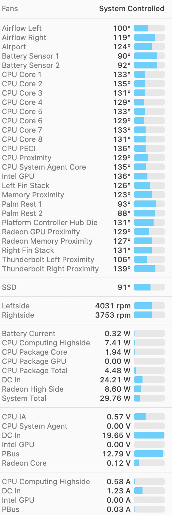

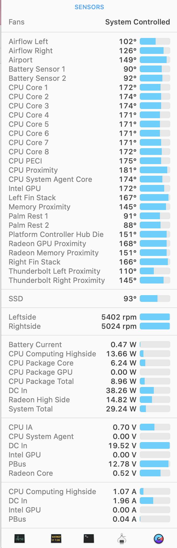

BTW: How are temperatures and power draw? Especially temps of the TB3 controllers and the GPU
This is just with the two monitors and the computer in clamshell.

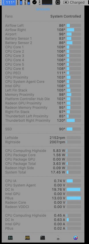

was just on my 16” MBP. Safari and a few tabs open, running on battery.
super hot underneath and the fans go off.
It a total P.O.S.

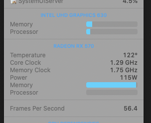

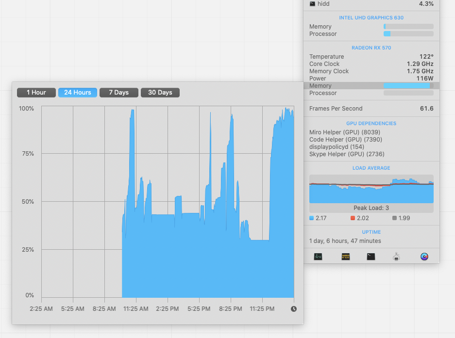

Let me ask this question here since we are discussing eGPU related things.
I have a bunch of things open on 3 external monitors, the fans are not moving, UI is smooth, but stats shows that I'm using all the available memory - all 100%.
Does it mean that my RX 570 with 8GB is maxed out? If yes, why are the fans not moving? I am not noticing any overheating at all.
You need to differentiate between “using all of the memory” vs. “using all of the computing power” when talking about maxing something out.
In your case the GPU is sitting idle. Yes, there’s cached data in its RAM, but it’s just waiting there, waiting to be used or refreshed with new data. Whatever is the opposite of “being maxed out”, that’s what your Mac is doing in those images.
I’ve seen some people observing “a simple 4k YouTube video” maxing out the fans. Check what Activity Monitor is showing. If a laptop is decoding 4k via a CPU process, it’s going to be very stressful. Means: that would be normal and to be expected in that scenario.
Different videos, browser, codec combinations matter a lot here. Some videos/browsers may be able to use hardware decoding, in which case even multiple 4k videos would be trivial. Yet in others a single 4k can be difficult to decode. Read about hardware decoding and video codecs.
I can’t say if the above is the case on all of the 5600M reports, but I too have seen some YouTube 8k videos play with no effort at all, and others requiring every bit of CPU power. It really does vary based on codec support, and when it does, the dGPU can do nothing about it, it becomes a bystander.
Meaning: “a simple youtube video” is not a great benchmark for troubleshooting purposes, because it so easily tells nothing about what the dGPU is doing, and becomes a CPU benchmark instead.
Scaled resolutions are actually rendered at 2x the "looks like" resolution and then scaled down. If you have 3 external displays all at scaled resolutions, that could use up a decent chunk of memory. I think that 8gb should still be more than enough, by far. If the system is fast/smooth and quiet, I wouldn't worry about memory usage. Systems are very good at "using" all available memory to speed things up. Doesn't mean you are operating at the limit. That memory might otherwise be sitting there doing nothing at all, just wasted. Instead it can be put to use as cache and freed if something else actually really needs it.
