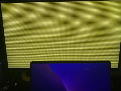

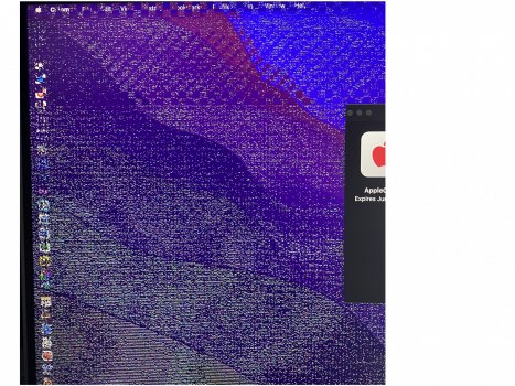

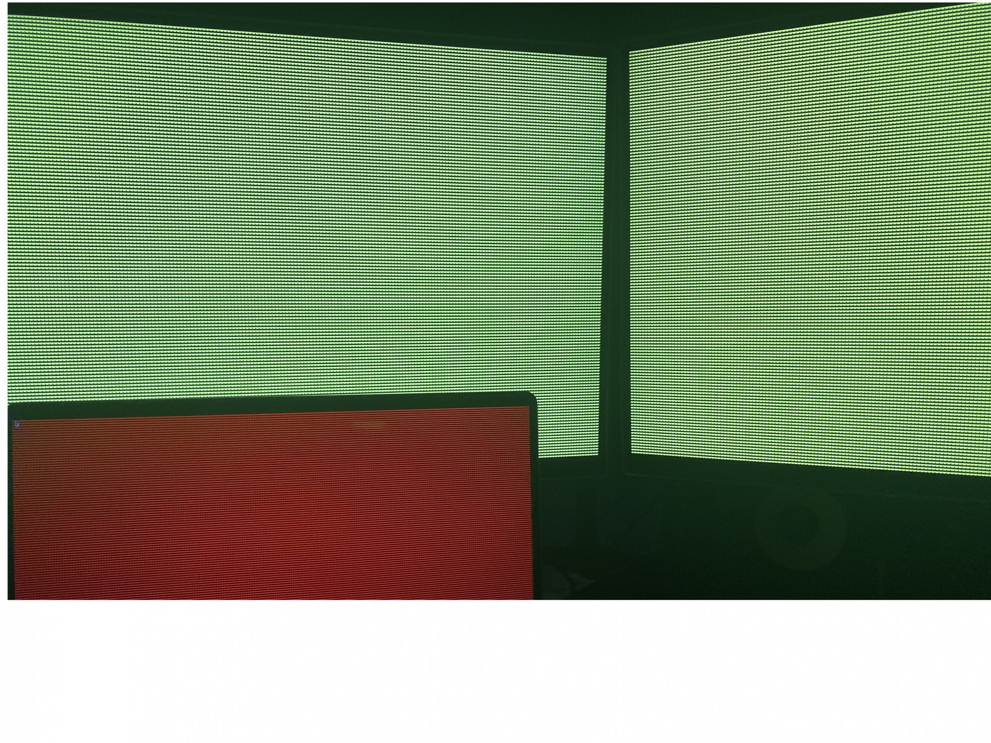

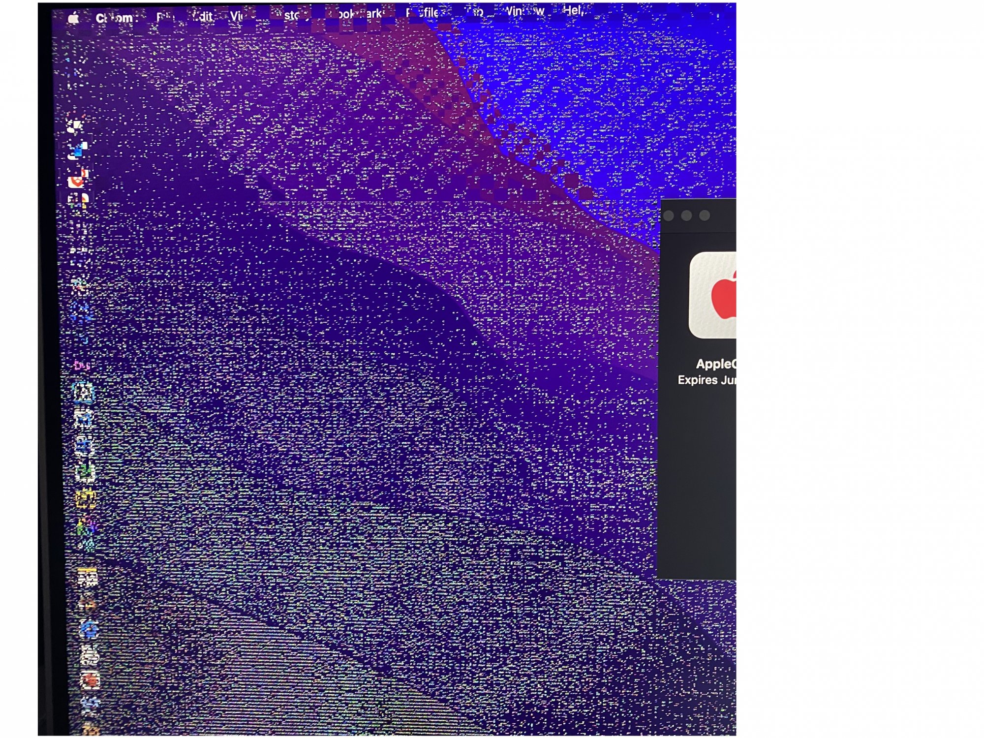

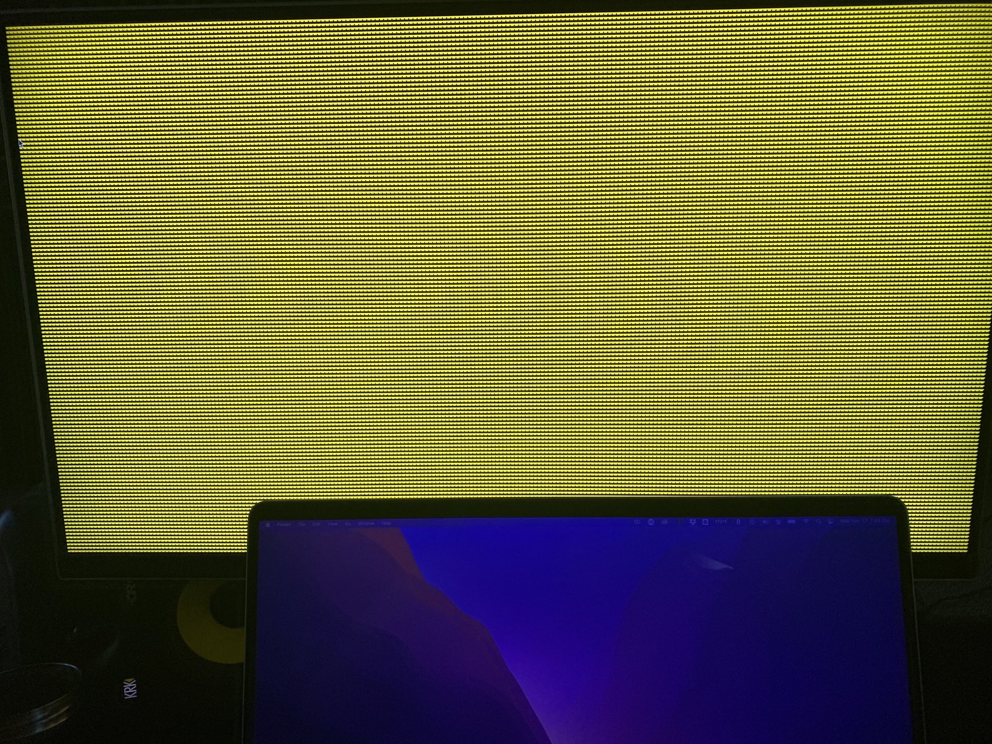

Just had my 2019 16" GPU die. Apple is sending it for repair today. Running dual monitors fine since purchased in June, then this week it started to glitch out and become extremely hot.
