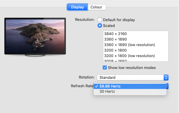

How do you force a higher refresh rate?
In my experience, the external display's refresh rate has no influence on the Radeon GPU power consumption (and heat generation). I'm running a 35" ultra-wide (3440x1440) 120hz display, and changing the refresh rate via the display preference pane has no influence on the power consumption. Like most other people who have posted on this thread, the Radeon GPU uses 18 - 20W while both the internal and external displays are active, and much lower power whilst only the external display is active with the MacBook Pro in clamshell mode.

That’s for the resolution not the refresh rate.
That shows me the refresh rate options as well, after I click "Show low res".
If you don't see it, i'd suggest trying an app like SwitchResX .
Yes in my case it's grayed out, he mentioned that he was able to force a higher refresh rate but I don't know if he was able to maintain the same resolution because with the app you mentioned if I tried to force the refresh rate to 75 (that's the maximum that the app will let me go) it changes the resolution (way lower) and it makes the screen looks weird, impossible to use.

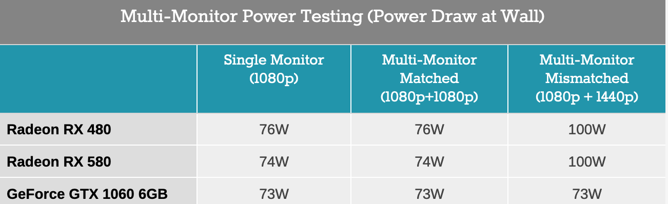

Considering the fact that AMD GPUs have been known to have higher power consumption when it comes to multimonitor usage, it doesn't surprise me at all that MBPs run hotter when connected to an external LCD.
Take this review from Anandtech: https://www.anandtech.com/show/11278/amd-radeon-rx-580-rx-570-review/2
It shows a 35% higher power consumption when you connect a display with mismatched resolution. Granted, in this case, it's a RX 580 but I guess this still applies to current Navi GPUs as well. It has been like this ever since I've been messing with PC hardware for the last 10 years.
I guess Apple is not the one to be blamed here, but AMD.
