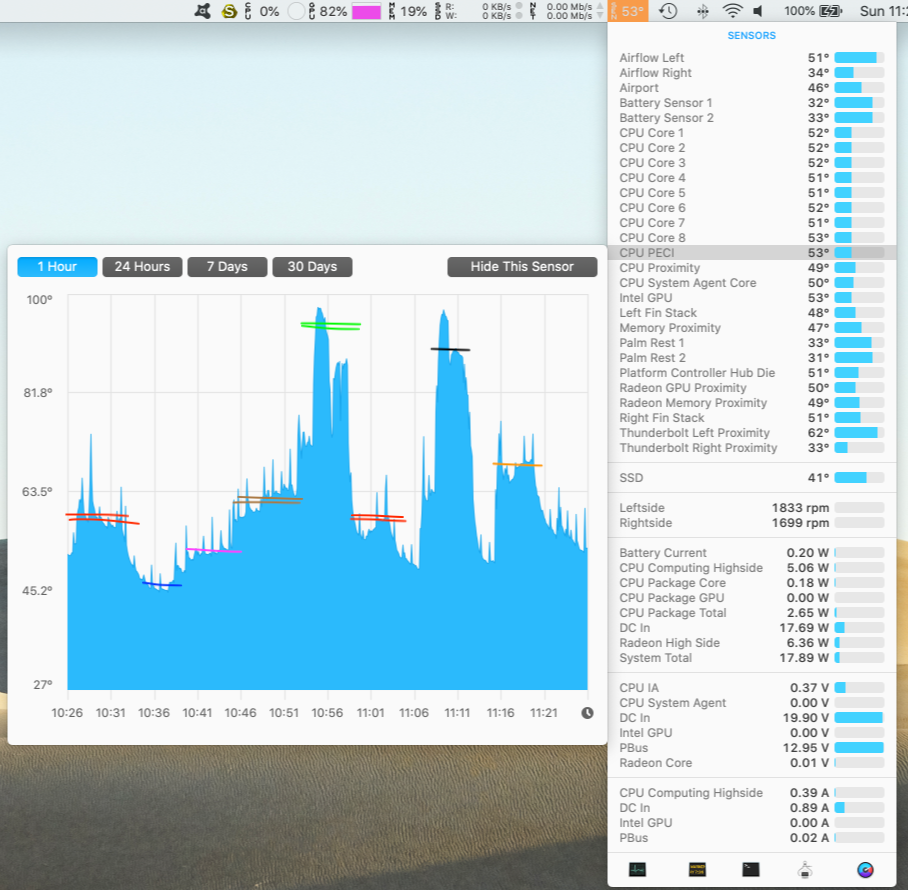

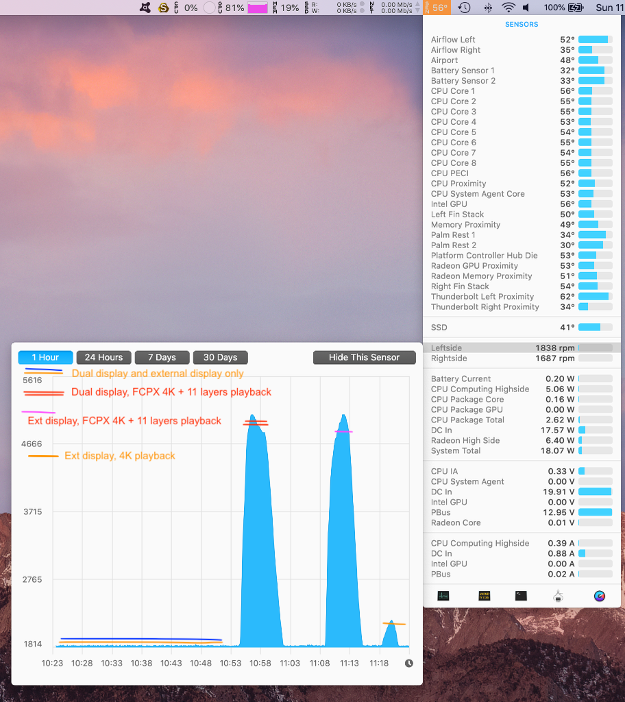

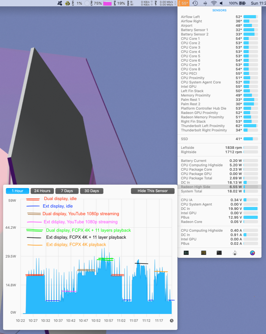

XNorth
macrumors 6502
Feb 23, 2018
300
464
United States
I’m wading in to add to that my MBP 16” has no unusual noisy fan and tempertures. It’s very quiet for everyday light use in dual display or clamshell.
My MBP gets noisy and higher temperatures only under heavy load.
My external display is the LG 34” 5K HDR connected directly (no dongle) via a Thunderbolt 3 cable that also charges the MBP. The discreet GPU is the Radeon 5500M 8GB. I’m using the latest beta OS, 10.15.5 Beta (19F72f).
The attached iStat Menus numbers and graphs show the wattage, fan speed, and temperatures of my MBP under different scenarios in which I use it.
USE: dual display, idle
GPU draw - 20 watts
Fan speed - 1840 rpm
Temp - 60° C
Fan noise - not audible from 12 inches/.3 meter
USE: dual display, YouTube 1080p60 video
GPU draw - 22 watts
Fan speed - 2200 rpm
Temp - 68° C
Fan noise - not audible from 112 inches/.3 meter
USE: external display only, Idle
GPU draw - 6 watts
Temp - 45-50° C
USE: external display only, Youtube video 1080p video
GPU draw - 10 watts
Fan speed - 2000 rpm
Temp - 60-65° C
USE: external display only, FCPX 4K timeline playback
GPU draw - 20-25 watts
Fan speed - 2500 rpm
Temp - 50-55° C
USE: dual display, FCPX 4K and 11 layers of unrendered basic text playback
GPU draw - 26-28 watts
Fan speed - 4800 rpm
Temp - 90-97° C
Fan noise - blowing and audible from 5 feet/1.5 meter
USE: external display only, FCPX 4K and 11 layers of unrendered basic text playback
Fan speed - 4600 rpm
Temp - 85-95° C
USE CASE CONCLUSIONS
Light use in clamshell mode
- video playback, streaming, web browsing and office use - the Radeon GPU draws 6-10 watts, the CPU temperatures range from 50-65°, the fan speed averages 2000 rpm. There is no audible fan noise.
Light load use in dual display - fan speed, temperature, and GPU power draw increase by about 10% that of light load clamshell mode. There is no audible fan noise.
Heavy load use in clamshell mode - GPU power draw, temps, and fan speed are twice that of a light load use. Fan noise is clearly audible from at least 5 feet/1.5 matter away.
Heavy load use in dual display - fan speed, temps, and power draw are increased by about 10%, and the fan noise is audible from at least 5 ft/1.5 meter.
Radeon power draw:
CPU temperatures:
Fan speed:

Radeon power draw:
CPU temperatures:
Fan speed:
Same result with you, while my monitor is a Dell 2720Q connected via USB-C cable.

Nah, because Safari doesn't play 4k video in YouTube.
Check the actual YouTube stats (or click on the resolution changer), Youtube does not support h.265 for 4k video. You might be playing it on a 4k display, but it will be playing 1080p content if you're using Safari.
The only way to get 4k YouTube actually playing at 4k on a Mac is to use a non-safari browser.
Oh, sorry, I guess I should explain.
The video itself may not be 4K... but when you are "displaying" it on a 4K monitor, the content has to be upscaled to fit 4K resolution. So effectively, the GPU is displaying something at 4K even though the source material is not.
That's what I really meant.
I know Safari can't play 4K, but the problem is... if I'm playing 4K on Youtube in Chrome, then the extra heat comes from the CPU and not from the GPU at all.
But anyways, I did it just for fun:
Yeah, GPU usage maxed out at 20W. Using h264ify to force the same video to h.264 didn't help reduce GPU load. Certainly helped a bit with the fan, though.
Still 18W load. This is with a single monitor. So Chrome seems to stress the GPU a bit more than Safari.
I knew this ahead of time, that's why I asked if it was Chrome.
If Chrome was indeed used, then the fan noise is not just from the GPU heating up. It's from the CPU having to decode all those extra pixels.
So yeah, hopefully it's more clear now.
Reactions: throAU
