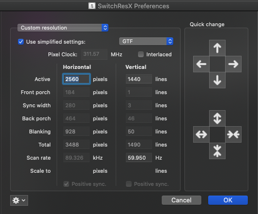

Following up on my tests at 2560x1440 resolution in clamshell mode (previous post is https://forums.macrumors.com/threads/16-is-hot-noisy-with-an-external-monitor.2211747/post-28531358 ), it turns out that only 60Hz causes the GPU to stay at 19W.
I've tried 100, 120 and 144Hz and those all use only 7W on GPU.
It's really strange that the most common frequency is the one that causes issues...

My Asus monitor goes up to 144 Hz. But I can't select 60. Only 59.88. Is this over display port your tests?
I experience the exact same issues with 1 external display in clamshell. Its not as pronounced as with 2 displays but it's still there. So I have to think its more that just a multi display issue.
According to AMD forum increased high clock vmem frequency when connecting external monitor(s) IS NOT considered as a bug. Apple may try to report this issue to AMD but chance is almost 0 if this is a FAD. Like in case of butterfly keyboard case this problem may be addressed in future MacBook Pro release but according what I found all AMD chips have this problem (after NVIDIA BGA bump gate relations between Apple and NVIDIA are not so good I believe and I am not sure if they have HBM to save space on PCB).
