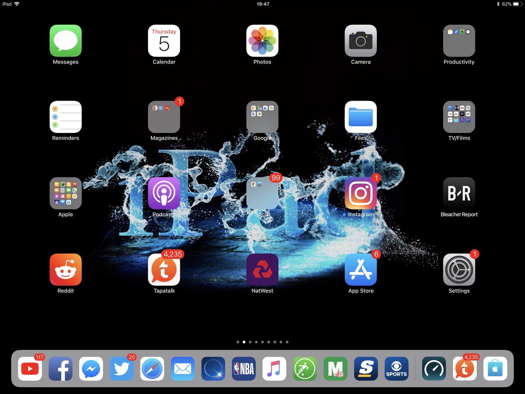

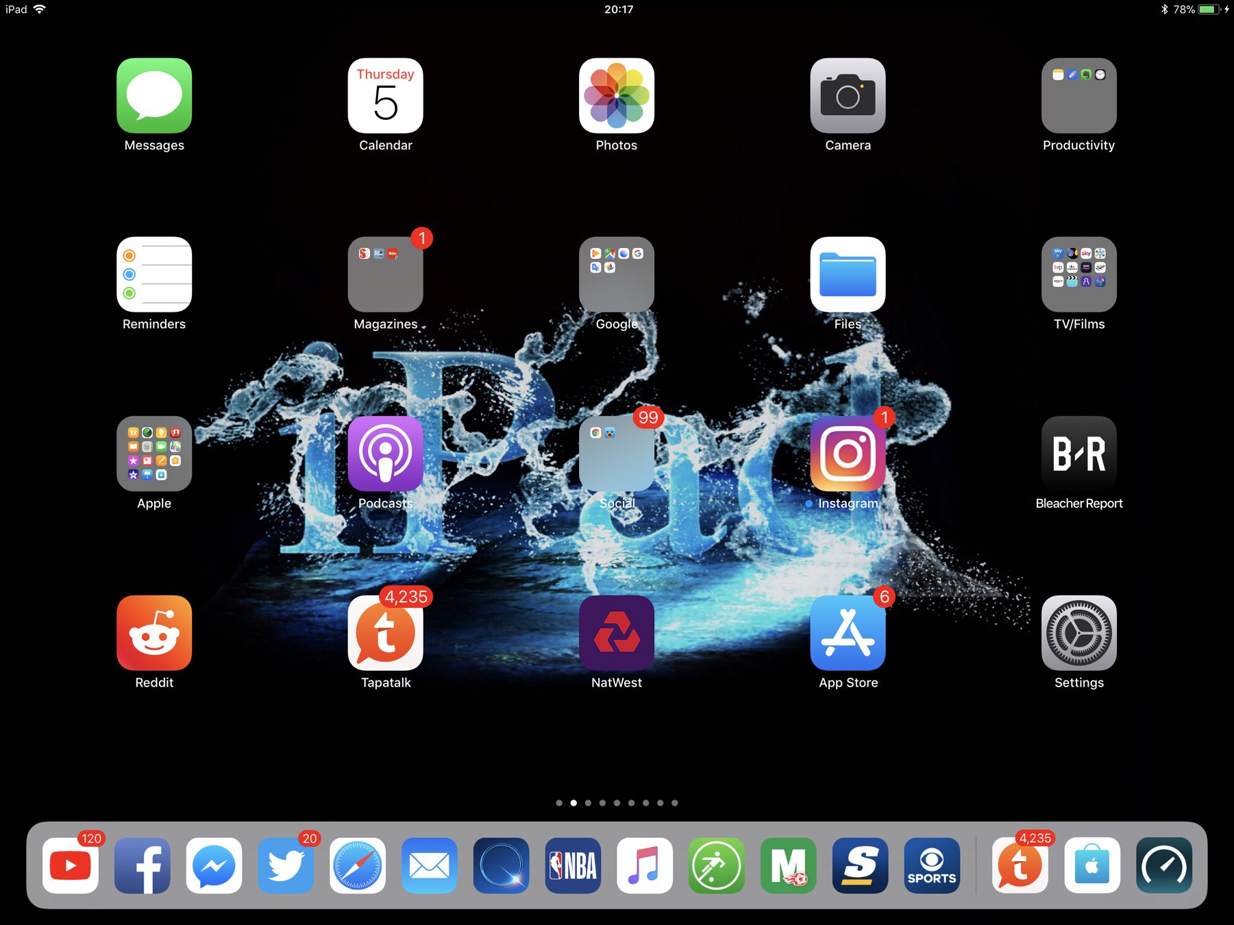

Plugged in my 2017 12.9 at 12.20 with 15% left and at 13:50 it’s at about 80% charged. So much better than the original charger

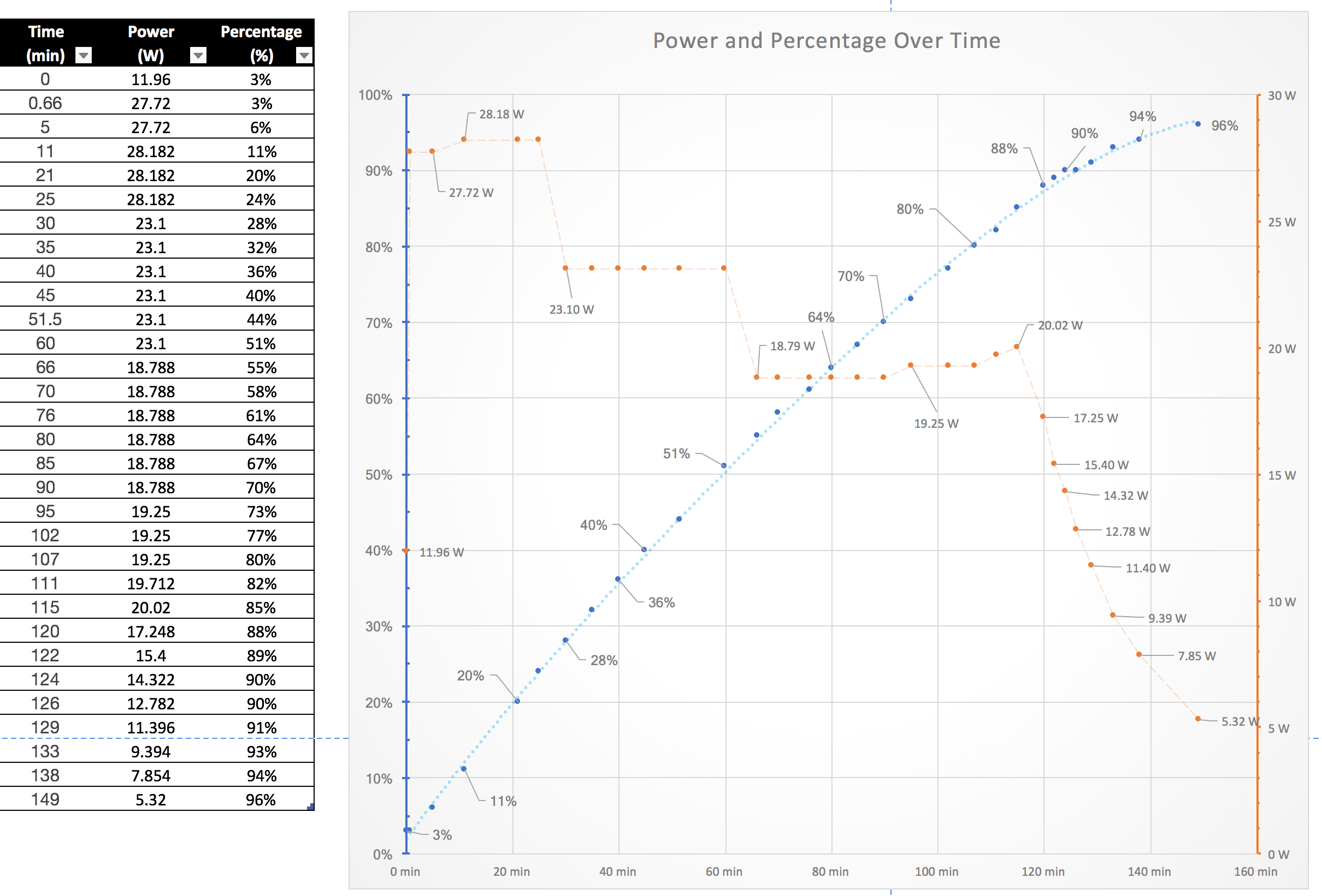

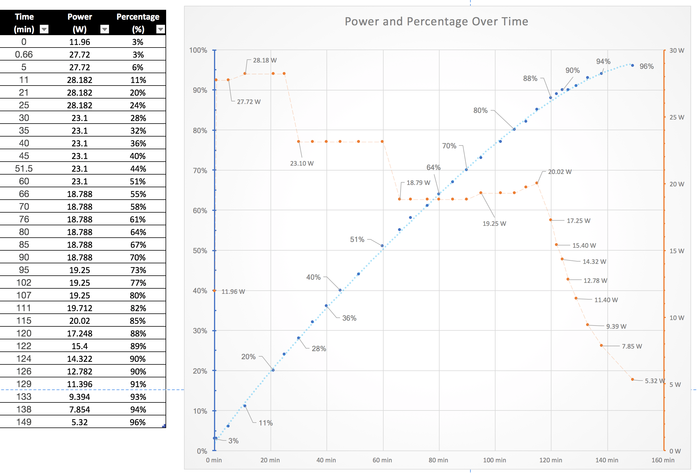

Since there's been renewed interest in the charging speeds, I've spent some time to redo the tests using the Anker 30W charger mentioned in the original post, this time with time data points:
The chart isn't the best - unfortunately I don't use Excel a lot so this took me some time. Most people will be interested in the blue line. It looks mostly linear, but you can tell from the power (orange) line that the iPad is down regulating the power over time.
@The Game 161 - my data points show 61% to 77% in 26 minutes, so roughly in line with your speeds, although it seems like the Anker charger might be slightly faster (maybe...)

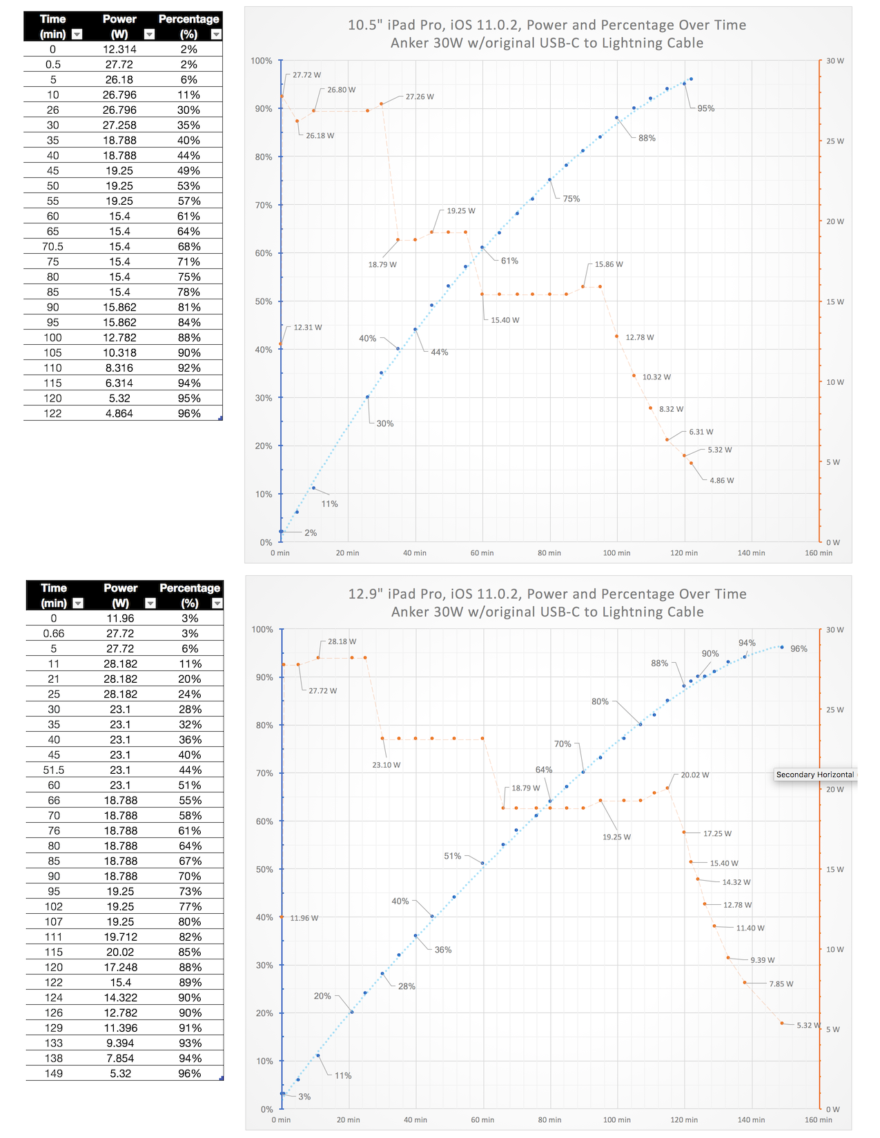

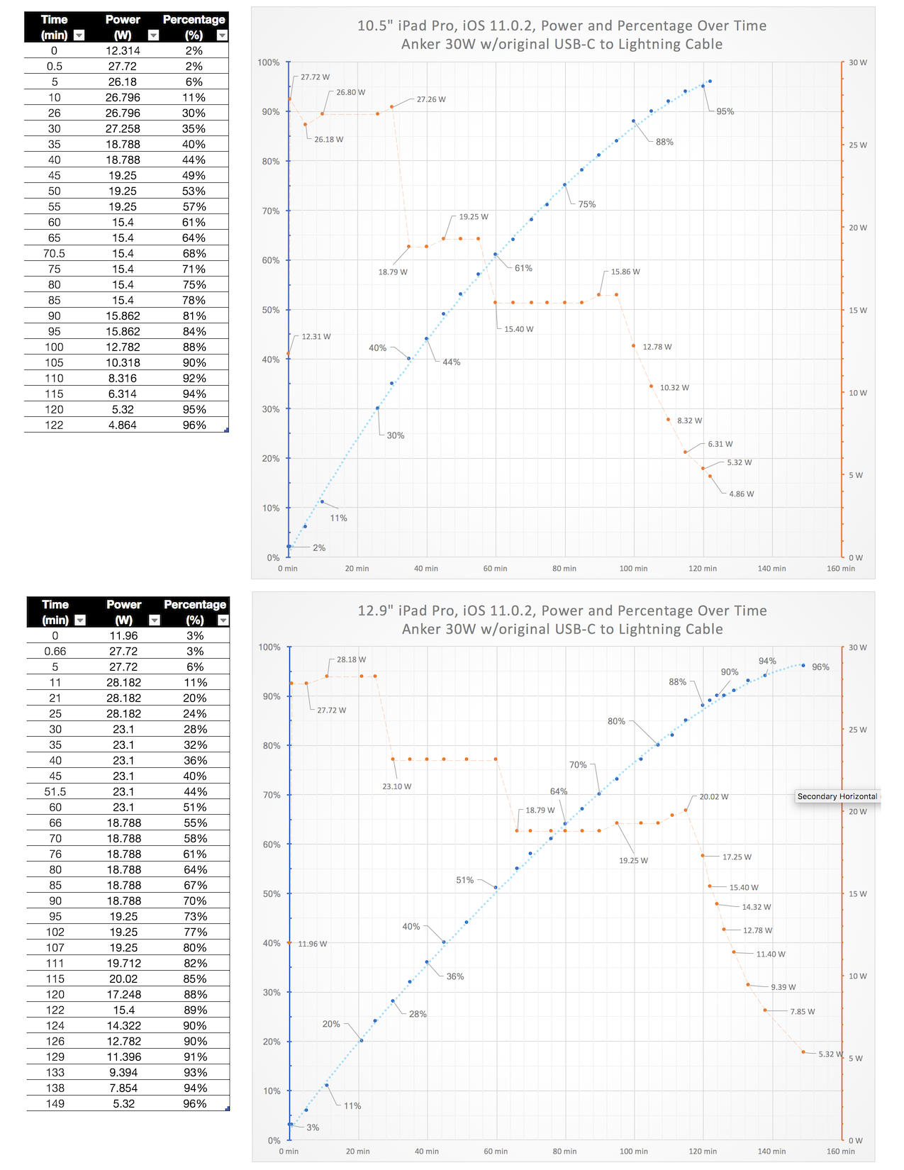

I've repeated the same tests on the 10.5" and it's quite clear that the 10.5" charges more quickly (e.g. 6-60% in 55min on the 10.5" versus 71min on the 12.9"), despite the power regulating down more rapidly. I've combined both charts on the same page so it's easier to see the difference:
Either way it looks like the power is being well regulated by the iPad Pros (very aggressively down-regulated on the 10.5"), so there's little to no risk of too much power being delivered as the percentage goes higher.
