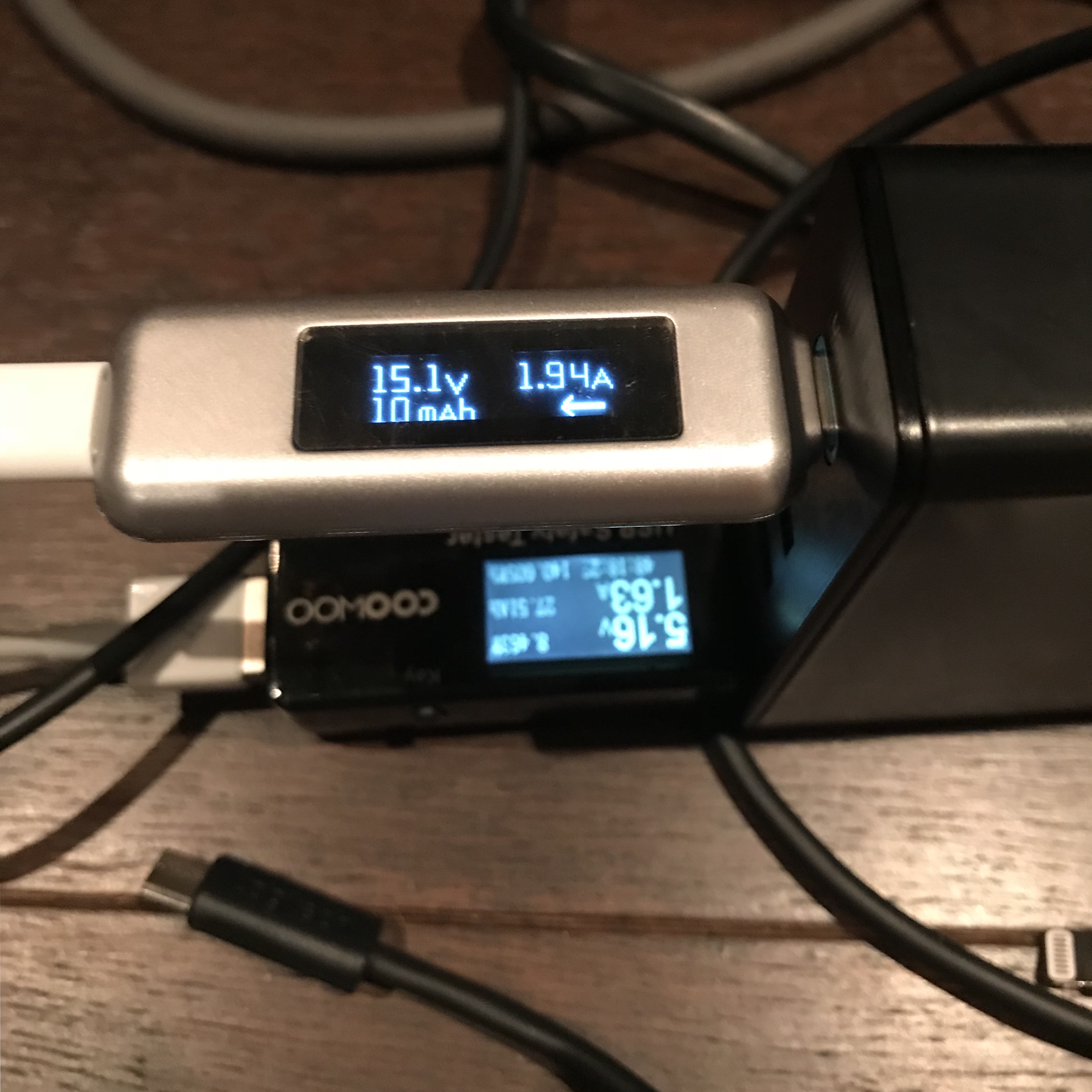

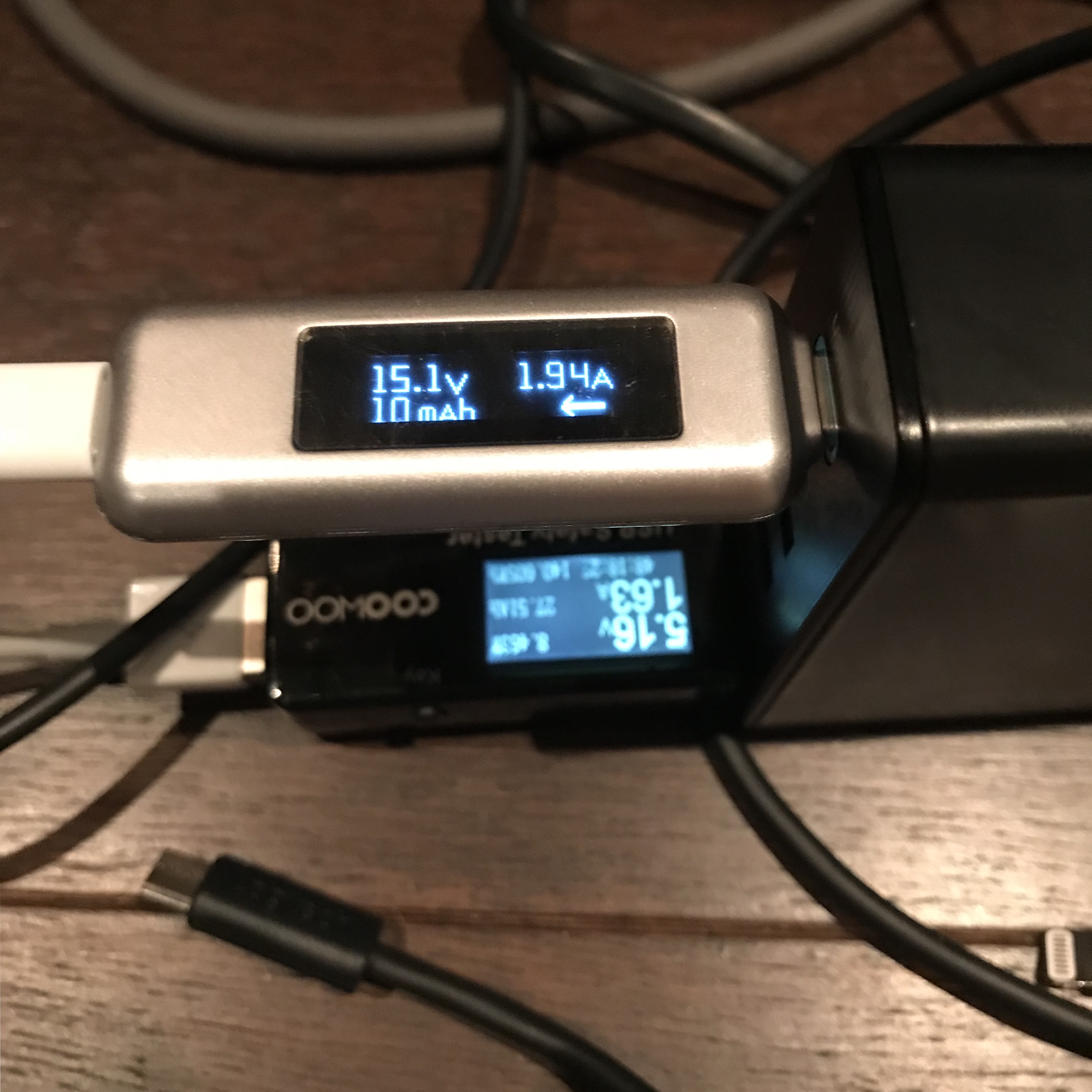

Hey guys, got a 2nd charger for my iPhone 8, and can confirm with iPad pro 10.5" this charger plus apple cable will charge at 30w!
Charged my iPad and registered 33w from my power meter at 36% dropping to 21 after 50%

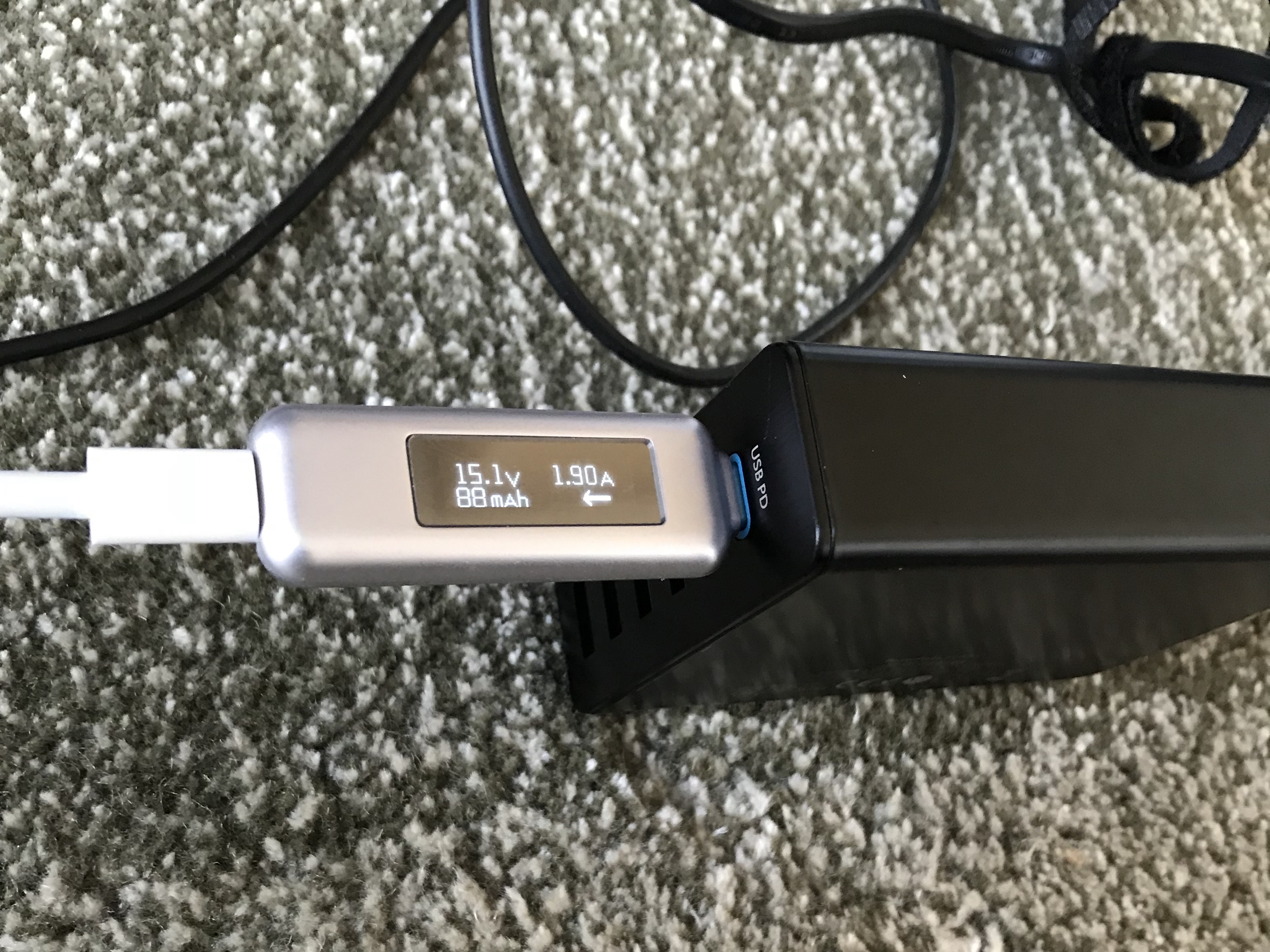

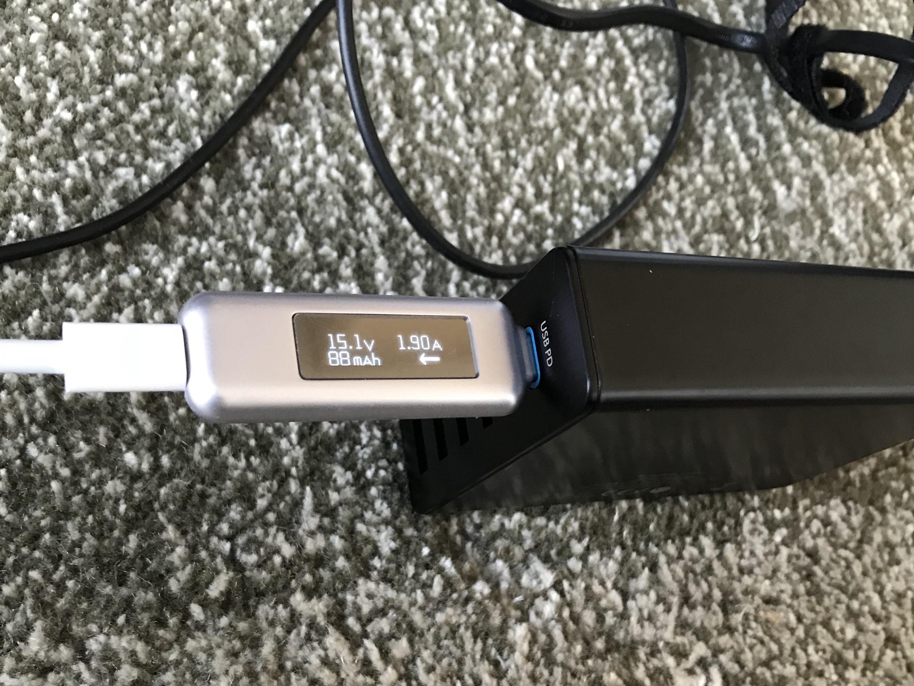

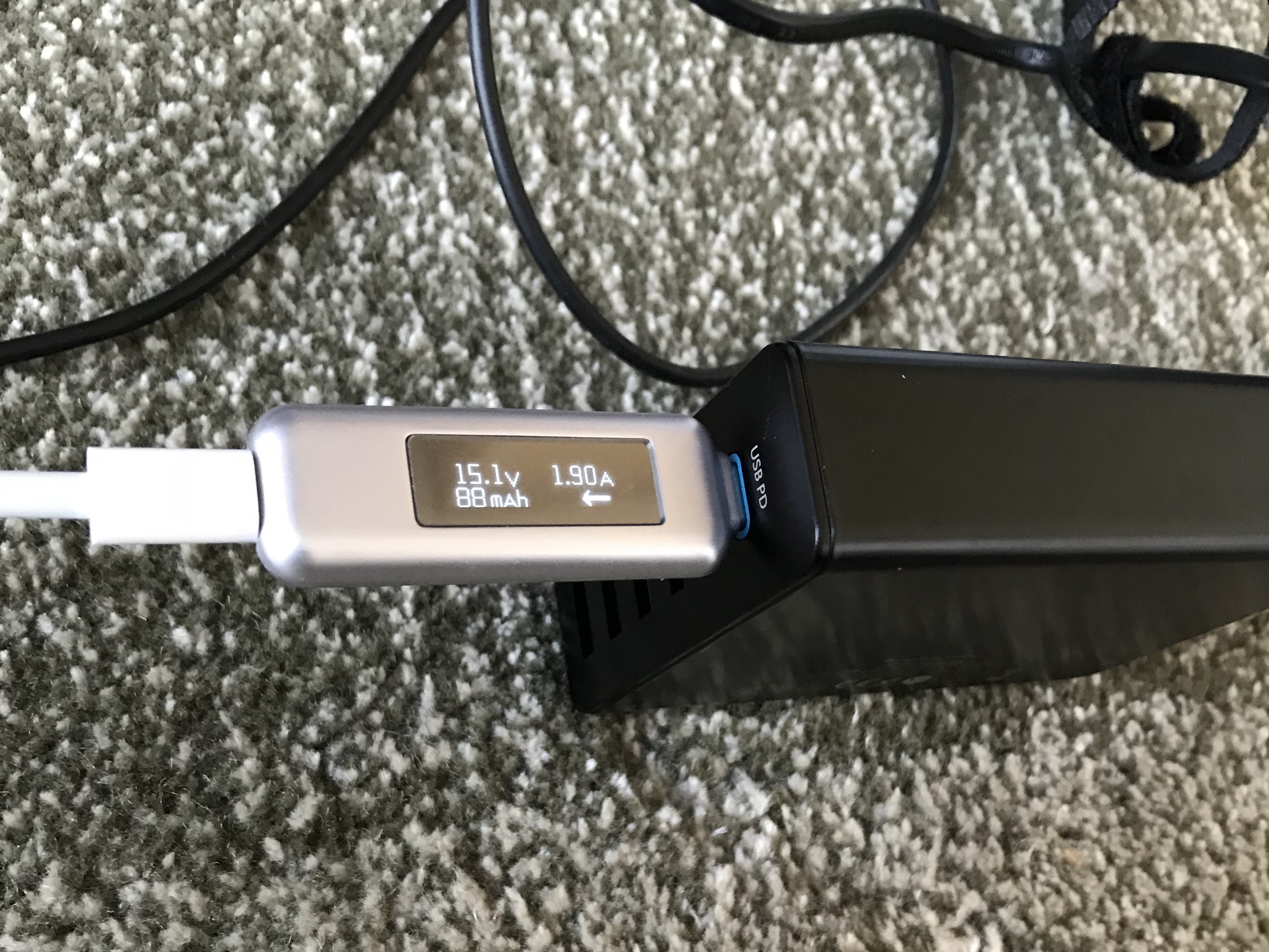

I just purchased the Anker PowerPort+5 last week from Amazon UK and, contrary to prior reports, it does indeed fast charge my iPad Pro 10.5 at 15V/1.9A. Perhaps they updated the model? I noticed the product description on Amazon no longer says ‘incompatible with USB-C/Lightning cables’ where it used to.
Anyhow this is now my ideal charger, as it covers all bases :)
Model number says A2053 on the unit
I presume that’s with a genuine Apple cable?
Yes, the 2m official one bought direct from Apple.
I tried two “genuine” 1m cables from eBay but both were fakes and would only charge at 5V regardless of charger used, incl the 29W Apple charger.
And just to follow up, I also tried my first gen 12.9” iPad Pro with the Anker and official cable. This combo also works and charges at 15V/1.9A :)
