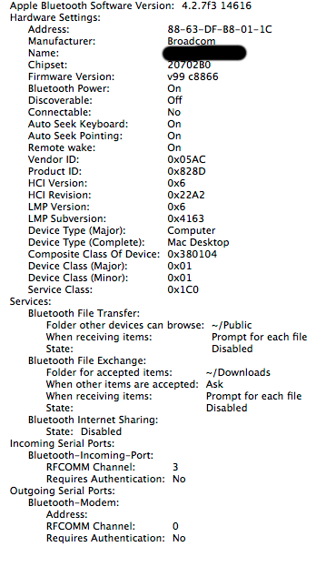

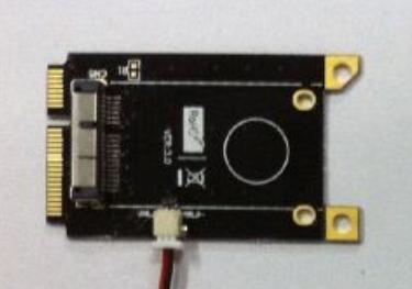

I followed Ludacrisvp's guide from post #286 (https://forums.macrumors.com/posts/20273458/) and ordered an adapter and a BCM94360CD WIFI/Bluetooth card from the same amazon sellers as he recommended.
Both card and adapter arrived in just over a week, and installation was fiddly but no major issues.

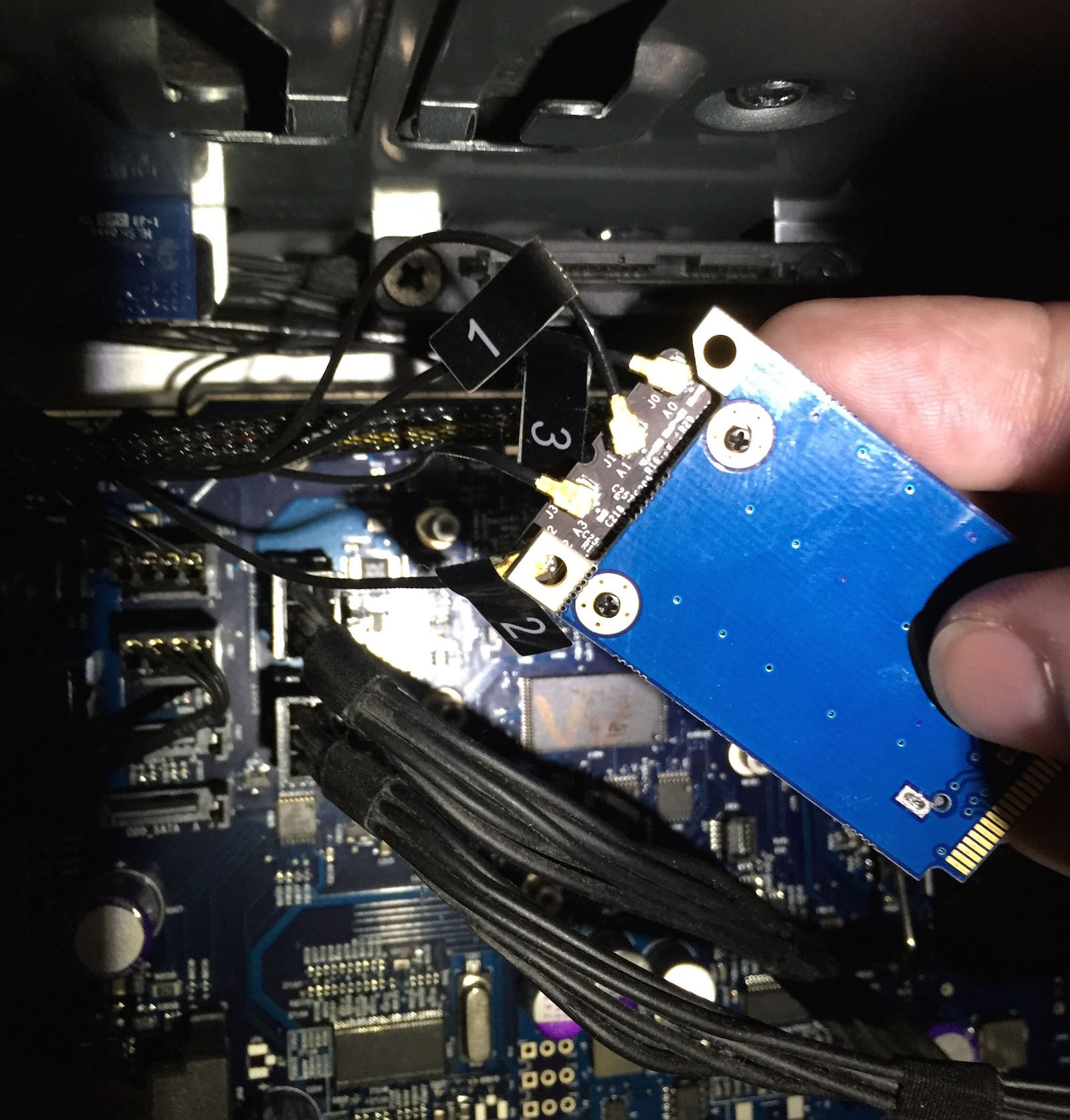

I have 2008 3.1 octo-core Mac Pro, and it never had bluetooth or WIFI before. There was a group of 3 cables labeled 1, 2, 3, and a single longer cable that I assumed to be the bluetooth cable (even though there was no BT sticker on it). I attached this longer bluetooth cable to the J3 connector on the card, and attached the other cables in order of length so that the longest cable could reach the furthest connector when the card was installed (connectors facing down).
After multiple reboot attempts, I see the bluetooth adapater, but no WIFI.
I have read on this thread that loosening the retaining screw and just wiggling the card around could help, but no matter what I try, bluetooth always shows up fine in the System Report, but when I click WIFI, it only ever shows a short list of Software versions.
Is there some specific order needed for the 1,2,3 cables on the card? Is there any other step I'm missing?
Thanks!
The order of the Wi-Fi antennas shouldn't matter.
My guess would be that you may want to remove the combo card and use a can of air to clean out the pcie port since you've not used it before it may be dirty and you are only able to use part of the card.
That's actually a really good idea! I'm going to try that right now. Also I'll take pictures while it's apart just in case. Thanks.
Alas, no go. I took everything apart so I could get good access. I gave the PCIE female connector a thorough cleaning with compressed air. Put it all back together and the same issue persists. Bluetooth but no WIFI.
I've ordered another BCM94360CD card off ebay for cheap. Just seems strange to me that bluetooth works via the PCIE and not the WIFI considering its an integrated unit.
See attached image for wire hookups. I think they are fine though.
That sucks. Could have been an ESD damaged card. If you have some alcohol you may try cleaning the pins (and letting them dry) on the combo card and the adapter and see if that helps.
Oh where that antenna wire #2 is connected I did snap off that screw hole header (it's made to break off) I did that to prevent possible grounding out of the card. You may want to remove that one too.
[/COLOR]Oh where that antenna wire #2 is connected I did snap off that screw hole header (it's made to break off) I did that to prevent possible grounding out of the card. You may want to remove that one too.
I'll try that next. I didn't realize how close those were until i flipped it over and took this picture. Thanks.
Sigh, nope clipping off that corner didn't help. I too the opportunity to clean the adapter board, but that didn't help either. Not sure what else is left to try.

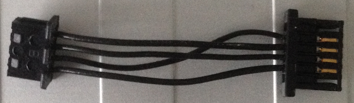

Standard USB configuration is...
1. RED = 5 volts + (often marked with a little arrow)
2. WHITE = Data +
3. GREEN = Data -
4. BLACK = Ground -
EDIT: But I guess Apple is NOT doing it that way on the Bluetooth connector.
Digging up an old post but I was curious about this pinout question too. Looking at the original bluetooth board cable you can see the pins are shifted showing the change on pinout. It also measures the correct voltage (3.3v) to ground on pins 3 and 4 from the backplane.

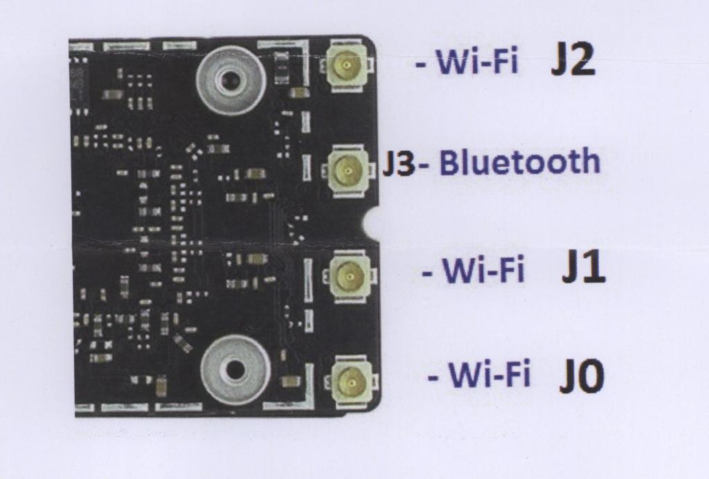

Problem solved now, all I had to do was disconnect the bluetooth antenna and connect up one of the wifi cables to the bluetooth (J3) connector. YAY, thanks OSXwifi, now I can update to Yosemite and use Continuity and Handoff. Only the SSD TRIM ordeal to cope with now, but that's for another thread.:)

I was instructed to disconnect the portable bluetooth antenna (if you ordered one of these, as you had to order it separately) and connect any one of the three wifi antenna's to the J3 connector.
Here is a picture of the card with the J3 connector marked, hope this helps:
