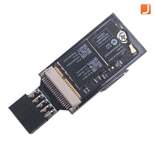

I know it's a little off topic, but I ordered this solution for my Hackintosh:
http://www.ebay.com/itm/201140406017
It is the Apple BCM943224PCIEBT2 (BT 4.0/802.11n) with an prewired adapter to simply plug into my motherboard's USB header. Bonus is that it has a full size USB port on the board you can use for anything. I plan to plug in my Logitech Unifying dongle that I use for my Wireless Solar Keyboard for Mac. That way it will be like even my Logitech stuff is "built in!"

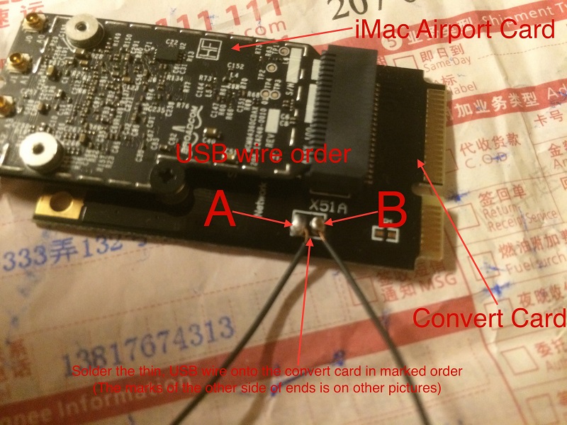

Where to buy "Convert Card"
Does anyone know where (eBay, Taobao, etc.) to buy the "Convert Card" shown in the original post? It's the card with "X51A" written on it; see attached image.
According to the first post, it is the seller on TaoBao (http://item.taobao.com/item.htm?spm=a1z09.2.9.10.91QEa2&id=20953715880) and email (133557@qq.com). I have tried emailing but do not get a response.
Anyone know where else it can be purchased?
Thank you! :)

Convert card
Hi
I've bought the Broadcom BCM94360CD card and a adapter same as these :
attachment.php
However, the adapter does not have a Data+/Data- connector and I was wondering if I could do the same as another member here has done for his imac :
attachment.php
attachment.php
attachment.php
Also, I assume I do not have to solder a cable for the power part (R1).
TIA

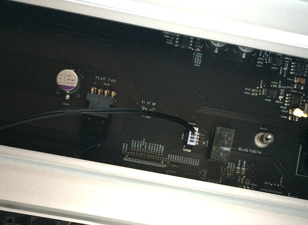

received it today, pretty fast delivery :D
very handy, they made the custom USB signal cable for the adapter and the connector to the 4,1 logic board USB signal connector , just fit and and work ! you no need to modify the connector form original bluetooth card at your 4,1/5,1, only thing is those antenna connectors are quite small , have to very carefully connect them, small hand guy like me is ok :cool:
Alas, no go. I took everything apart so I could get good access. I gave the PCIE female connector a thorough cleaning with compressed air. Put it all back together and the same issue persists. Bluetooth but no WIFI.
I've ordered another BCM94360CD card off ebay for cheap. Just seems strange to me that bluetooth works via the PCIE and not the WIFI considering its an integrated unit.
See attached image for wire hookups. I think they are fine though.

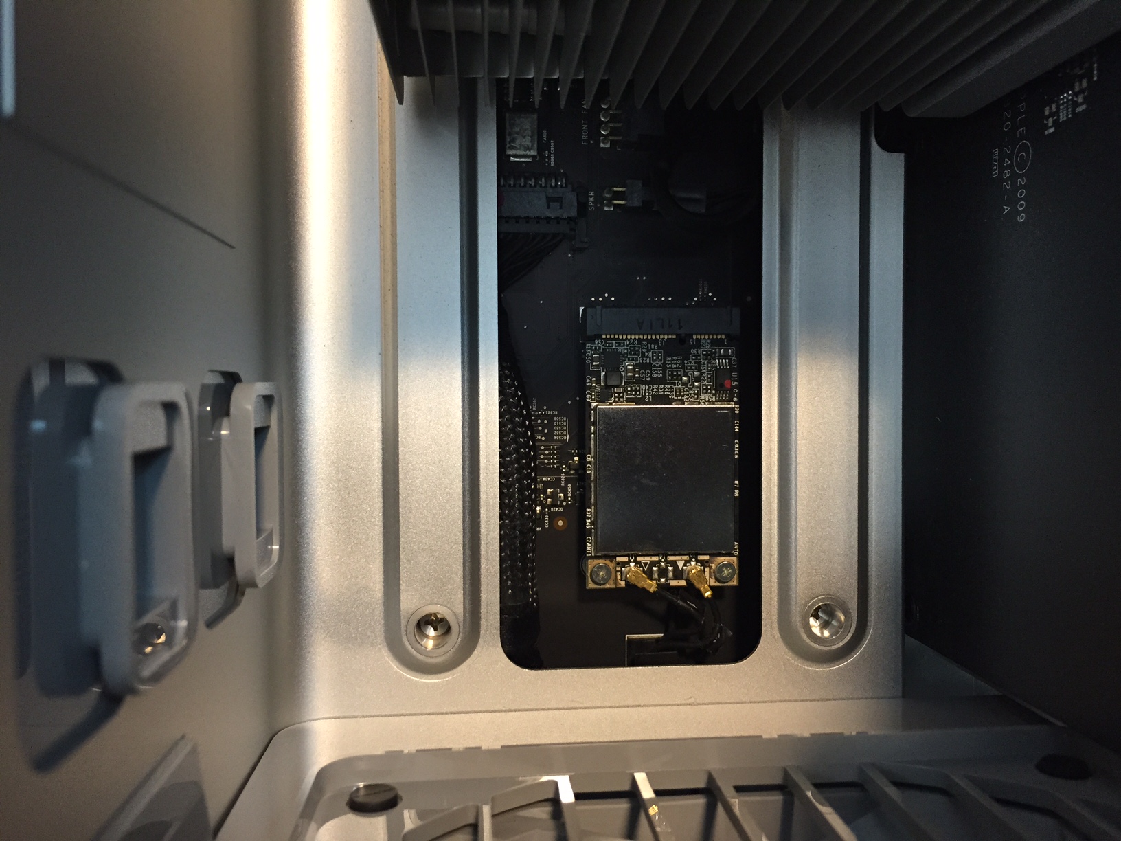

I have 94360CD card that was using but I decided to use it for my MacPro5,1. I ordered an adapter and read thru guide in #1 post but I notice my wifi card only has two antenna connector?
Sorry for not reading post carefully. :)
I found third wifi antenna under the card.

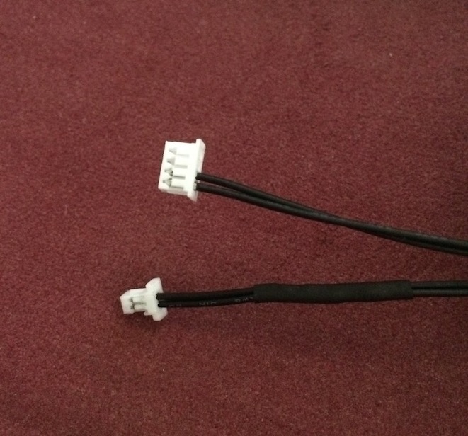

I got the adapter, modded cable as shown on post #1, (I had to re-do the wire as I had A, B reversed) and it's all good and got my handoff working. Thank you!
osxwifi will get you going but very pricy and you will have to extend USB cable out of the case into rear USB port (not very ideal).
They are selling bluetooth extension cable for $11.99 + $6 shipping!
Their reasoning for $6 for this cable was the cable is too fragile....yeah right.
Got my cable for HK for $5 including shipping to US.

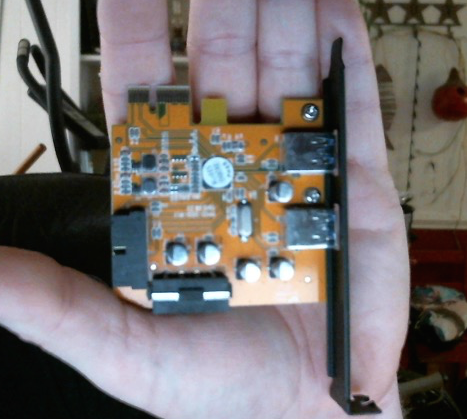

USB3 PCIe card with internal ports?
Gotcha, you'll be very limited in choices for USB 3.0 with internal ports, but there are a few, especially if you don't mind rigging up an internal power connection. I have an Orico card that has 2 internal USB connections, but it requires additional power to be split off from one of your drives. It uses the FriscoLogic controller so it's compatible with most everything. Amazon carries them.
I tried to find that card on Amazon and couldn't identify it - do you have a board/part number for it? I know about USB2 cards with internal ports, would like to go USB3...
Thanks so much for the help, I don't suppose you know the exact model number of your card? I've been looking on amazon but I can't seem to see any that would be suitable, cheers.
Sorry I didn't get back with you. It's gone from Amazon.com. I tried to find it too and met with negative results. I'll dig through my stockpile in a few minutes and see what I can find.
Okay, on closer examination, it has 2 internal USB headers (like on a motherboard) and you will have to get the appropriate connectors/wires. It's actually designed to drive the front USB ports of a PC case, but you can adapt that.
EDIT: Here is the Amazon Listing for the ORICO PFU3-2O2i
Here is another one on eBay ORICO-PFU3-2O2i
Here's a newegg review. Contrary to what the reviewer says, it doesn't need any additional power, but it does have a connector for it if you want additional power. I'm looking around for a U.S seller right now.
It appears that THIS SELLER has them in stock. I added one to the shopping cart and it said it's $19.60.
