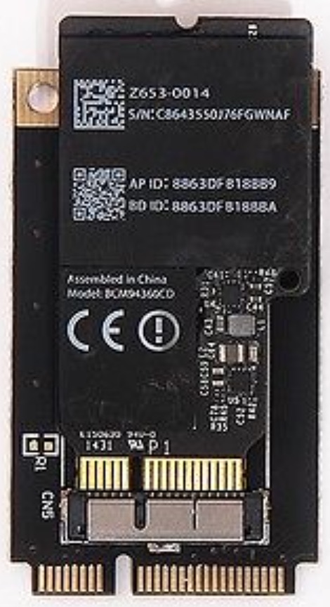

Problem is, i tried to use the adapter I had for the BT4 card, which is somehow different.
See the pic (the card is a BCM94360CD)

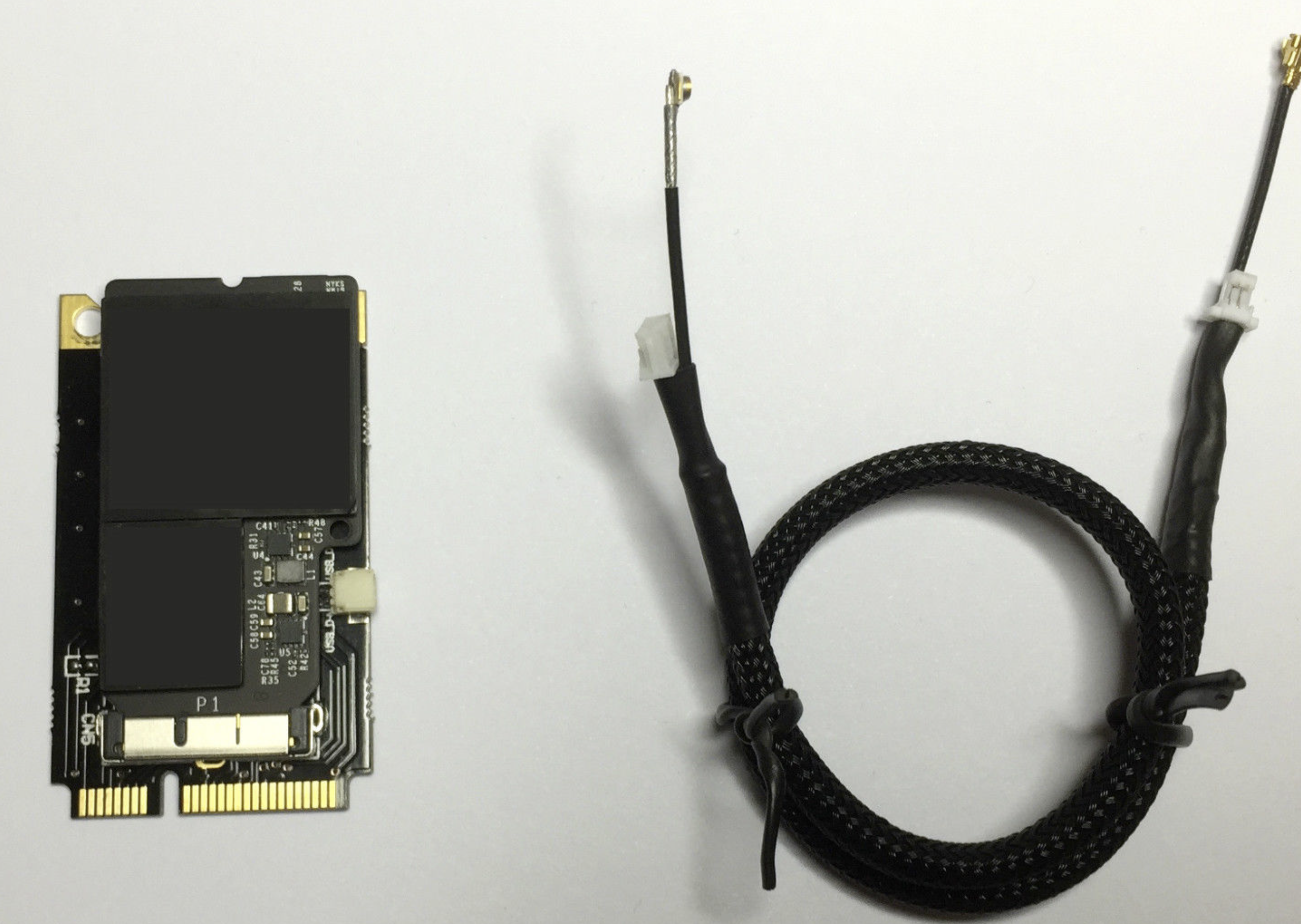

Does anyone know where I can buy an extension lead for the bluetooth connector? I did find one on OSX Wifi, but with international shipping it works out rather expensive:
http://www.osxwifi.com/bluetooth-antenna-extension-cable-male-to-female-2ft
I have found similar things online, but almost no male to female leads.
Also, does anyone happen to know if the USB data lines have to be connected to the original connector or will any USB data lines suffice? I ask as I could connect it to the front panel, because I've replaced the original USB 2.0 ports so the lines aren't being used and it would just look a little cleaner.

If you are looking for better BT reception, and you are going to buy some cables anyway. You may consider this pix -> SMA cable + external antenna combination, or the notebook antenna solution.

The USB cable is to connect the BT module on the newer cards to the connector where the original, separate BT module connected (Which is USB). It doesn't connect to a traditional USB port.
I purchased the OSXWiFi card and cable as a complete kit from Amazon, separately the same cable is here...
https://www.amazon.com/Antenna-Exte...-1-fkmr0&keywords=osxwifi+bluetooth+extension

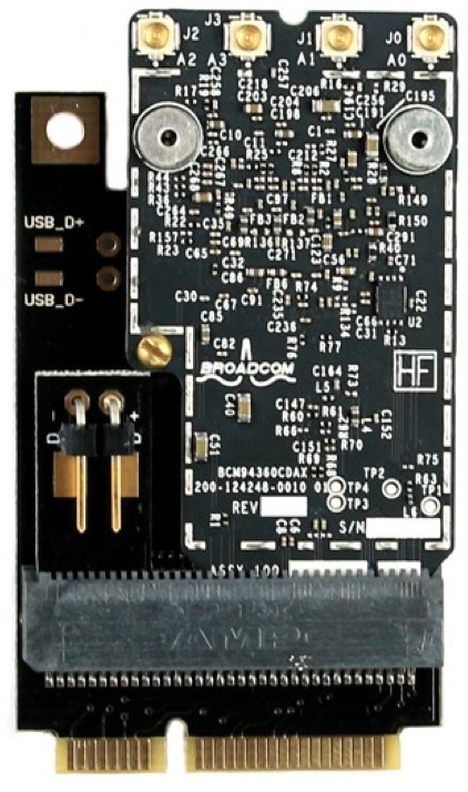

Anyone know where I can purchase a Mini PCI-e adapter that allows a BCM94360CD to be installed so that the antenna connectors are on the top? All the generic Mini PCI-e adapters (v3 - that have data D+ and D- connectors) are on the under belly, which makes it difficult to connect the u.fl antenna cables - they keep popping off when I turn the card over. The Mini PCI-e adapters that OSXWiFi sell are exactly what I want, but cost 4 times the price of the generic ones you can buy on eBay etc.
OSXWiFi solution - 4 antenna connectors exposed on the top
Generic Mini PCI-e adapter - once BCM94360CD is installed, the antenna connectors are on the reverse sideApple.jpg

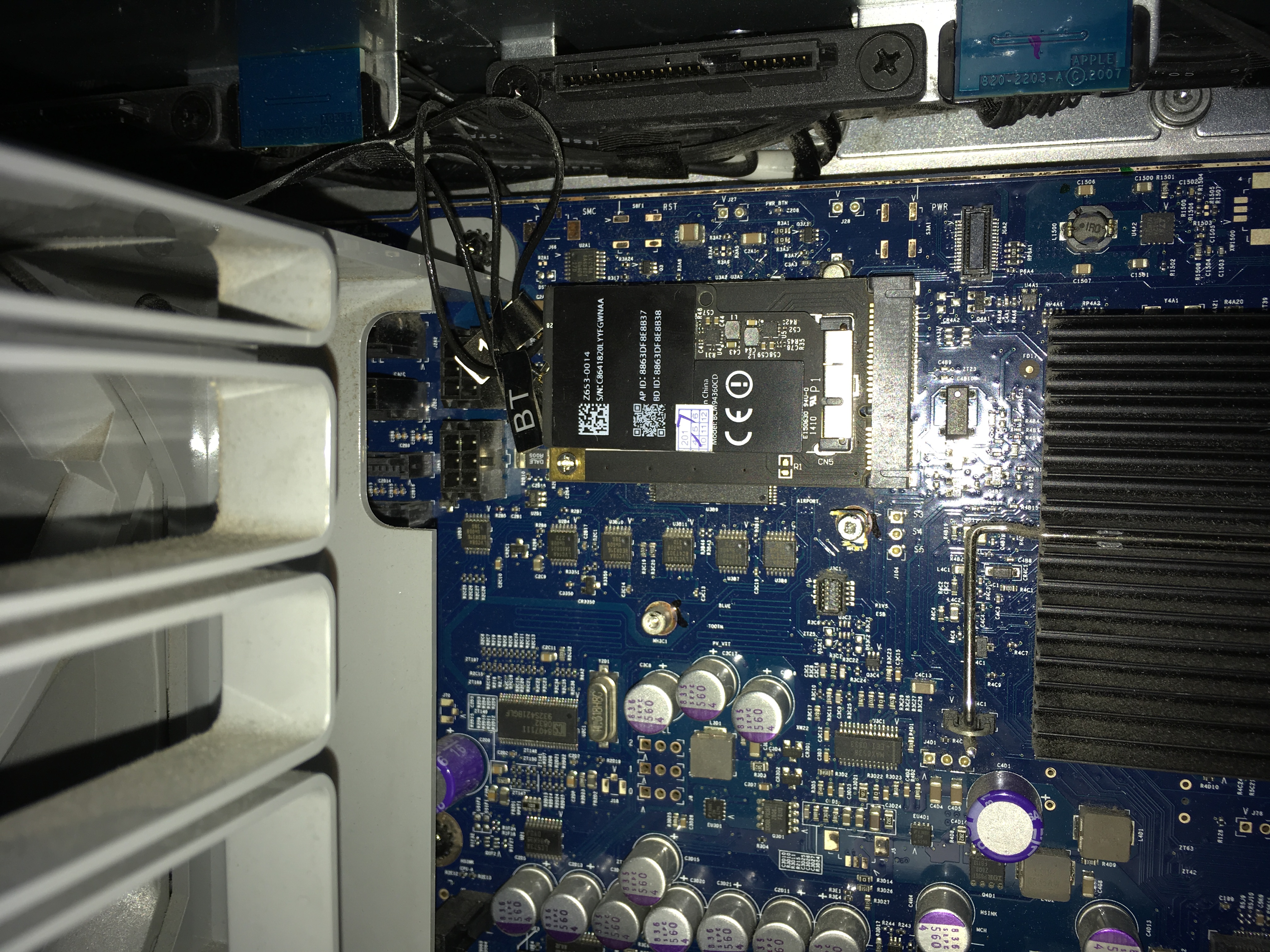

I bought what I thought was the right adapter to install in my Mac Pro 3,1 but it's not being recognized by the computer. Hoping you all can let me know if I got something that should work but is a lemon or if I didn't read the thread closely enough.
It *looks* like it's right. Have you zapped the PRAM and reset the PMU?
PRAM yes, SMC no. Will try that tomorrow. Thanks!
Failing that, seems like I've got a bunk card or adapter? I'm figuring I'll try to return (through ebay, so unlikely, just file a claim on CC) and try again. What's the current, go to link/dealer to get known good stuff?

Reset the SMC and PRAM one more time as well as reseated the card and adapter. Still nothing. Trying to return to the vendor. After waiting a month for it to get to me from China, I'm really dying for wifi!
Vigs - You have a 3,1 and most of this is about 4,1/5,1. If you just want wifi it is easier/cheaper to break down and go with a USB dongle. Also, I thought for BT you needed to tap the USB motherboard connector.
I think only 4,1/5,1 need to tap the logic board USB connector. 3,1 is not required. But not 100% sure.
Yeah, My understanding was a 3,1 doesn't need the USB tap. And regardless, the wifi should work without it, if I understand things correctly. My main concern is that I might have bought the wrong version of the card.
