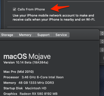

This feature works fine with a BT 4.2 card in a cMP. Just run the terminal command to add the cMP to the whitelist and that's it.
From my Mac Pro's FaceTime preferences:
UPDATE: Sorry, I misread your post. You said "without devices being anywhere nearby".
My bad.
My bad.

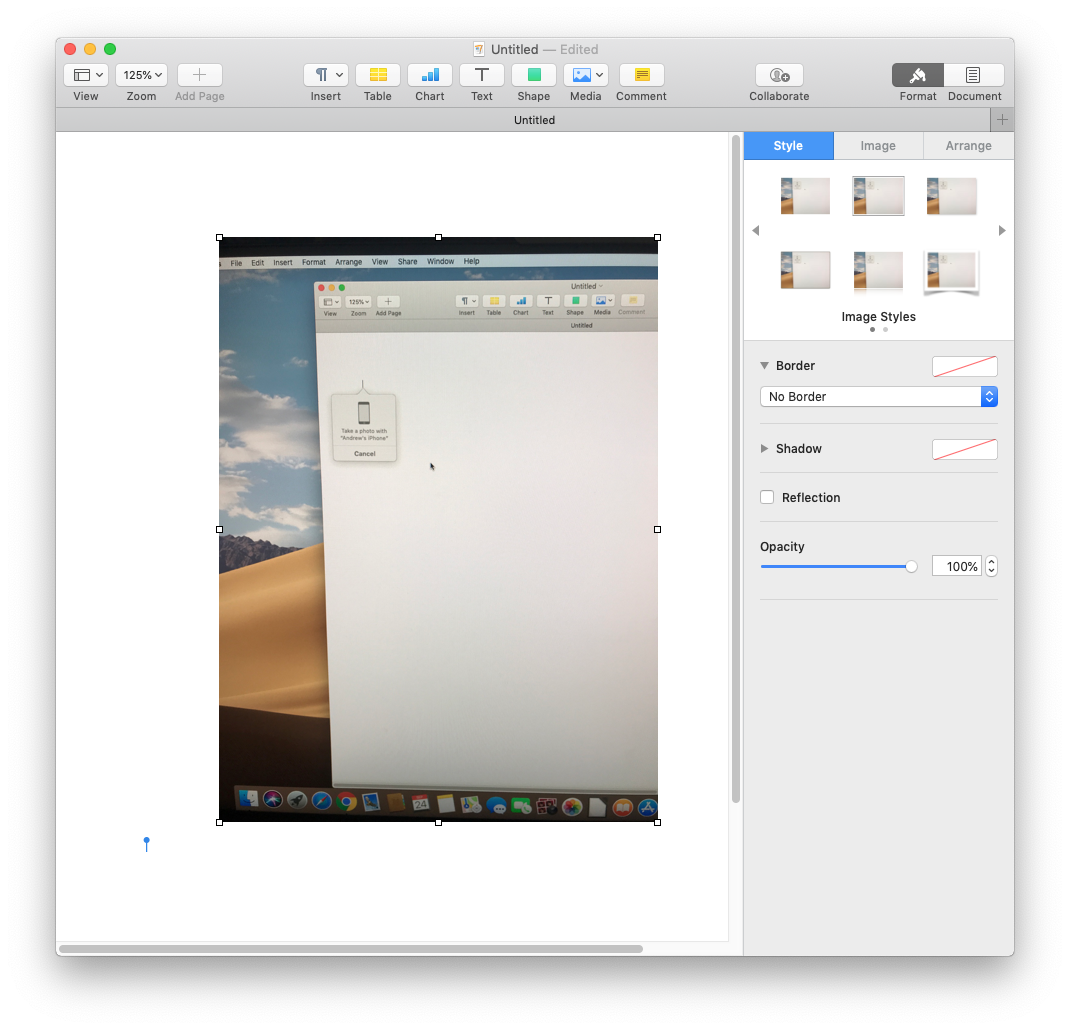

haha, just did the boot to recovery, SIP disable, reboot to normal user account, run command, iCloud Logout, reboot to recovery, SIP enable, reboot to user account, iCloud Login - and within seconds I had the Safari Continuity tab show up on my dock. Happy result.
