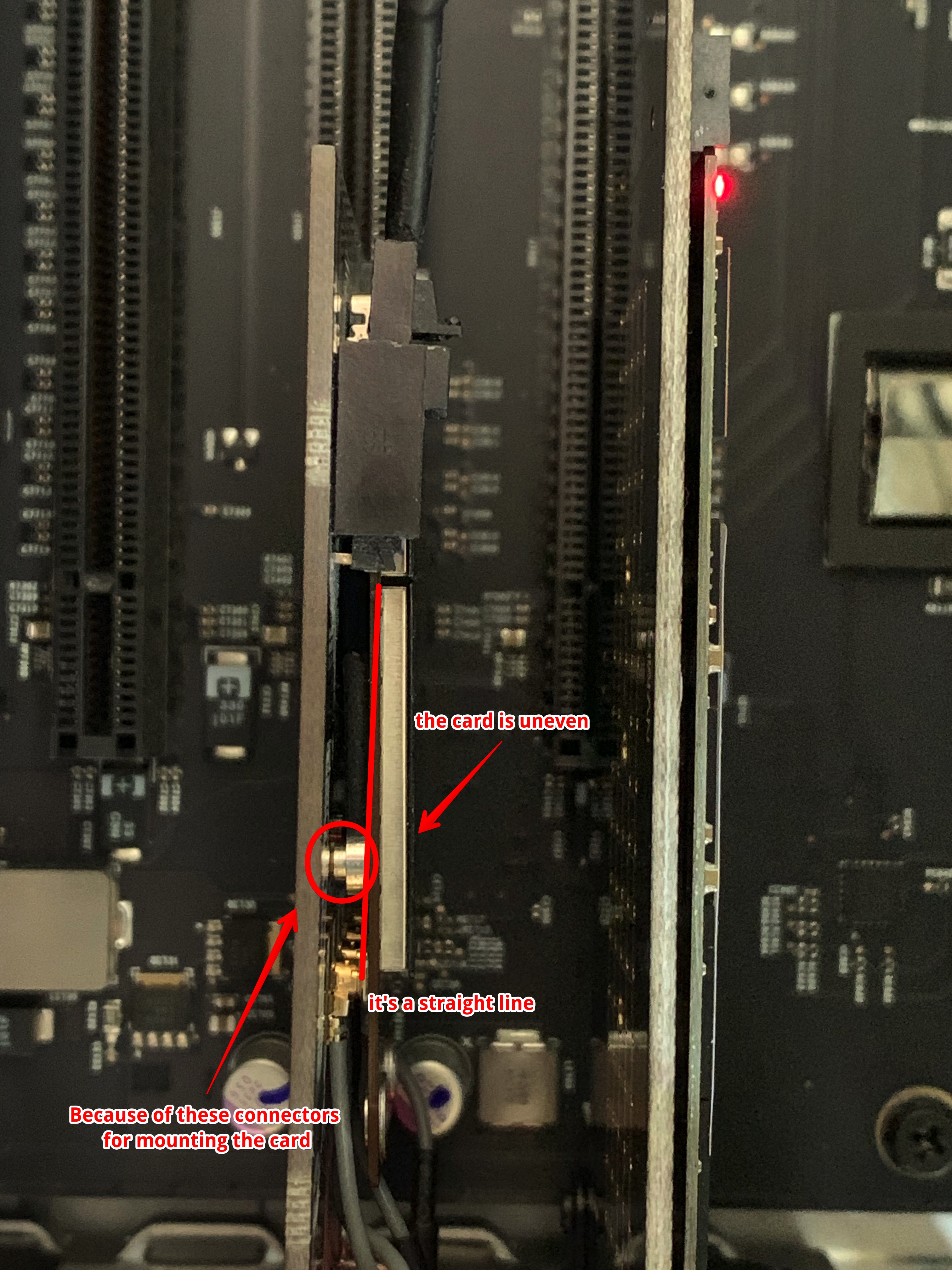

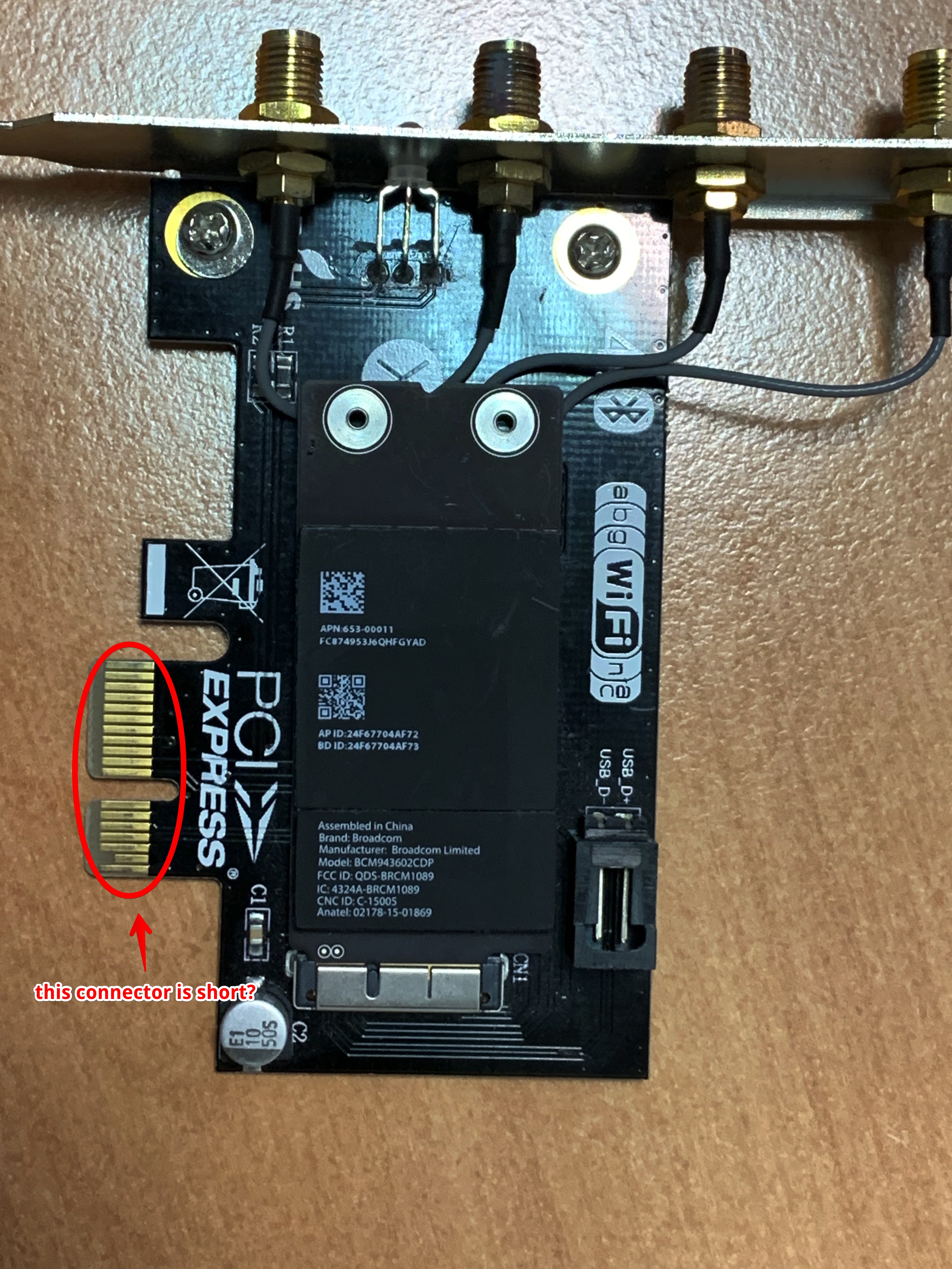

At this point I think it's highly likely that the adapter card is the issue. I'm going to order the internal converter that everybody ordered and see how that goes.
can be the case in the adapter PCIe? its connector is short and maybe it is suitable for a motherboard with windows but not suitable for a mac pro? for example, a connector for an adapter ssd blade is longer.
but someone here is using the adapter in the PCIe slot and everything works for them

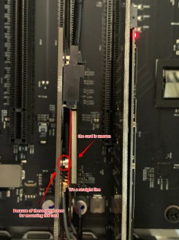

or maybe the problem is that the wifi + bt card is not level in the slot, at an angle
I reseat my wifi card, and I tried in a different mac pro with a different version of os. Same thing, nothing shows up in pci proprieties. I'll let you know if the mini-pcie converter works or not.
let me know. My package with an adapter for mini PCI(to original connector) was lost and it is not clear whether to order again or wait :(

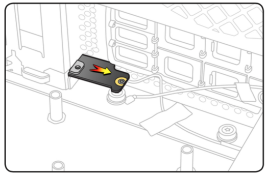

In the cMP, the three WiFi antennas terminate at the bottom of the case, You may have noticed a plastic cover there when looking at the bottom (outside) of the case. Apparently this plastic cover facilitates passing the signal. The case is, after all, a big aluminum cage. The WiFi antennas lay next to each other, so it’s hard to know just by looking at them what affect the connection order has. With experimentation some have gotten a better signal, others not. Other options including getting the cMP out of a corner, off the floor, and rotated until signal improves. Sort of like fiddling rabbit ears on a TV set. I’ve read where some users choose to leave the case open.
The BT antenna is tucked up by the PCIe expansion plates. I’m attaching an image from the tech guide (shows the antenna partially pulled out from its slot). If you examine the outside perimeter of the PCIe expansion area you’ll notice it has a plastic lining. I suppose the designers believed this would allow BT signal to pass through, but commonly it is inadequate.
You can see where creative minds went with this: Sacrifice 1/3 WiFi antenna to act as a BT antenna and see if the overall situation improves. Yes WiFi will probably suffer, but maybe not noticeably, and if BT improves then hooray.
