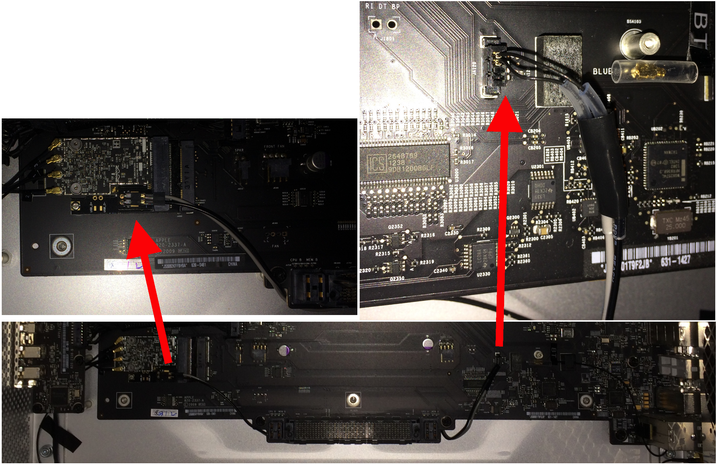

Have you connected data from the original BT location to the new combo card? I'm attaching a photo to show where mine are connected.
Oh man, I'm stupid. I thought a bluetooth capable Airport card would just magically work by itself when connected to an antenna. But yeah, it makes sense to transfer the bluetooth data to the old port to get processed.
Unfortunately my combo card doesn't have a connector for bluetooth. So I bought bluetooth capable card and can only use its wifi ... :confused:
Thanks for the clarification though. I will have to send this thing back again and look somewhere else.
Before returning your components, perhaps post front/back photos of your adapter and your BCM94360CD?
In my rig the BT data connector is on the adapter, and I'm fairly sure this is common. It's possible we just need to show your eyes where to look. If that's the case, then all you need is a cable solution with the proper connectors on each end (which is an interesting part of this massive thread -- several ways to skin the cat!)
The two metal terminals beside R1 are probably D- and D+. Maybe some else can confirm. If so then you just need to solder a wire each to them, and from what I know it doesn’t matter which one goes to the adapter (ie D- to D-,or D- to D+ etc) that plugs into the BT USB port beside where the original BT modules plugs into the MoBo. But don’t take my word for it.
