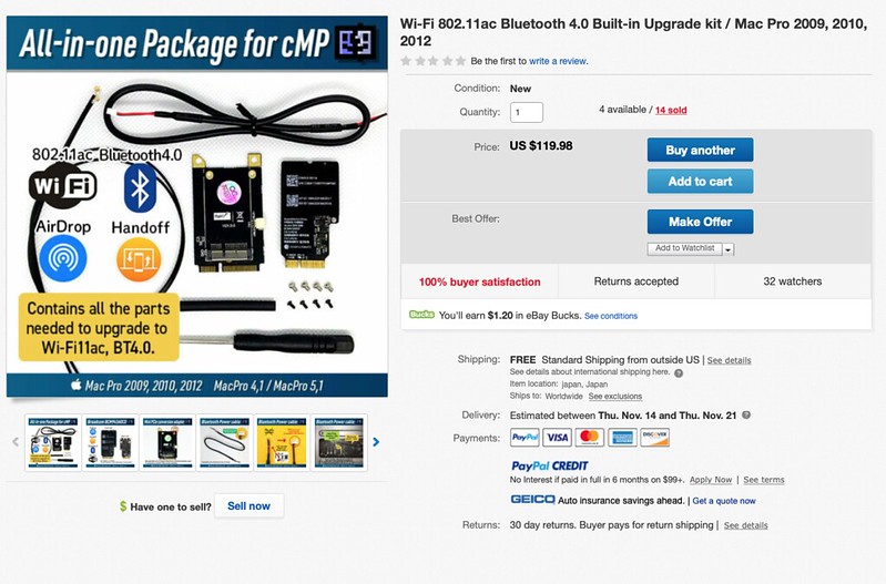

Has anyone used this kit? Its cheaper than the OSXWIFI and offers bluetooth 4.2
https://www.ebay.co.uk/itm/Genuine-...275416?hash=item3d33ee87d8:g:2YUAAOSwI59aOnm9
i have using this kit for over 6 months now, work just very fine , even with Catalina beta too , very happy about it . :D

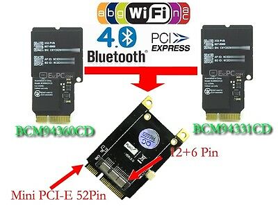

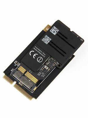

Using this solution on a 4,1, does the wifi card actually sit flush against the adapter? I tried installing a 802.11ac/BT4.2 card into my current adapter, but it bumps against the soldered-on D+/D- plug and sticks out at an angle. It's not clear from the pictures what the whole assembly looks like.
the 802.11ac/BT4.2 card card at my kit sit just tight and no problem with D+/D- plug , it just working fine

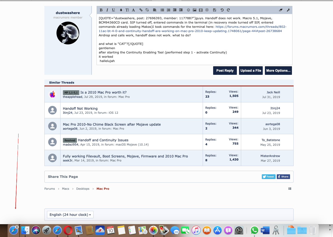

guys. Handoff does not work. Macro 5.1, Mojave,
BCM94360CD card. SIP turned off, entered commands in the terminal (in recovery mode turned off SIP, entered commands already loading Makos)I took commands for the terminal here: https://forums.macrumors.com/thread...0-keep-updating.1748061/page-44#post-26738684
Airdrop and calls work, handoff does not work. what to do?
and what is "CAT"?
gentlemen
after starting the Continuity Enabling Tool (performed step 1 - activate Continuity)
it worked
hallelujah

it has a connector for bluetooth data cable, which is also included. No soldering!

I meant the other end of where the D-/D+ wires go - where it plugs (JST GH 1.25mm 4-pin) into the same USB port that the factory BT card plugs into the backplane.
But you are right about the mini PCIe adapter end - that’s actually a JST SH 1.00mm 2-pin connector.

This one don’t have the USB data connector needed for BT working, MP5,1 don’t have USB signals at the AirPort mini-PCIe connector.
I don't understand what you're saying, maybe I need to do other researches...
BCM94360CD needs PCIe signals for the Wi-Fi part and USB2.0 for the BT4.0 one. MP5,1 don’t have USB2.0 in the AirPortExtreme connector, that’s why you need an adaptor with the USB connector and the cable to connect to the original BT connector.
The combo that you found will work only for Wi-Fi.
