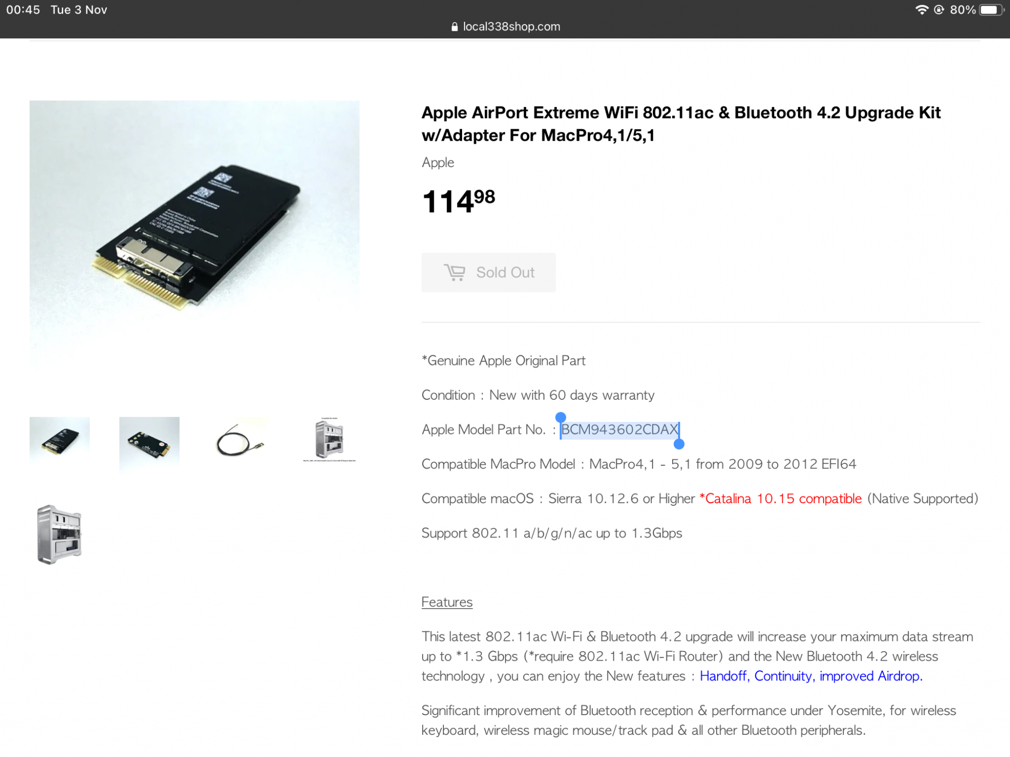

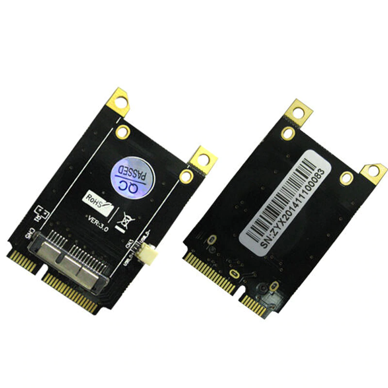

Hi,
I bought this adapter because it looks like the one being used on a handoff/continuity upgrade youtube video.
My question is, does this one works with the Broadcom BCM943602CDP card, even with the usb pins on the other side?
Also, the one that arrived is labeled version 4

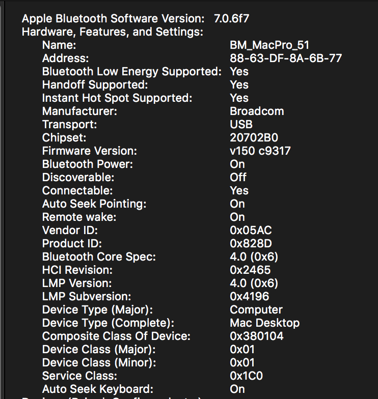

Thank you for explaining with the terminal code. I have just updated my WIFI / Bluetooth, wifi is working , Bluetooth connection is also working. But even though I tried these commands and CAT tools Continuity, handoff is not working.
System details shows handoff yes,etc.
But When I use I pad in close range, hand off not working.
CAT tool is reporting wrong board ID, with not 12 or 20 digit characters ?
Any suggestion ?
I suspect I need to re-arrange Bluetooth wiring to improve signal strength maybe ?
And I saw you have Imac 15,1 Board ID in the command, I was using ImacPro1,1 as Mac-7BA5B2D9E42DDD94 .

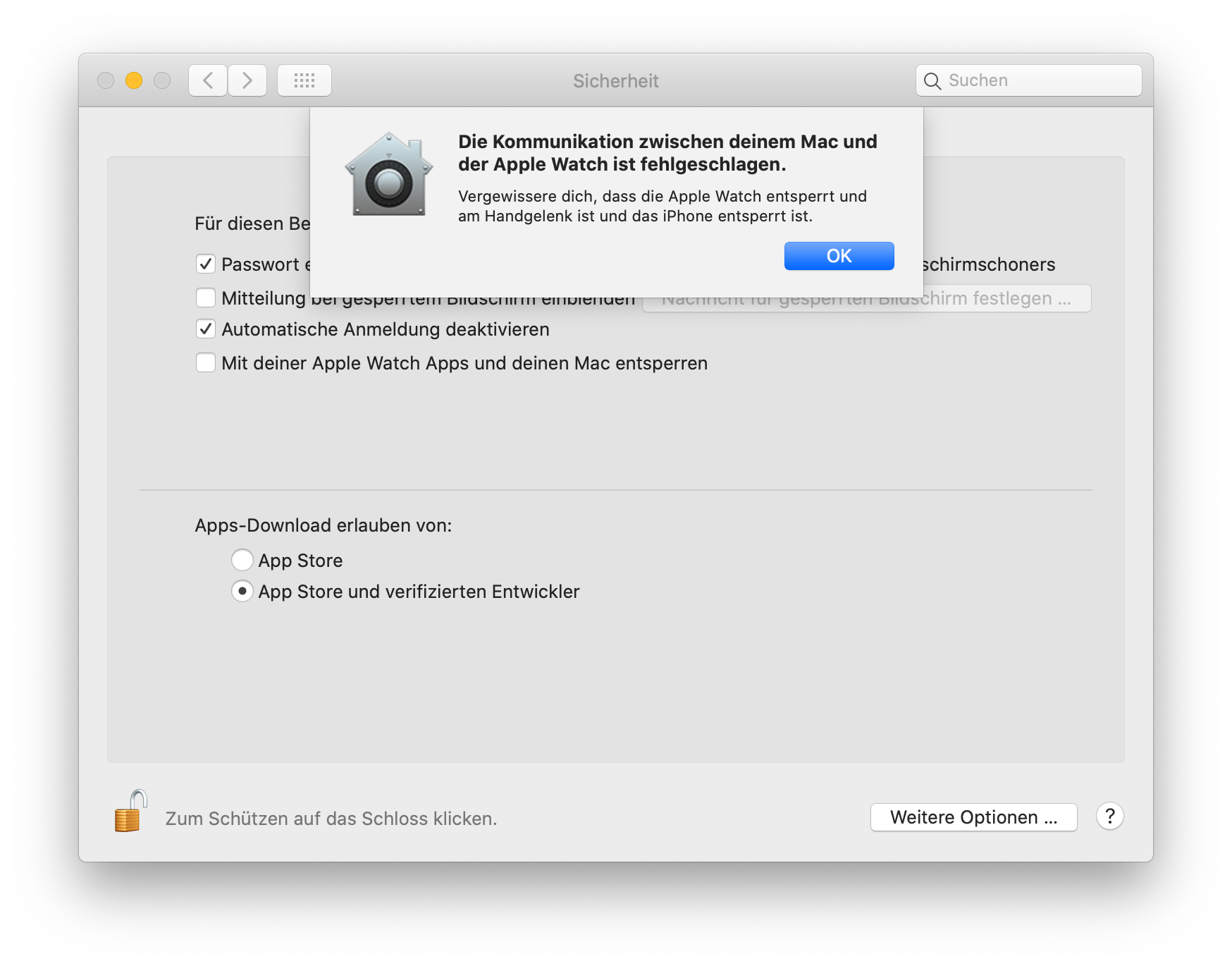

The setting was deactivated and couldn´t be activated again.
Again, i did some basic troubleshooting and helped in the past.
Unlink my iCloud account from macOS, reboot, try to login again, error message, defaults delete MobileMeAccounts, reboot and login again!
Nope, still no "Unlock with Watch" possible.

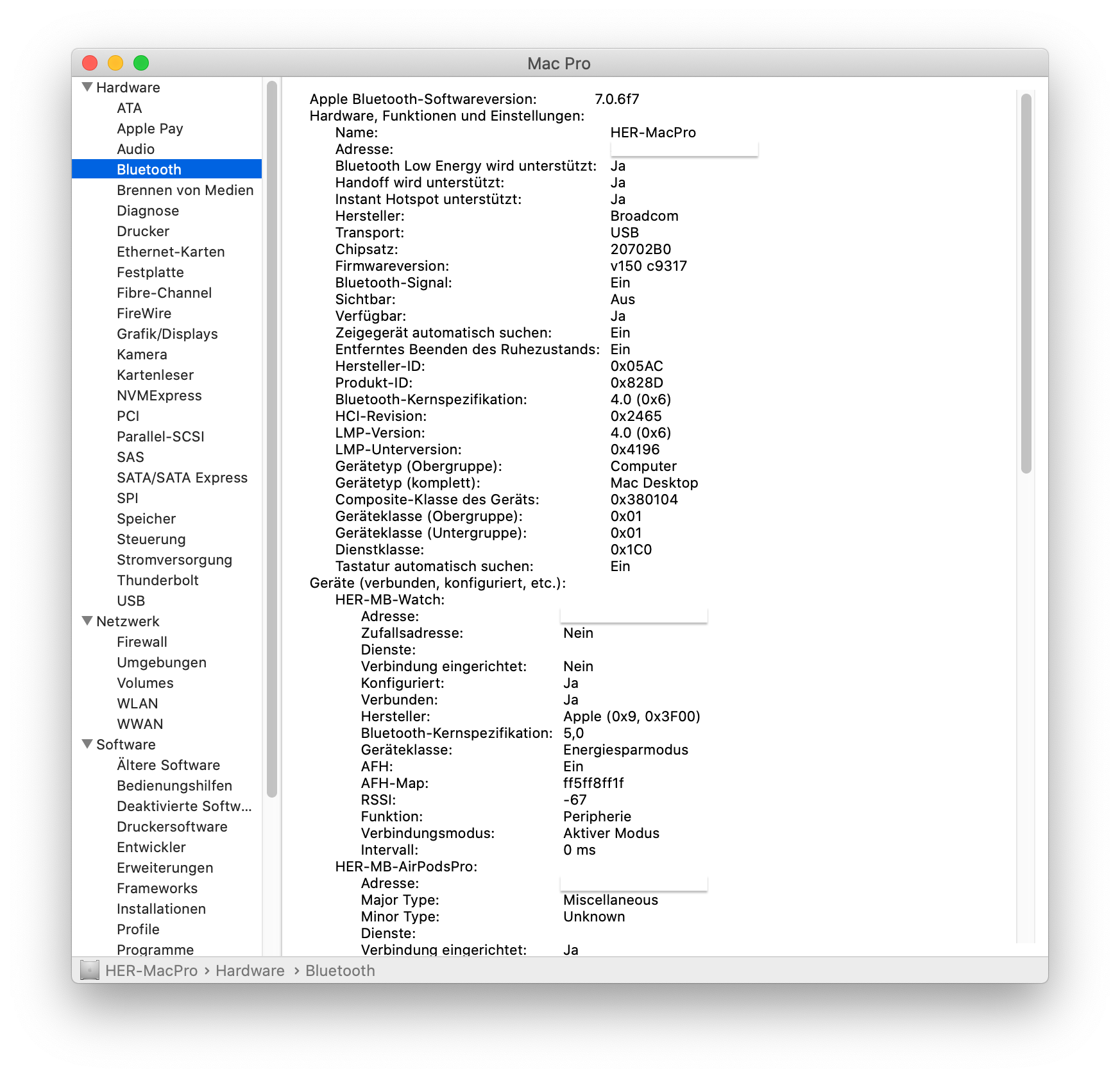

Checking my System Info > Bluetooth and Handoff is still enabled.

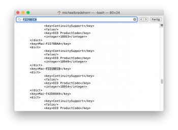

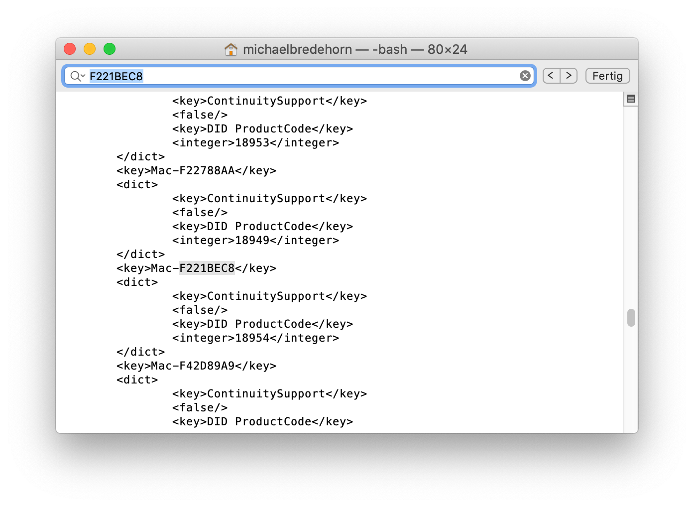

Then i checked the /System/Library/Frameworks/IOBluetooth.framework/Versions/A/Resources/SystemParameters.plist entry for Mac-F221BEC8 and found the ContinuitySupport shows false.
Reboot to Recovery, disable SIP, reboot, use PlistBuddy to change the ContinuitySupport entry to true, reboot to Recovery, enable SIP, reboot again and check the outcome.
sudo /usr/libexec/PlistBuddy -c "Set:Mac-F221BEC8:ContinuitySupport true" "/System/Library/Frameworks/IOBluetooth.framework/Versions/A/Resources/SystemParameters.plist"
cat /System/Library/Frameworks/IOBluetooth.framework/Versions/A/Resources/SystemParameters.plist
Guess what? It´s still false
Code:
<key>Mac-F221BEC8</key>
    <dict>
        <key>ContinuitySupport</key>
        <false/>
        <key>DID ProductCode</key>
        <integer>18954</integer>
    </dict>

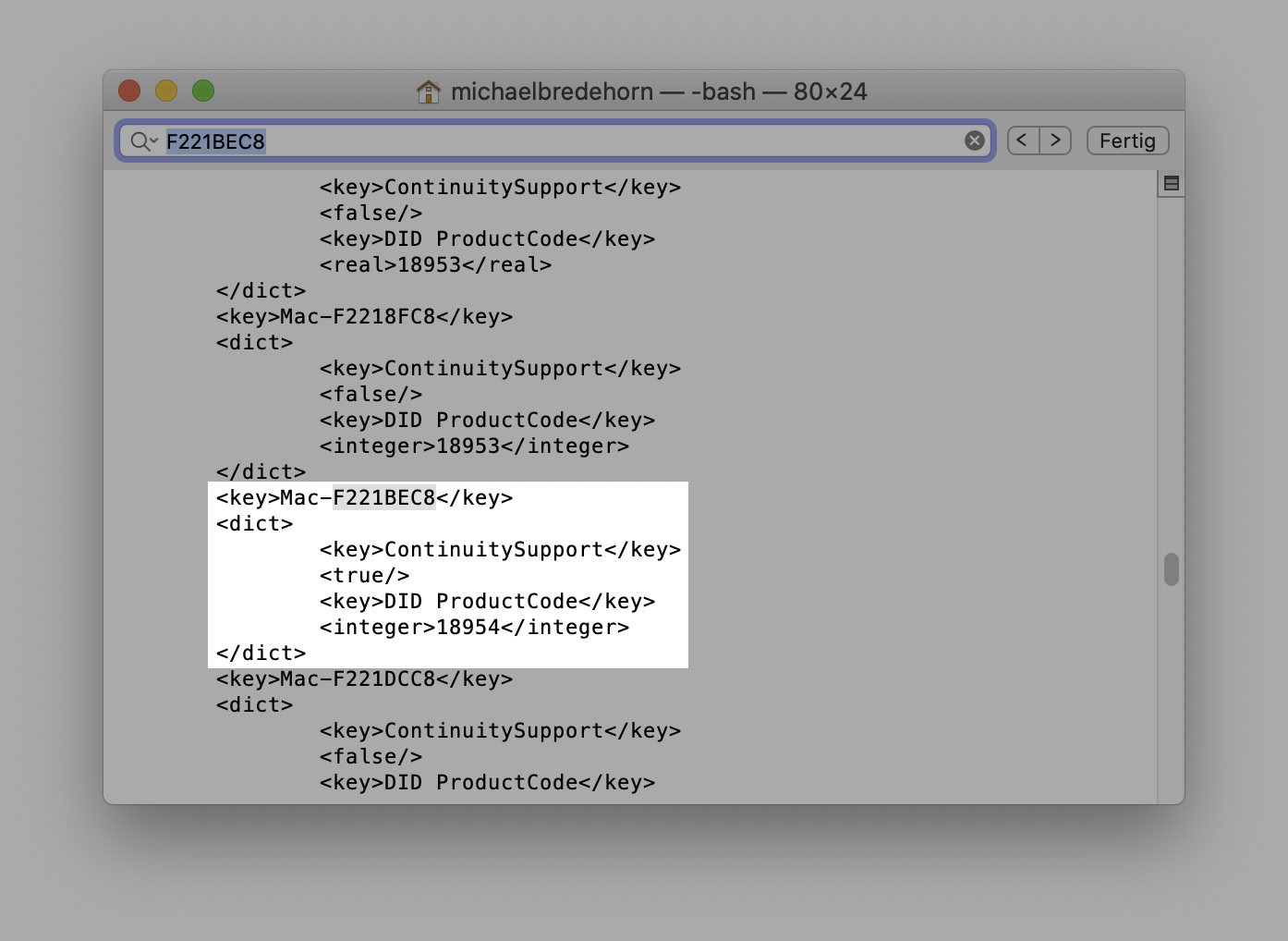

Already did but i hadn´t edited my post, sorry.
ContinuitySupport is now true and it´s not working.
cat /System/Library/Frameworks/IOBluetooth.framework/Versions/A/Resources/SystemParameters.plist will show:
I also tried this workaround and it´s not working.
Guess i´m out of luck this time...

I finally managed to get it working.
1. Delete keychain entries and files in the AutoUnlock folder
2. Try to activate unlock with watch -> directly shows an error without any delay
3. Shutting down my iPhone
4. Try to activate unlock with watch -> directly activated without any delay
kind regards
Michael

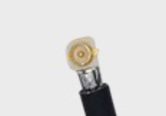

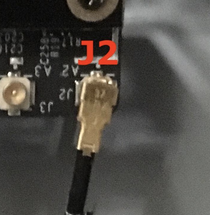

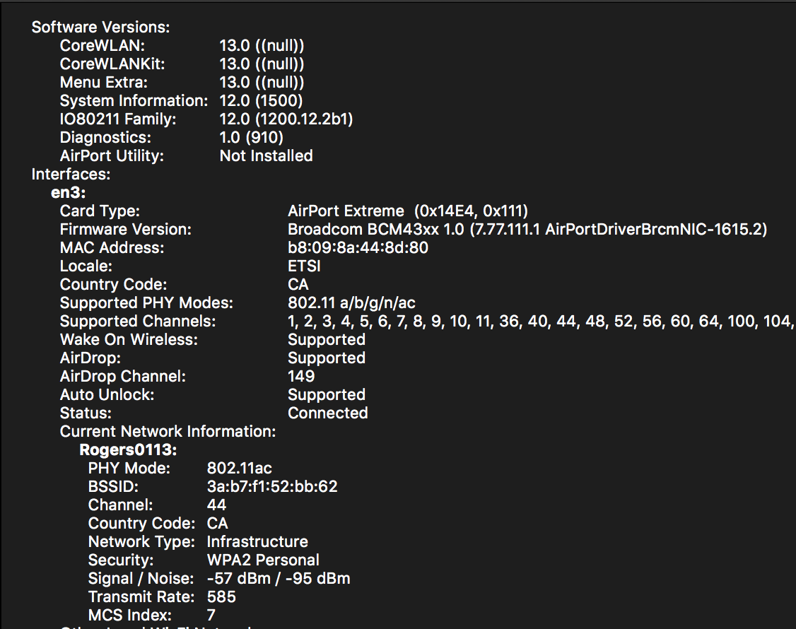

Hello as recent convert to the Hackintosh, I wish to share my observation regarding my WiFi - Bluetooth conversion on my MacPro 5,1. The Mac running Catalina (opencore 6.2) WiFi AC and BT with all the features running great.
I purchased my BCM94360CD Card, Adapter and Antenna from Amazon.com, good price value for sure
My only challenge, beside trying to get the gold antenna plugs seated (%&^%&), was related to the pin config for the Bluetooth power.
The newer style adapters don't require soldering to attach the power wire to the adapter. BUT, you will need to unplug the old BT Extreme card, cut the cable and solder the new power wire extension to the old connector. Then plug this into the motherboard to power the new BT card. The connector is very small and I couldn't find any clear directions on the polarity. The original BT card had 4 pins connected, 2 are NOT necessary. So from top of the mac:
Pin 1 = D- (Black Wire)
Pin 2 = D+ (Red Wire)
Pin 3 = X
Pin 4 = X
Hope this helps. Thanks to all for sharing and caring.

So what should be the code to enter if the mac is a mac pro 4.1-->5.1?!?
I have issue with Continuity as well... I purchaseda 115 USD card that should allow me to use Continuity but I can't atm.
Thank you
Thank you
The key is the motherboard. What is your Model Identifier when you run the system report. Mine is "iMac12,2" (notice no space in there - that is important). Tell me what that is for you and I can see if I can help you find the right piece of info to plug into that code.
Mine is MacPro5,1 but keep in mind that is a cmp early 2009 (so 4,1-->5,1)
Thank you
PS: if needed I can send system information's screenshots
Thank you
This is what the code is for that machine which is a Mac Pro (Mid 2012). The code you should use is: Mac-F221BEC8
I looked up the code for each 4,1 and 5,1 and it is apparently the same motherboard so the code above is for both. Insert that into that command and see if it works, that's what did the trick for me.
This file is the whitelist for what machines can do it and what ones can't. Once you tell it that your machine can do it in this file and you have the board installed, you should be golden.

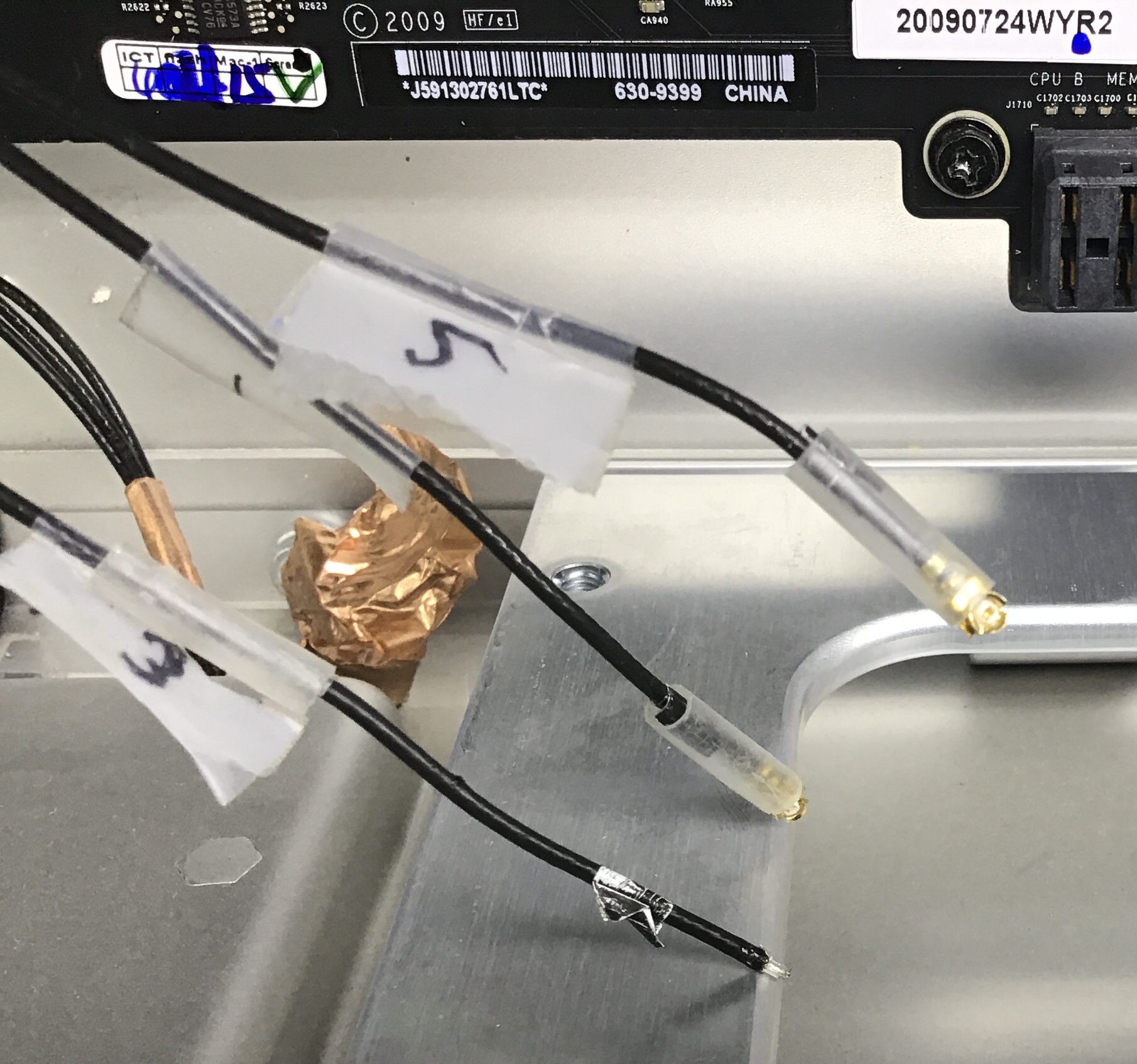

Anyone know what these little gold crimped antenna connector plugs are called and if they are available to buy?
On antenna wire 3 the plug somehow got crushed and wouldn‘t connect to the wifi card and it’s come off the wire, so need to solder/crimp a new one on.

I got one of these BCM943602CDAX Apple AirPort Extreme WiFi 802.11ac & Bluetooth 4.2 Upgrade Kit w/Adapter For MacPro4,1/5,1
since one of the internal antenna wires in the Mac Pro has a destroyed end connector is there a PCIe adapter to plug this BCM943602CDAX NGFF into, the adapter must have 3-4 antennas with wires to connect to the BCM943602CDAX antenna connectors and screw into the PCIe plate.
